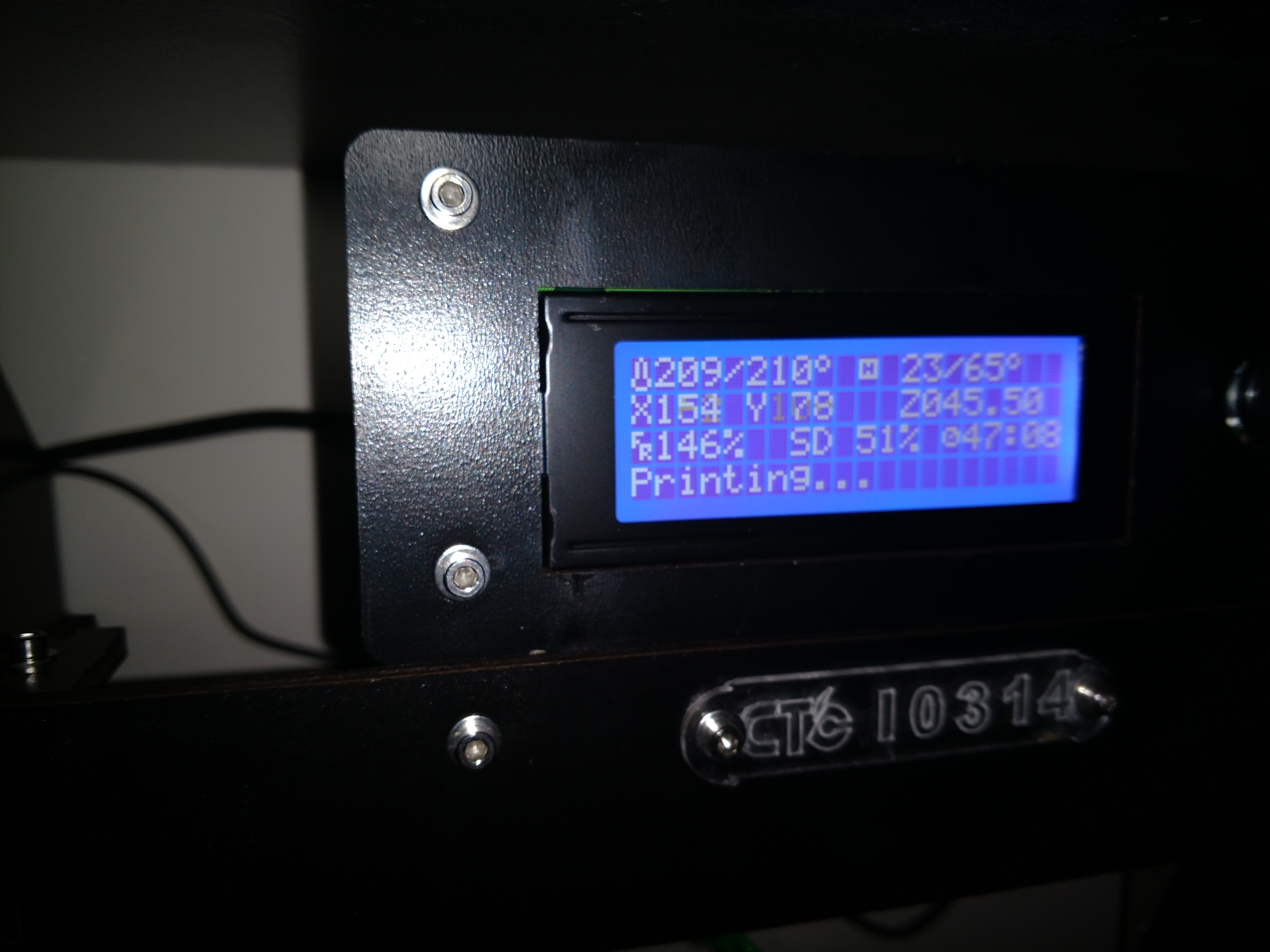

So I'm 47 hours into my print and I notice this...
So I’m 47 hours into my print and I notice this… My build plate is at only 23c… This is room temperature. My question is, do you guys thing the heating element just died or is it possible that the print itself is working as a heatsink and cooling everything down? This temp makes me very nervous because below 35c parts start popping off of the build plate. Since I’m 47 hours into this print there’s no way I’m going to stop it. I’ll have to test it after it’s done I guess. I even used an IR temp gun and verified that it’s cold. I’m really worried that the part’s just going to pop off mid print and ruin the whole thing… Oh great… Down to 22c…
Could it be the gcode telling the printer to turn the plate off? I’ve had that happen before where I forget to punch that setting into slic3r
@Jacob_Bridenbecker_W the photo shows the gcode target is 65C.
@Kevin_Danger_Powers I’d say broken wire or similar electronics issue.
@Ryan_Carlyle That’s what I’m thinking too… Now I’m probably going to have to figure out how the hell to fix that…
@Jacob_Bridenbecker_W It shouldn’t be the gcode because it’s programmed to run at 80c (the temp sensor is off) until the first layer is done and then it’s suppose to drop down to 65c. I do this so that it sticks to the plate well but then it cools down so the new hot plastic coming out cools faster.

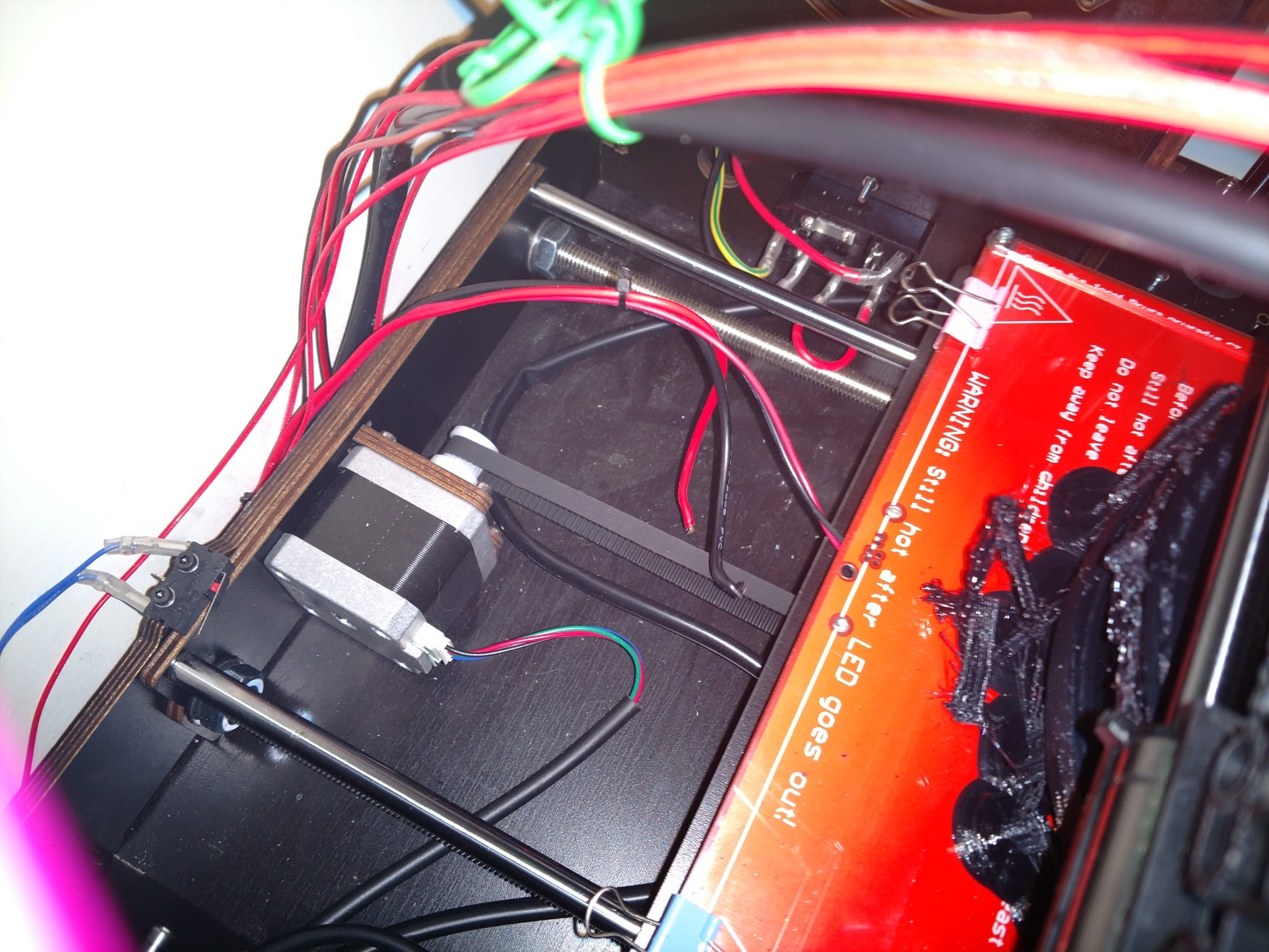

Ok so I just did a little poking around and found out that BOTH wires from the heated bed broke off… -.- that’s annoying. I can’t really see back there but I’m guessing I can just solder them back on. The part I’m most annoyed about is the fact that now I’m going to have to relevel my bed. God that is a pain in the ass. Lol. But I have a much better understanding of how to do it now so it shouldn’t be too bad.

@Kevin_Danger_Powers fatigue failure. Solder breaks if you repeatedly put it under stress. You need some kind of strain relief to get the bending away from the solder joint. And upgrade to flex rated wiring.
This is why I hate i3 type printers… big, high-current wiring in a flex cycle application? It’s a recipe for failure and has a pretty good chance of causing a fire.
