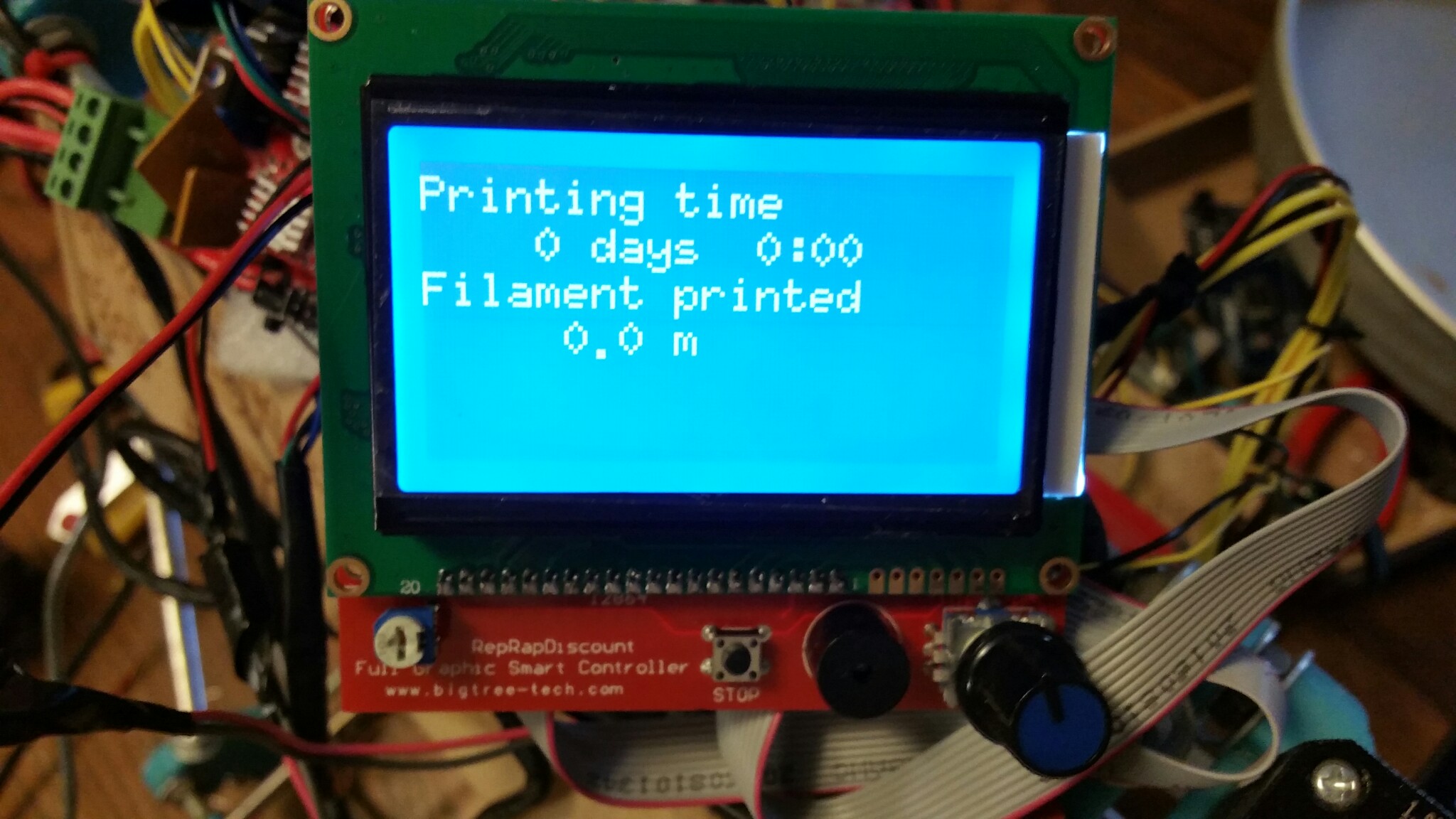

Also, any idea why the LCD would show this?
I have option 11 set.
I turn the dial and it goes to this and works. So just odd

As for the lcd, it depends on what version of Marlin you’re running. I know some older versions had issues. The latest RC should be working, i think it’s RC8.
