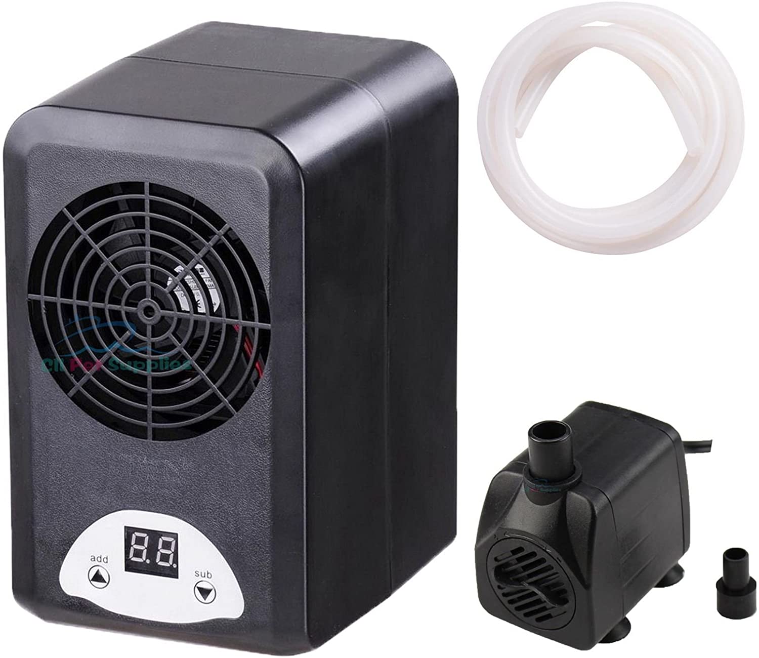

So I’m battleling with my water temp. Currently without cooling I am at 31c. After throwing some of those plastic containers for cooling into my 5gal bucket and Turing on the AC I can go down to 23C. I’m still not happy and my cuts are still far away from effective. So I’m on a quest to find a solution and though about water chiller bellow ( not my image). Anyone has some input on how would this work?
I got a cheap - 89 buck aquarium chiller on ebay - works good, pump from tank flows through the chiller then the tube - then back to tank - keeps temp at about 15 degrees C.

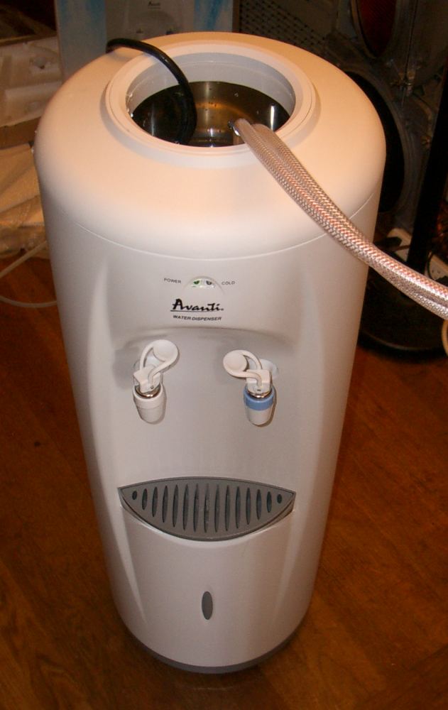

But yeah that’s cool to convert a water fountain ! Maybe you can add a beer cooling option

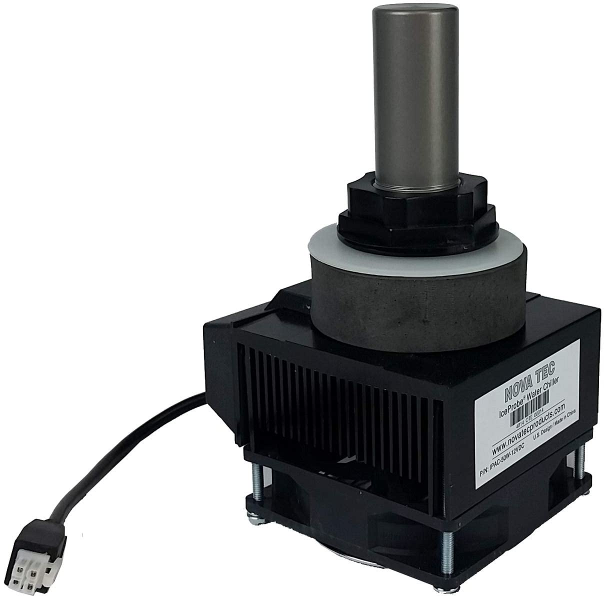

I have been wondering about this unit:
@donkjr from the reviews it seems that it does not lower from ambient that much. Then again the above solution im not sure either

@Ariel_Yahni_UniKpty This is the review made me wonder about our application.
“It says 10 gal can get 6-8 degree cooling. I am using it in a 5 gal that is only about 3/4 full and non insulated with a high intensity light. The normal temp of the tank is a blazing 90F. With the cooler it gets to 77F and at night with the light off it gets to 72F.”
@donkjr that a good review and in par with my temps but im looking to go bellow 68 and see if my cut get better

Be carefull buying this type of cooler ,going by the wattage it uses 72 watts is do not sound like it is refridigerated sounds more like cheap 12 volt car fridige only works by plizer cooling so will only drop temp by 10-15 deg .i use a second hand under sink refridigerated cooler that uses 400 watts.and will drop my 11 liter water temp even after 3hour of cutting down to 10 deg.must get around to hooking up my temp controler to it ,i have a lasef beam power meter and have tested the power of the beam at diffrent temps and can tell you going from 40 watts at 15 degress to 20deg the laser beam power drops 8 watts

Those type of coolers use a peltier effect chip and are very low btu. Not even close to keeping up with a laser over a long run. They work fine in the water dispenser because they have forever to bring down a small tank of water to drinking temp, but the small chilled volume of water won’t help your cause much.
You’ll increase the water mass a little, and draw off a little heat, slowing the rate at which the temp climbs, but climb it will.

Peltier Chips just can’t do the job for the size of a K40. And they’re so incredibly ineffecient that if you racked up enough to do the job, they would require several hundred amps of 12v power and need their own cooling device (they convert all that power to heat and add it to the heat transferred)
