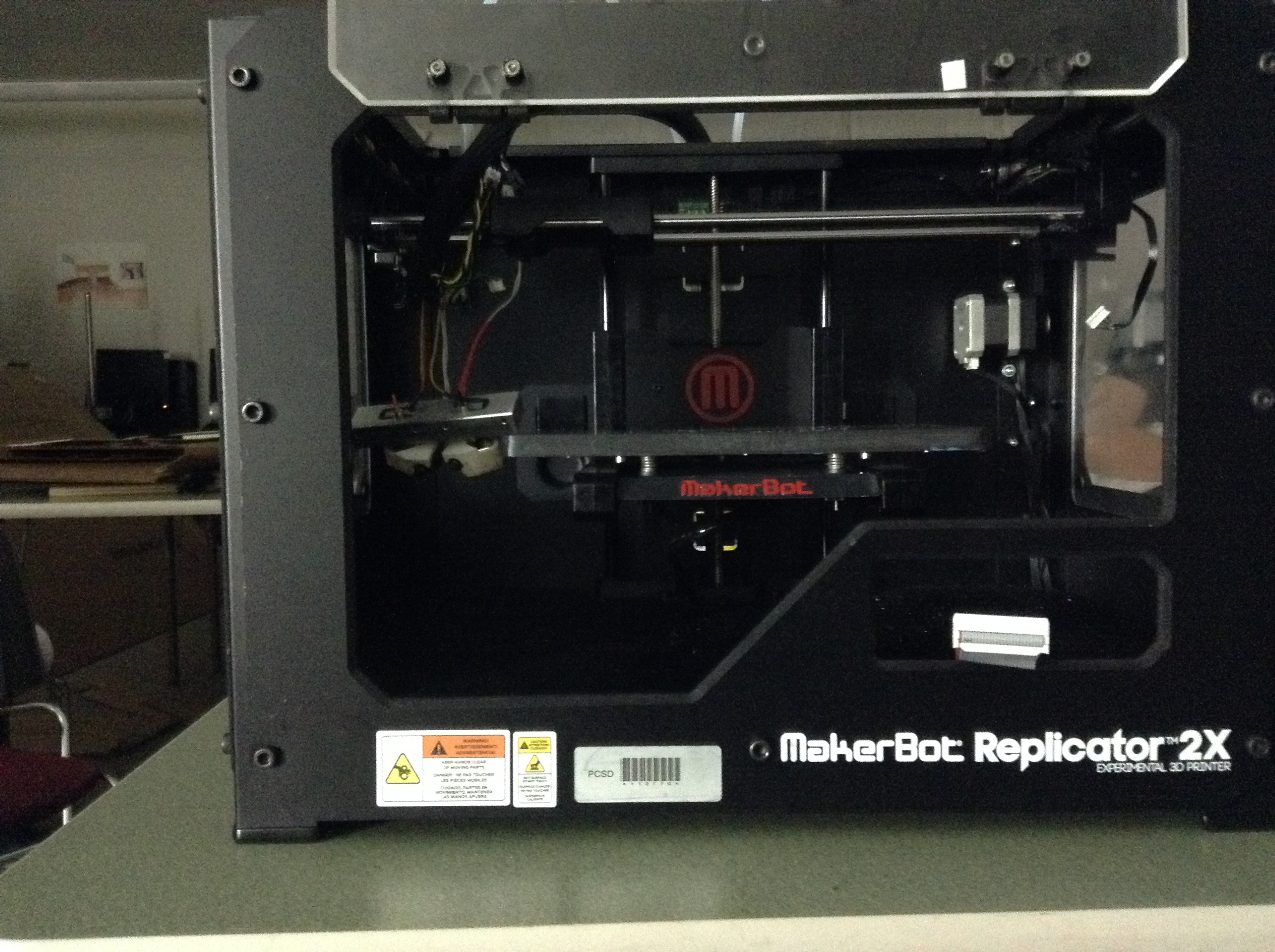

So I'm currently working on fixing a Makerbot Replicator 2x.
So I’m currently working on fixing a Makerbot Replicator 2x. My current issue (along with many others I assume) is that when I turn the printer on, the LCD flashes on and off about three times per second, emitting a tone each time it turns back on. We’ve tried removing the SD, and I’m not able to access the help forums due to web filtering at my school. Has anyone had this issue before and if so it would be awesome if you could share your experience.
Thank you so much in advance!

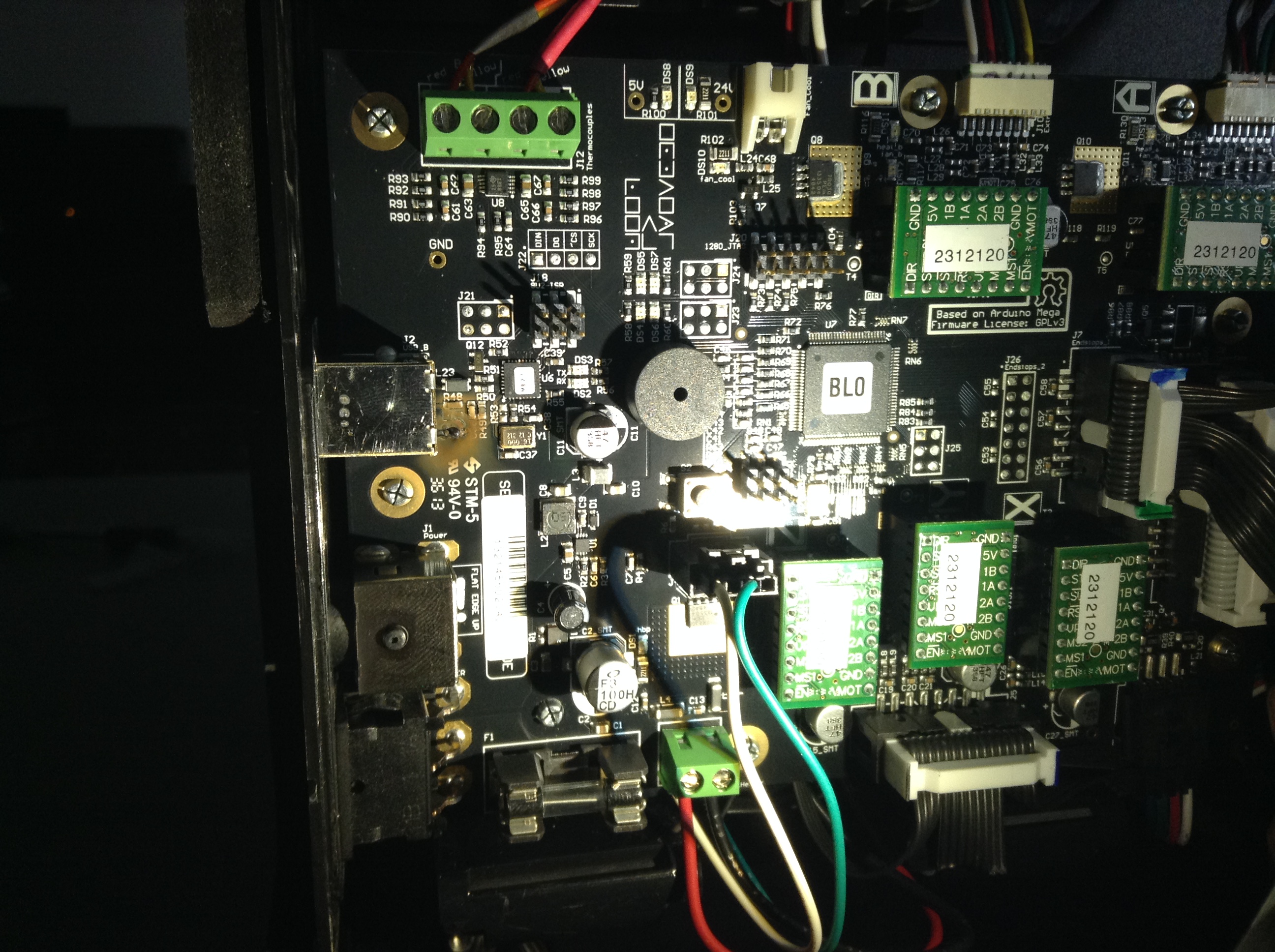

Thanks to everyone that replied, and I’ve identified the issue. We removed the main board cover and found a blown capacitor on the board. We’ll have to get it fixed sometime. Thank you all again for the knowledge and tips, and I will keep your suggestions in mind for future projects!
@Spyder_Willster That’s a blown inductor (L22) according to other board photos I’m looking at. I don’t have any idea how that blew. I’m wondering if the board took a surge through the USB cable. If so, your 8U2 chip (U6 on the silkscreen, used for USB and firmware updates) might be sending reboot commands to the MCU. Could mean the 8U2 is also fried.
