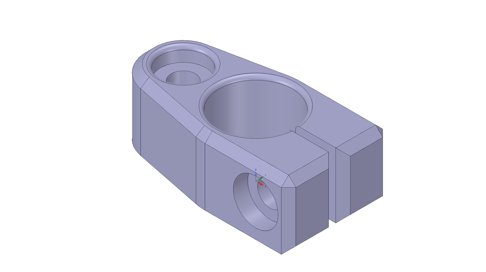

So, I’m fed up with my extruder and so I thought I’d give @Eclsnowman 's HurcuStruder a go. I’m a little wary of threading the main Teflon tube into a nut, so I wanted to find a way to use the push-lock solution that came with my e3d v6s. Eric’s design is really nice and allows you to easily change the attachment method. So, I quickly CAD-ed up a new attachment piece. Thought others might like to try this option, so I uploaded it here: here: https://www.dropbox.com/sh/0rifioj0v93qr86/AABfBk4VqVJRDbmDhZz_0M8Ca?dl=0
