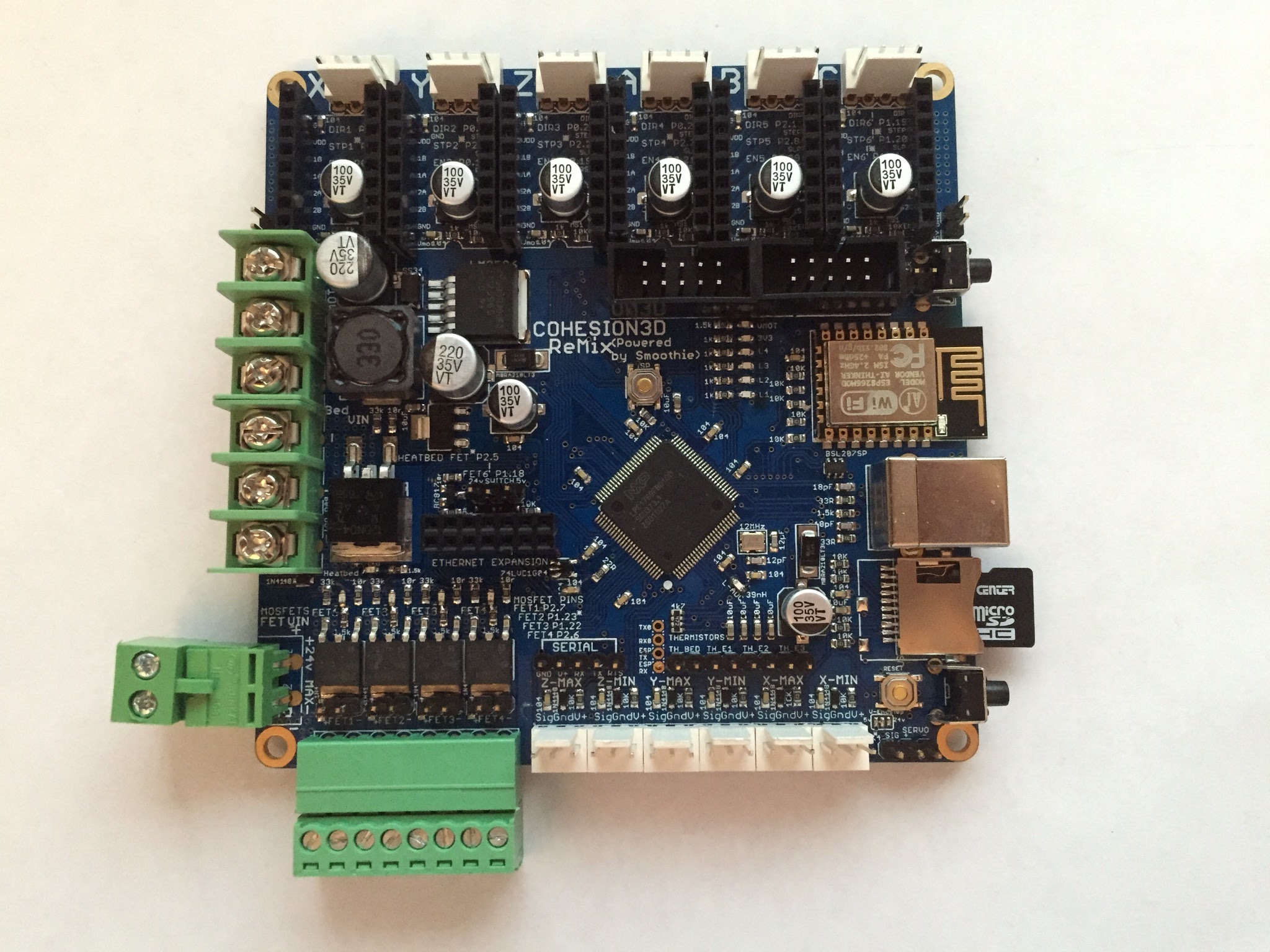

I definitely support smoothie. I make another board that runs smoothie called the Cohesion3D ReMix and it has space for 6 drivers and other powerful features such as a 20 amp heated bed mosfet, direct connections for a Graphic LCD, and wifi! (experimental)
The factory is making a batch for me right now so if you can wait a few weeks, we should have it available.
And maybe you’ll be the first to do triple extrusion on the HercuLien…
The size is 100x100mm so it’s smaller than a smoothieboard. In not sure what the size of the GT is.

Quick update for @Luis_Pacheco and everyone else: we’ve been working extremely hard to get to this point and the C3D Remix will be available for sale this week in time for the holiday! Thank you all for your patience and I’m looking forward to getting them into as many hands as possible to see what you all can do with them.
Here’s one sneak peak:
@Luis_Pacheco the ReMix is available for order now at http://cohesion3d.com. The Mini is available for pre-order now too, Eric has been testing for me on his delta and I will defer to him for some feedback yet.
