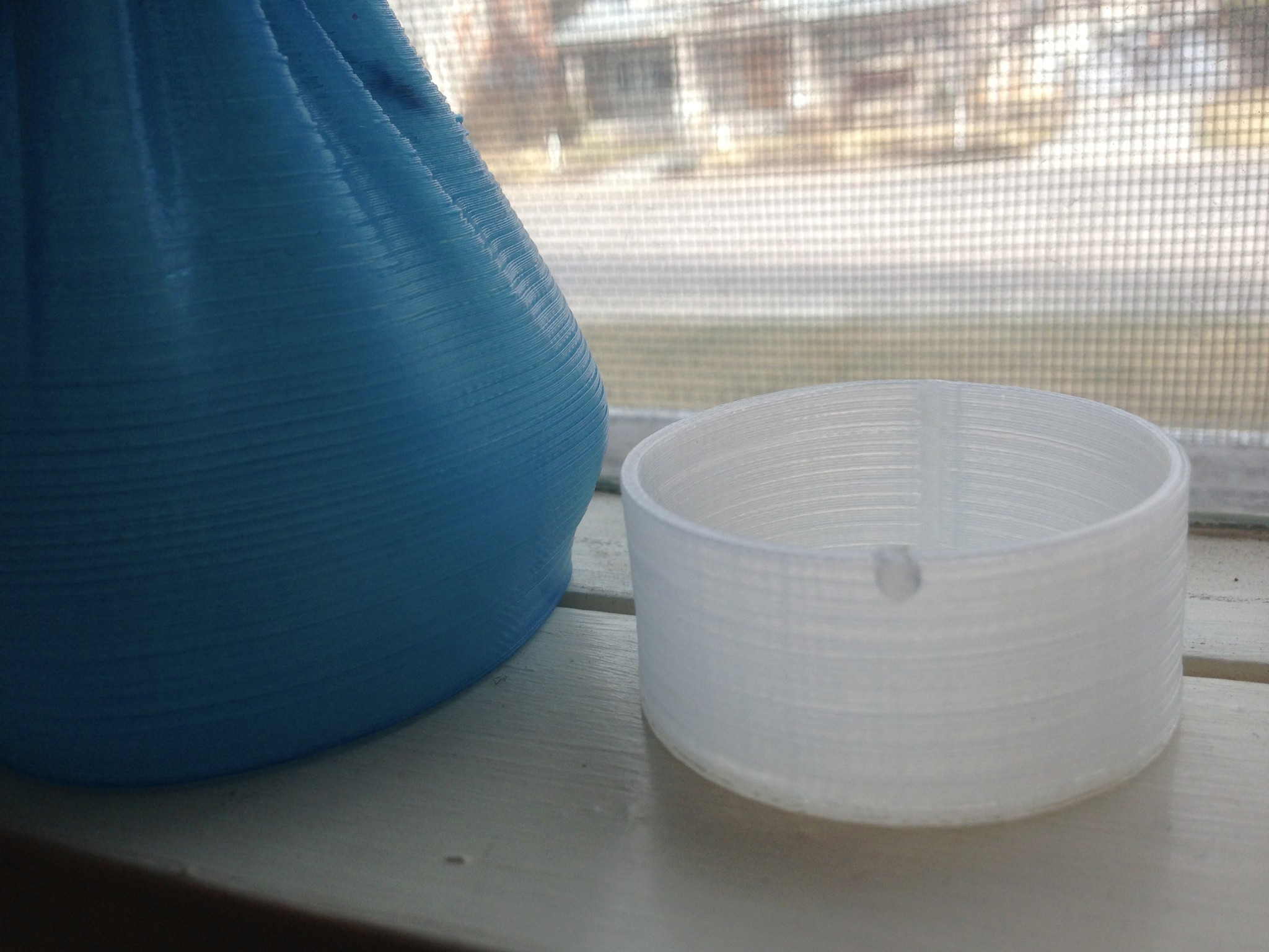

So I’m relatively old-hand at this three-dimensional printing mumbo jumbo, but this issue has me totally stumped. Seems like it’s been happening ever since I replaced a burned out RAMPS 1.4 board, though that may be coincidence. I’ve recalibrated all my estep values, swapped around a couple pololus, tweaked voltages with the pots, tried a wide range of temperatures and layer heights. Tried different filament, different slicers, even a different hot end.
It seems like at random intervals I just get a poorly extruded layer. Could my extruder stepper be dying? I have no idea what the symptoms of that would be. Any ideas?
Hard to make anything out in those pictures. I’d need some macro shots. What you’re talking about sounds like filament slipping on the drive gear, but I have a different hypothesis. How are you feeding filament into the machine? If there’s resistance on your spool, it could be pulling the extruder up a bit when it goes taught and printing a bit too high above the previous layer.

I have read your article, Rich, it’s excellent. Unfortunately relieving tension from the spool doesn’t seem to make any difference. I have consistent measurements of extrusion length, so I don’t think it’s filament slippage either.
I guess I need to buy a macro lens.
