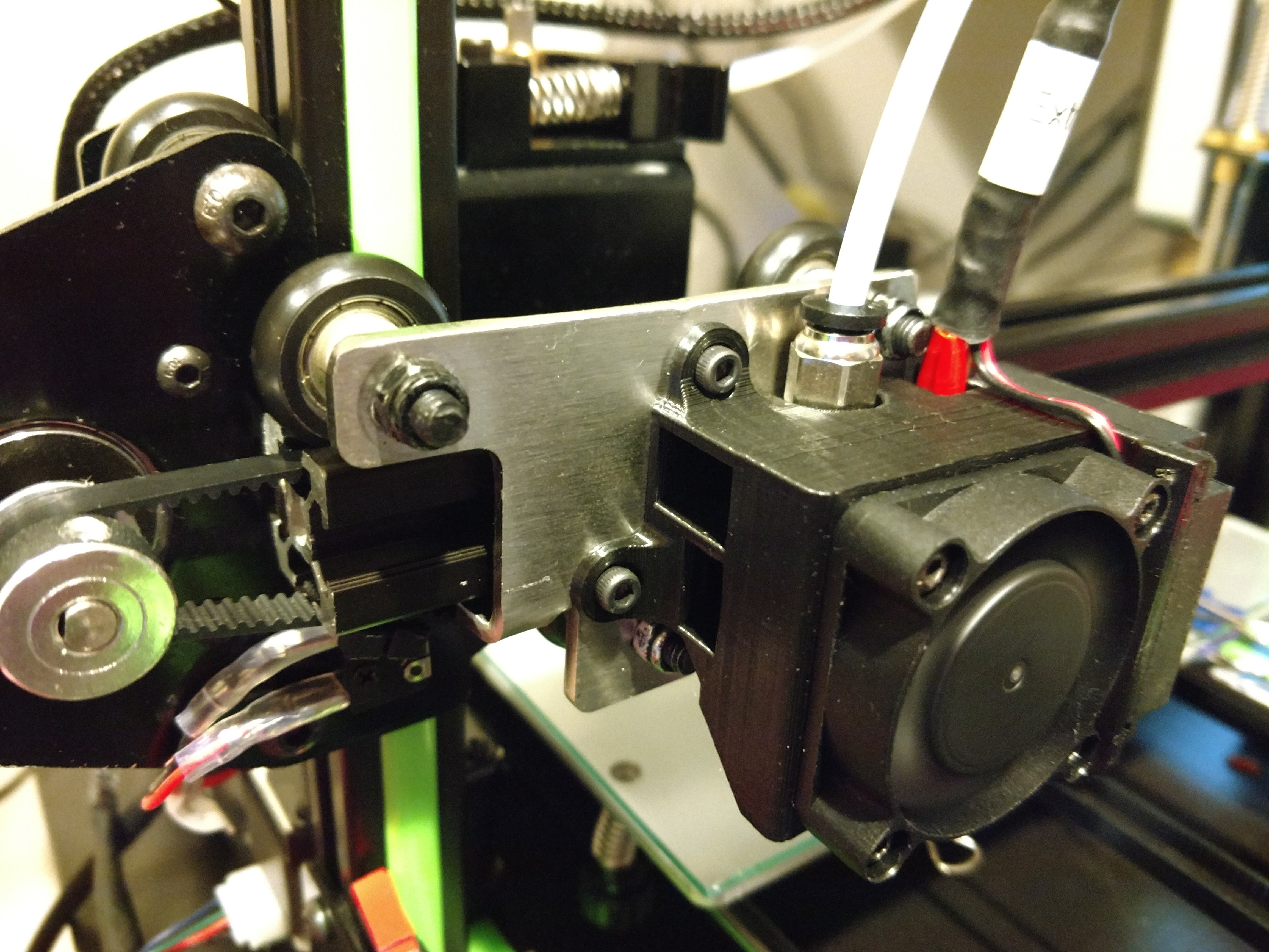

So I’m sure many of you have heard of the Anet E10 (the CR-10 killer) and while it’s not a bad printer, it definitely has a few things that could use some work. One of these things is the carriage for the hot end. You can see a small black plate in the second picture, that’s the original. It had 2 wheels on top and one on the bottom. The problem with this is that the top left wheel is almost right above the bottom wheel and this allows it to wobble back and forth no matter how tight you make the bottom wheel against the extrusion. How do you fix this? Why you design your own bracket of course! Well maybe design is a little much but a redesign for sure. I’ve moved that wheel out so the bottom wheel is split 50/50 and a couple other things as well. Now it’s solid as a rock! A little bit of design time and $25 to a local laser cutting shop and I’m good to go!

If you already own this printer and would like to make your own carriage, I’d be happy to share the .dxf file with you though most laser cutting places have a minimum fee of $50. I just get a discount as I ordered it though work. Working as a mechanical engineer for a custom automation company can have it’s perks.
Would it have been possible to add another oversized hole in a more ideal location on the original plate? That would save some time and money.
Btw, Luigi is a plumber, not a mechanical engineer.
@Matt_Harrington no. You would have to move the bottom hole to the right but the hot end is there.
Is there a reason it couldn’t be 3d printed?
@Doug_Rector I actually did print it initially to test fit it before I made the steel bracket but the original design won’t work if you printed it as it’s too thin. However, you probably could actually design it differently. I don’t know how strong it would actually be though as the wheels have to clamp around the extrusion. Plastic tends to flex a little bit. While I’m sure it can be done and it could probably work well, I didn’t really feel like putting that much time into it and I knew the metal one would work. It’s solid as a rock now and doesn’t wobble at all. For only $25 it’s worth it to me. Though I do wish Anet would implement my re-design because the stock piece sucks to say the least…
