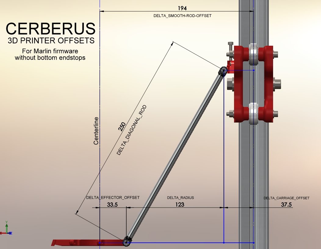

So is there any Information around how to configure that in redeem? I know there is a guide in the wiki but it is not really helpful. Maybe some one has found out how to set the values the right way. Thanks for the help.
