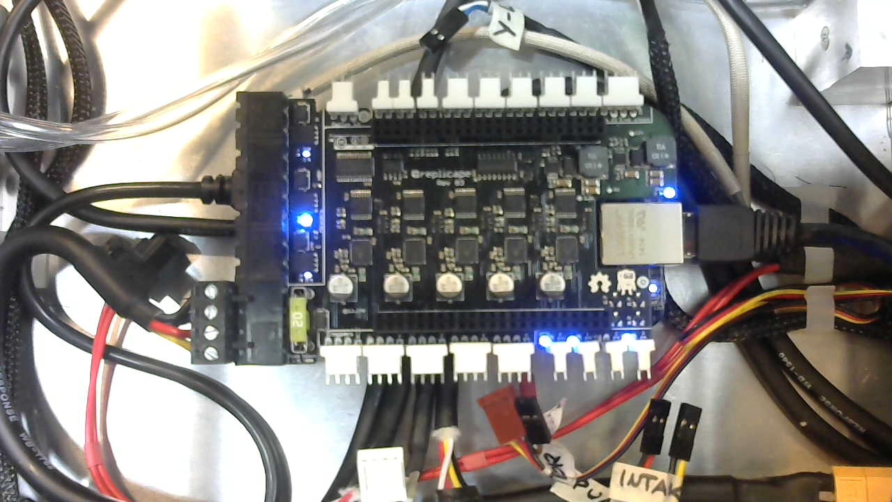

So it has been a looong time, but I am finally getting back into 3d printing. Unfortunately I’ve hit a problem. Powering up the Replicape for the first time in well over a year and I am getting “Error accessing 0x70: Check your I2C address”. Note that I have power to the replicape so it isn’t that. I also have all heaters plus three of the fans permanently powered on as shown in the image. I have nothing connected to the Replicape except for power (24V) and I am running the latest Umikaze image. Please tell me I don’t have a bricked board…
Hi Daryl, from what I’m making out on your board you have one of the B3 boards, correct? The I2C address problem can come from 2 main problems. One is one of the pins isn’t seated properly and actually folded during insert (it’s annoying to check and fix, but nothing major, no damage done).
The other thing that’s possible is that you need to reflash the EEPROM, follow the instructions here: http://wiki.thing-printer.com/index.php?title=Replicape#Update_EEPROM (following the Debian instructions)
If neither one of the actions above fix the issue, we’ll have to dig a bit further with logs etc. Joining us on the Replicape slack will help cut down on the feedback time
