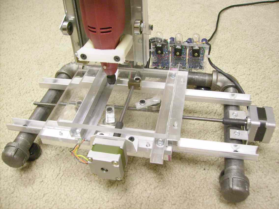

Well, it was working last time I tried it but I ordered the screws so I can finish an upgrade. I 3d printed bearing holders and rod holders and bought bearings and 8mm rod. (mine is based on this old design http://www.instructables.com/id/Easy-to-Build-Desk-Top-3-Axis-CNC-Milling-Machine/)
Here’s a pic from 9yrs ago
https://cdn.instructables.com/FWQ/OY45/FA190OBY/FWQOY45FA190OBY.LARGE.jpg
Maybe I can turn having that machine into some work…
