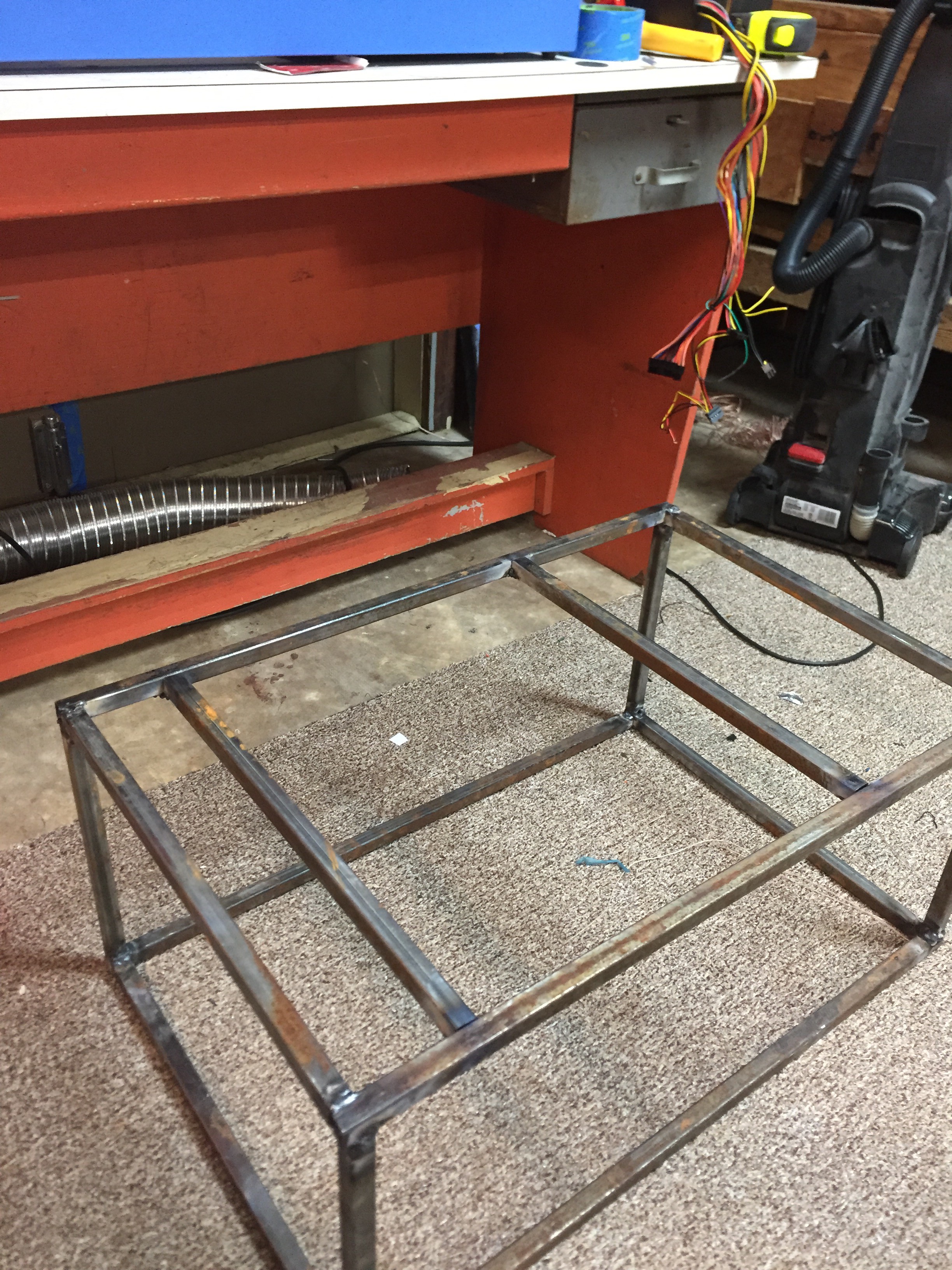

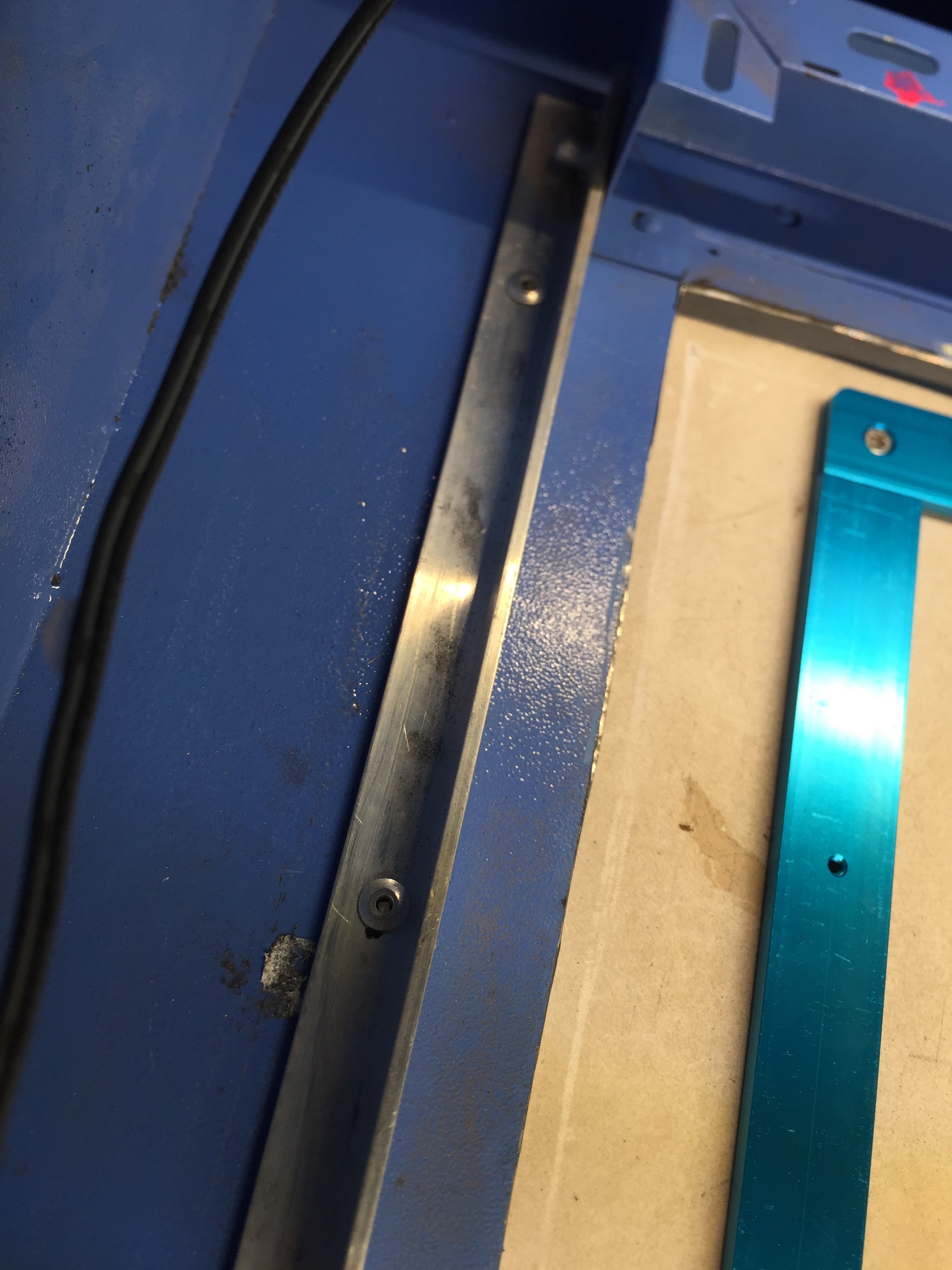

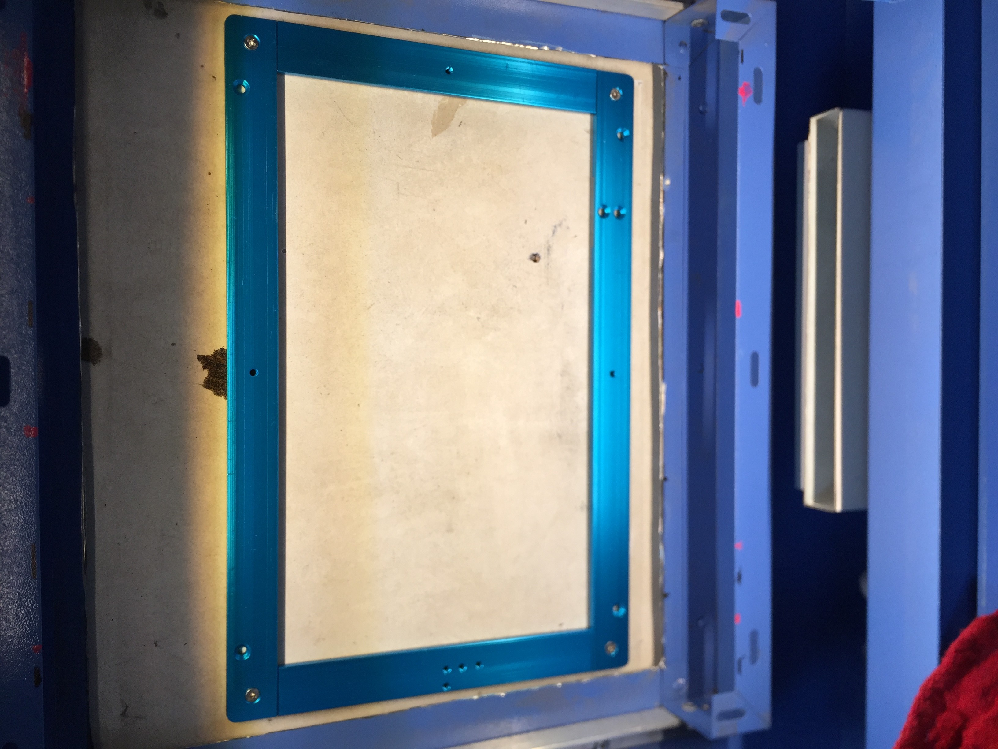

So I’ve been thinking, the depth of the K40 shell is roughly 3". What if you reinforce the bottom edges with steel (to keep the integrity of the shell so the rails don’t shift), and then cut out the bottom and create a deeper bottom (create a special stand if you will) and take a scissor jack to create a Z-Table? What are your thoughts?
It should work. That’s the concept behind FSL’s Muse with the extension.

Doing that now
Also replacing couple of pieces of the LO z table to increase travel height to 11-12 inches

Building extension for bottom of laser
