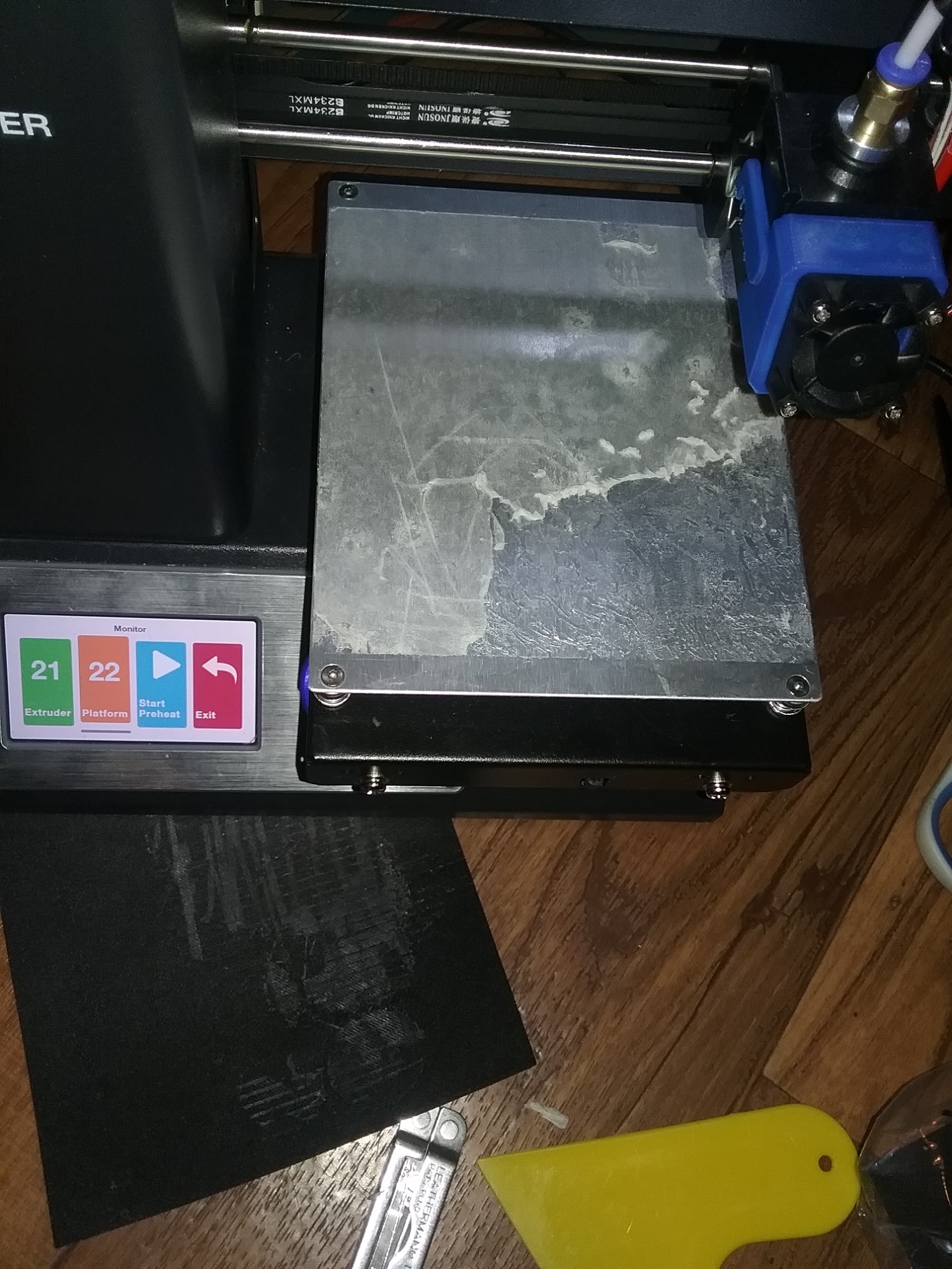

So ive decided to replace my build tak but there is the adhesive stuck
So ive decided to replace my build tak but there is the adhesive stuck on there. I have just been peeling it off piece by piece.
I’m sure there is a faster way to do this, can any of you help?
Depending on the adhesive, should be able to use acetone or windex on it.
@Xenomorpheus thanks i think i have both of those so ill try them.
If you have access to a clothes steamer it will help release that really quick then you can scrape and wipe down the reside with acetone. I used one to remove the tint from the windows on my truck. No adhesive reside left afterwards.

@Spark_356 you could try a heat gun to get the adhesive to loosen up.
Should have heated the bed up to 220 first, probably still can and it should all pull off
The easyest way is to remove the bed and wash it out with acetone based solvent.
A heatgun with a scraper to peel it off, then use acetone to remove any remaining adhesive.

I use a product called Goo Gone
acetone !
Shellite is also amazing at removing/dissolving glue and isn’t as harsh as acetone.

Soak it with WD-40, works like a charm!
Goo Gone and a scraper. Let sit for a while then scrape
