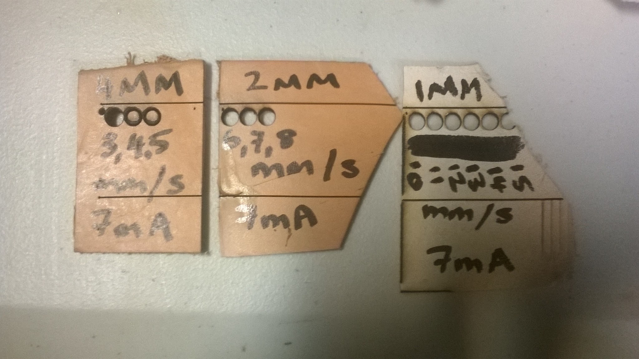

Here’s some tests I did on leather.
From left to right:
4mm Natural Vegetable Tanned Leather
Tests: 3, 4 & 5mm/s
Power: 7mA
Conclusion: 3mm/s worked, but only just. Might be better to drop to 2.5mm/s if possible.
2mm Natural Vegetable Tanned Leather
Tests: 6, 7 & 8 mm/s
Power: 7mA
Conclusion: All three speeds worked. So, I’d recommend going with the faster speed.
1mm Natural Vegetable Tanned Kangaroo Hide
Tests: 10, 11, 12, 13, 14, 15mm/s
Power: 7mA
Conclusion: All five speeds worked. So again, I’d recommend going with the faster speed.
