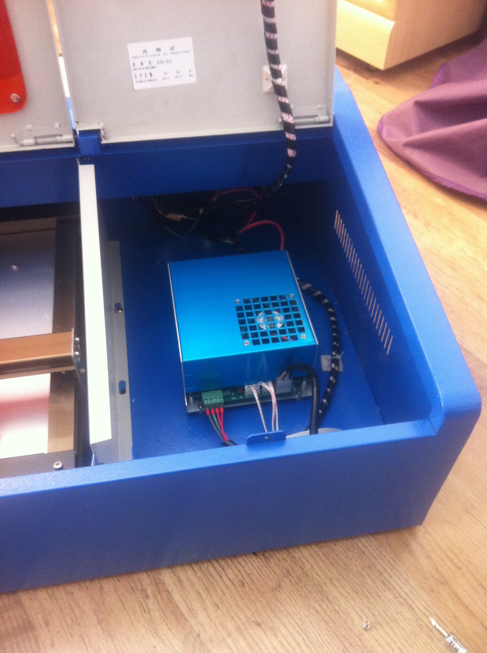

So I've got my machine and all appears to be ok.
So I’ve got my machine and all appears to be ok. Is it possible to run the machine without firing the laser ie just to check out xy movement and comms from software. My machine has the nano board
