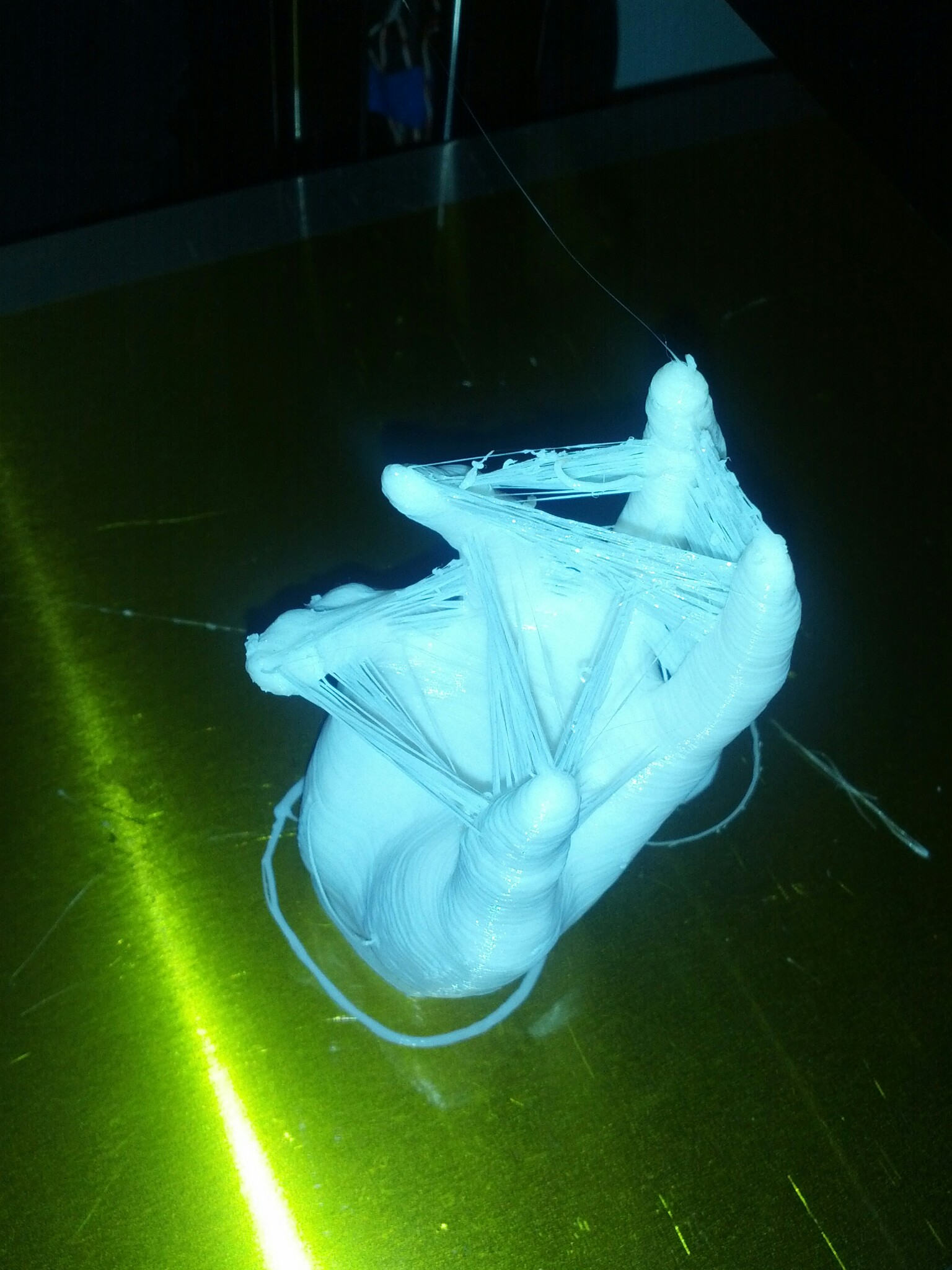

So I've gotten my layer alignment better by properly tensioning my x and y
So I’ve gotten my layer alignment better by properly tensioning my x and y belts, I haven’t bothered with retraction yet, haven’t installed my fan yet, but I have a weird problem with speed. In using slicer 0.9.10b

Kinda reminds me of an episode of ‘lost in space’ … There were clones or some such and the only differing feature were their webbed hands …

As for the stringing, I’ll give that retraction a shot, but I think it may be my extruder, which is just a gear preloaded into a 608 bearing. I had it at 3mm before, but I was getting underextrusion when it finished it’s move, as I think the extruder slipped a bit on the filament that already had tooth marks in it. I think there’s a correction for this either in slicer or firmware, but I was going to change my extruder anyways
