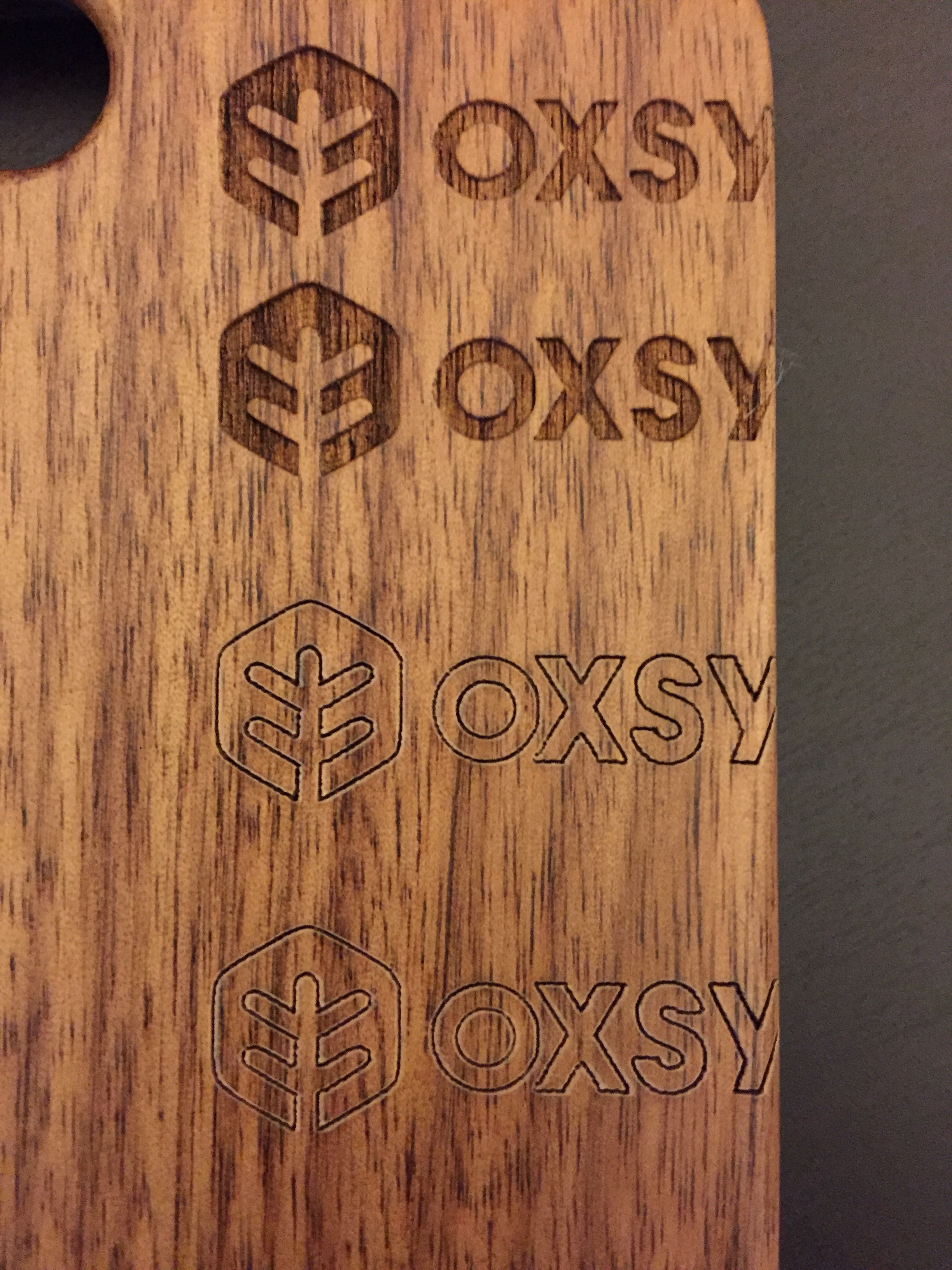

So I’ve just done an interesting back to back test with and without air assist running, otherwise there was no other changes.
From top to bottom 1 & 3 are with air assist on, 2 & 4 are without.
Now to me the ones with air assist look no better - in fact, potentially look worse? Anyone else experienced no gains/ negative effect from air assist?
Air assist is mostly to cut.
during cutting had several effects, first it help combustion in deep cut and help to remove ashes, and last it’s to keep fume out of the lens (stay clean & don’t diminish the power ray intensity).
as per engraving it’s less evident depending on material, but to keep your lens clean.
The type of material is also a factor.
1 & 3 are noticeably crisper on the edges and obviously deeper cute overall. It does help bring it out but with thin material I’d imagine it could be a problem. What speed/pwr settings?
I’ve always run with air assist when engraving because it keeps the bottom of the lens clean like Stephane said. Also prevents flare ups from happening. That being said I do have a flow controller on my setup and I run lower flow for engraving and crank it up for cutting.
