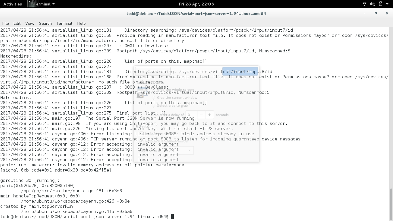

So I’ve switched to linux Debian distro. Kind of empowering and equally frustrating at the same time. I have determined that Chilipeppr can see a running JSON server and my USB0 port with either NodeMCU or Tiny G. However, no data can be sent or received. I have feeling it might have something to do with certs or keys? This is JSON screen shot in Verbose mode. Any suggestions?
You might have some other instance or Service running that is listening on port 8988.
netstat -anp | grep 8988
(might reveal the culprit)
Don’t worry about the certs. It will still bind to port 8988/http provided that your user permissions allow that. If not you might try running it as root or under sudo.
According to the trace sjps is not finding any open serial ports.
And as Werner says, the port is already in use. Note that you need to bail on sjps with ctrl+c not z. If you use ctrl z you need manually to kill the process after
kill -s 9 pid.
Does your user have permission to use the serial ports?
So I navigated to the directory where serial port is, executed SU command to get root permission and ran the server. Chilipeppr sees my device but when I try to check the box after adjusting the baud rate the box immediately becomes unchecked and both JSON and chilipeppr tell me the device can not be located?

So I got it, fresh system reboot, open terminal window, change directory to where JSON executable is, execute “su” root permission, then load JSON server. There must be a way to give permission to my user without executing root permission,…all in good time. By Windows!
Thank you for the help guys.
There are ways. Yes. But as sjps binds to a non privileged port it should not be be a permissions issue really.
If you have issues check the processes first. ps -A. If there is an instance of sjps in the list then take a note of its number and kill it with kill -s 9 12345. (where 12345 is the pid)
