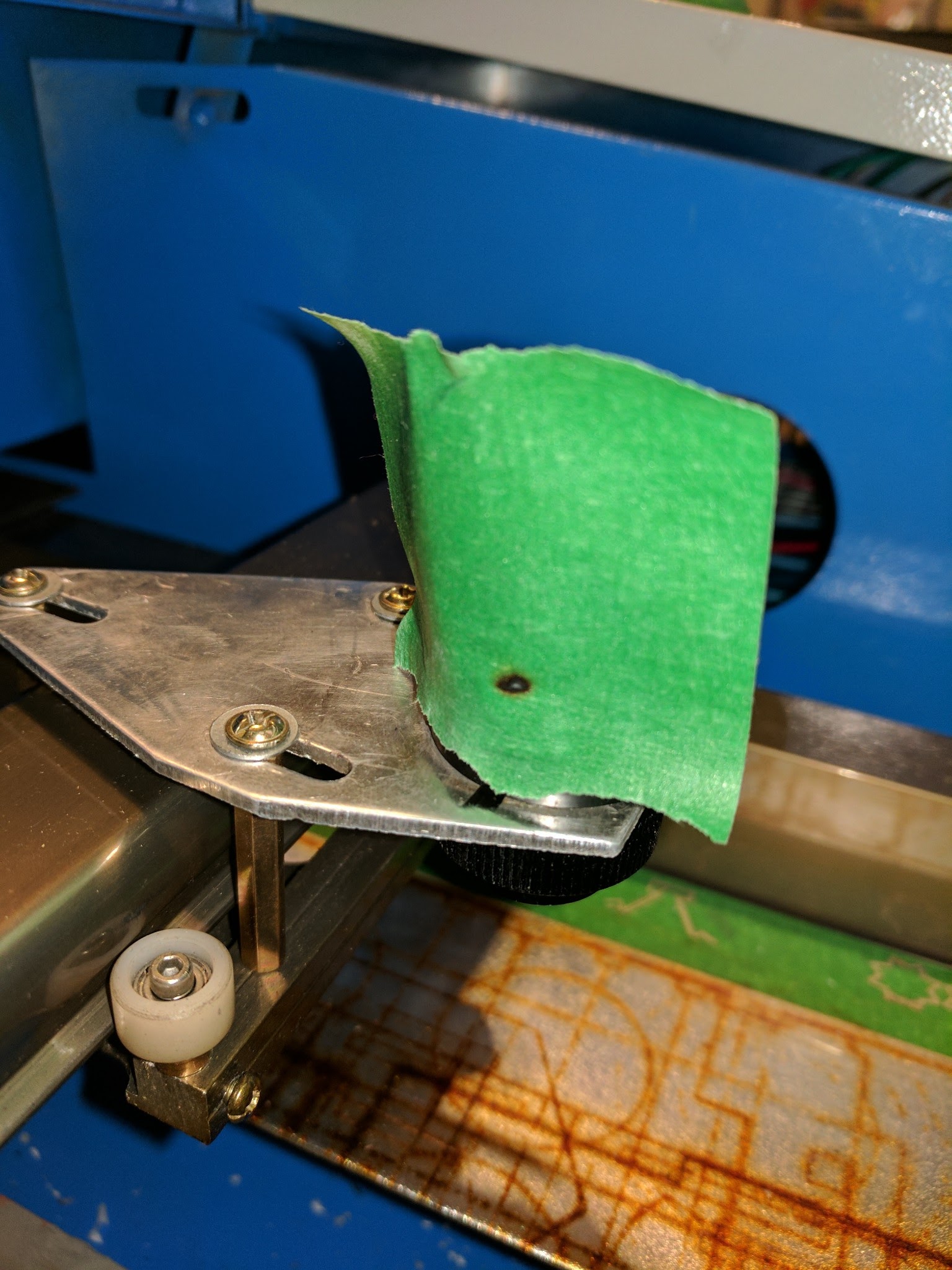

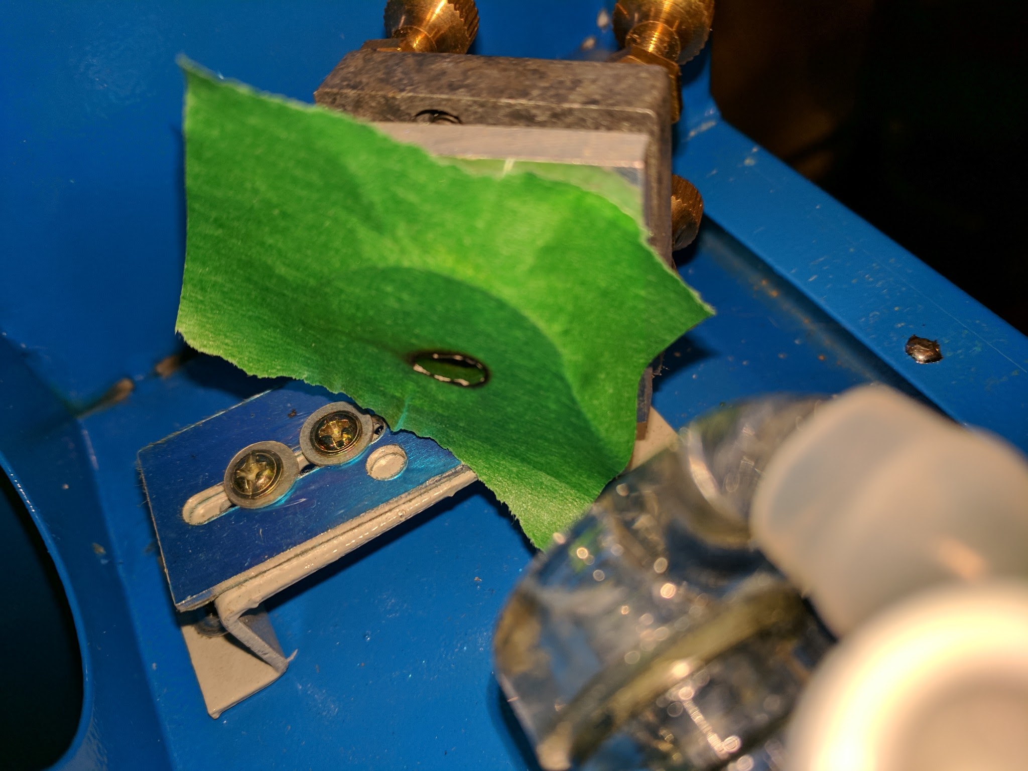

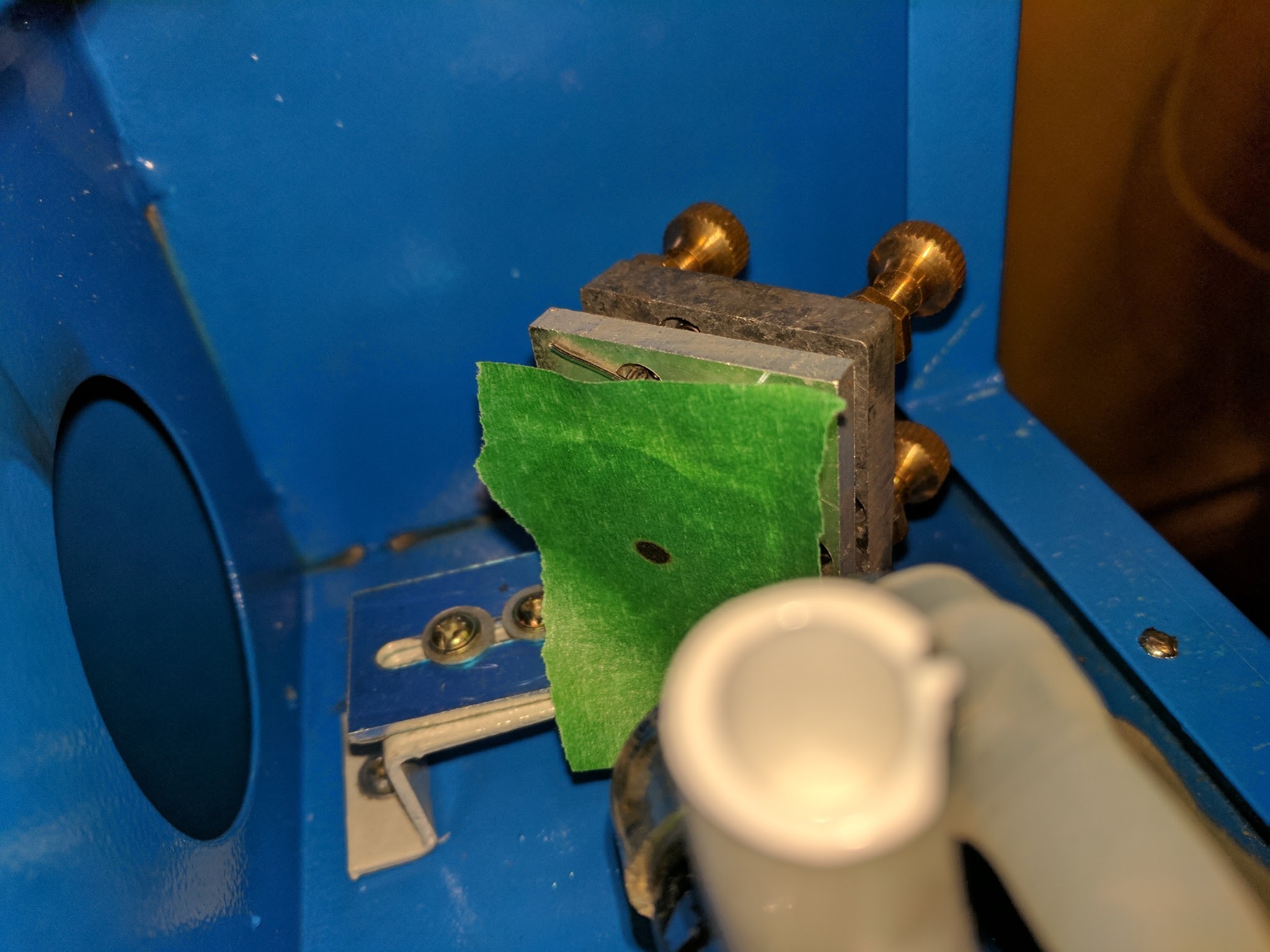

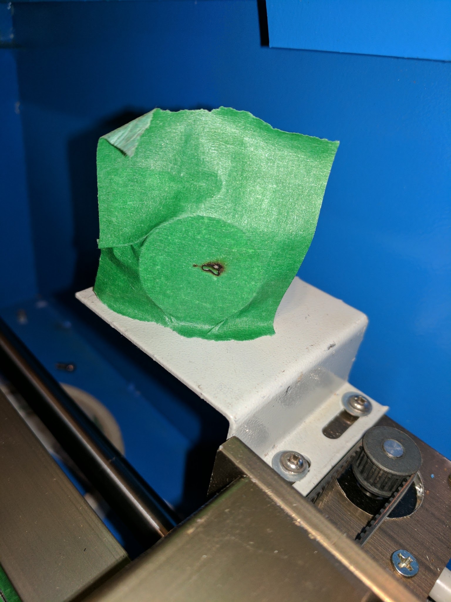

when you check all four corners of the work area with a piece of tape covering the laser head hole, (entry before the last mirror, not nozzle side) is there only one spot on it or multiple? Is it hitting the middle of the hole or is it off-center? a picture of said tape would help visually confirm your calibration is properly set.(and of reflection point on mirrors while your at it ) I know a lot of this has been suggested but you know how troubleshooting works…IT makes you go through all the steps with them regardless :slight_smile:

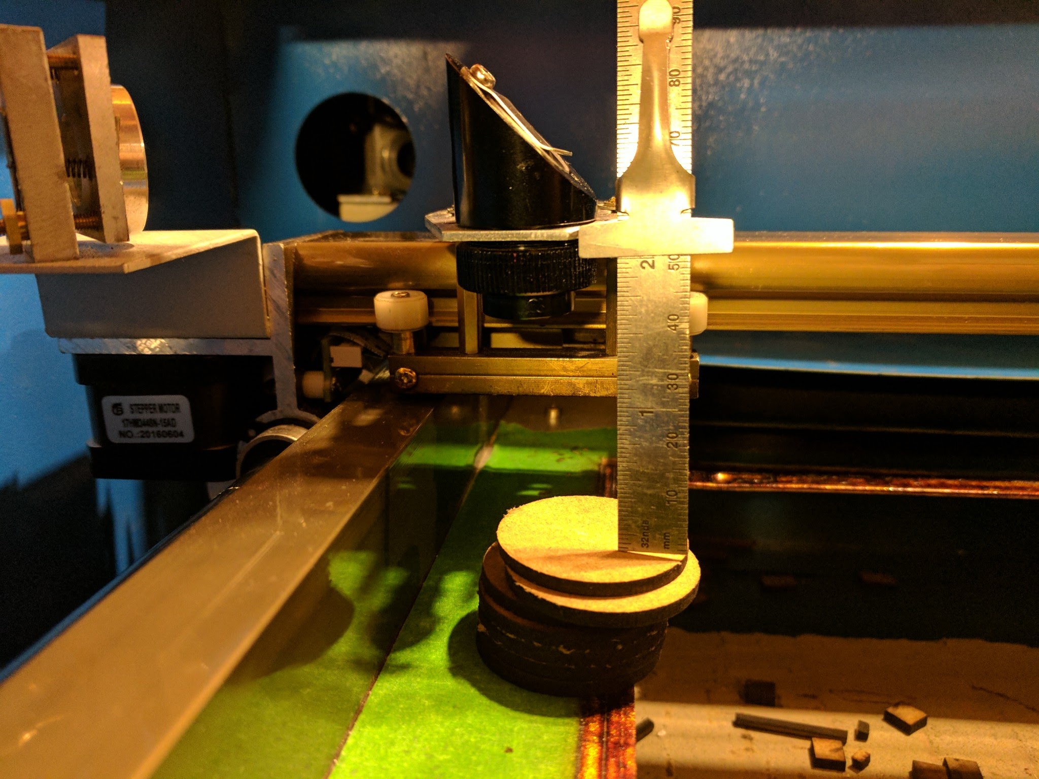

Are you focusing into the centre of the material? or onto the top of the material? That makes a big difference too.
I’ll try all that and post pictures tonight.
