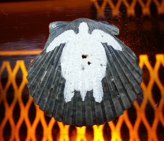

Was at the beach yesterday and wondered if you could engrave shells. Turns out yes you can. 35% power (~10ma) at 180mm/s . (Holes were already there.)

The ones from the hobby store will probably already have a clear coat on them, but if not clear coat them for a darker wet look.
