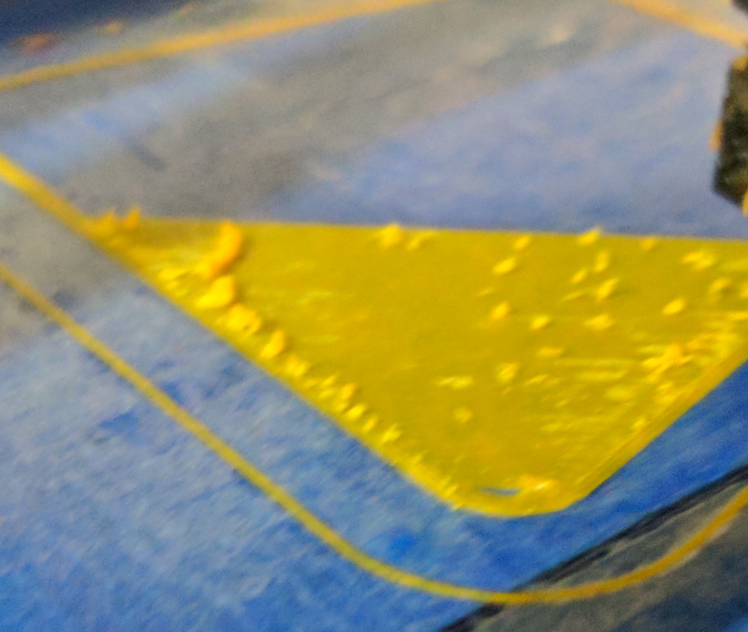

So looking much better now. Working decent. But how do I get rid of these little balls?
Printing with abs. Temperature 240/100
Reduce the extrusion multiplier maybe?
Jason_Tira
(Jason Tira)
February 17, 2017, 7:41pm
3
I’ll sure try. Its at 1.1 now
_Spice
(黒い楓(Spice))
February 17, 2017, 8:36pm
4
Try 230° and lower your extrusion multiplayer to 1 or lower.

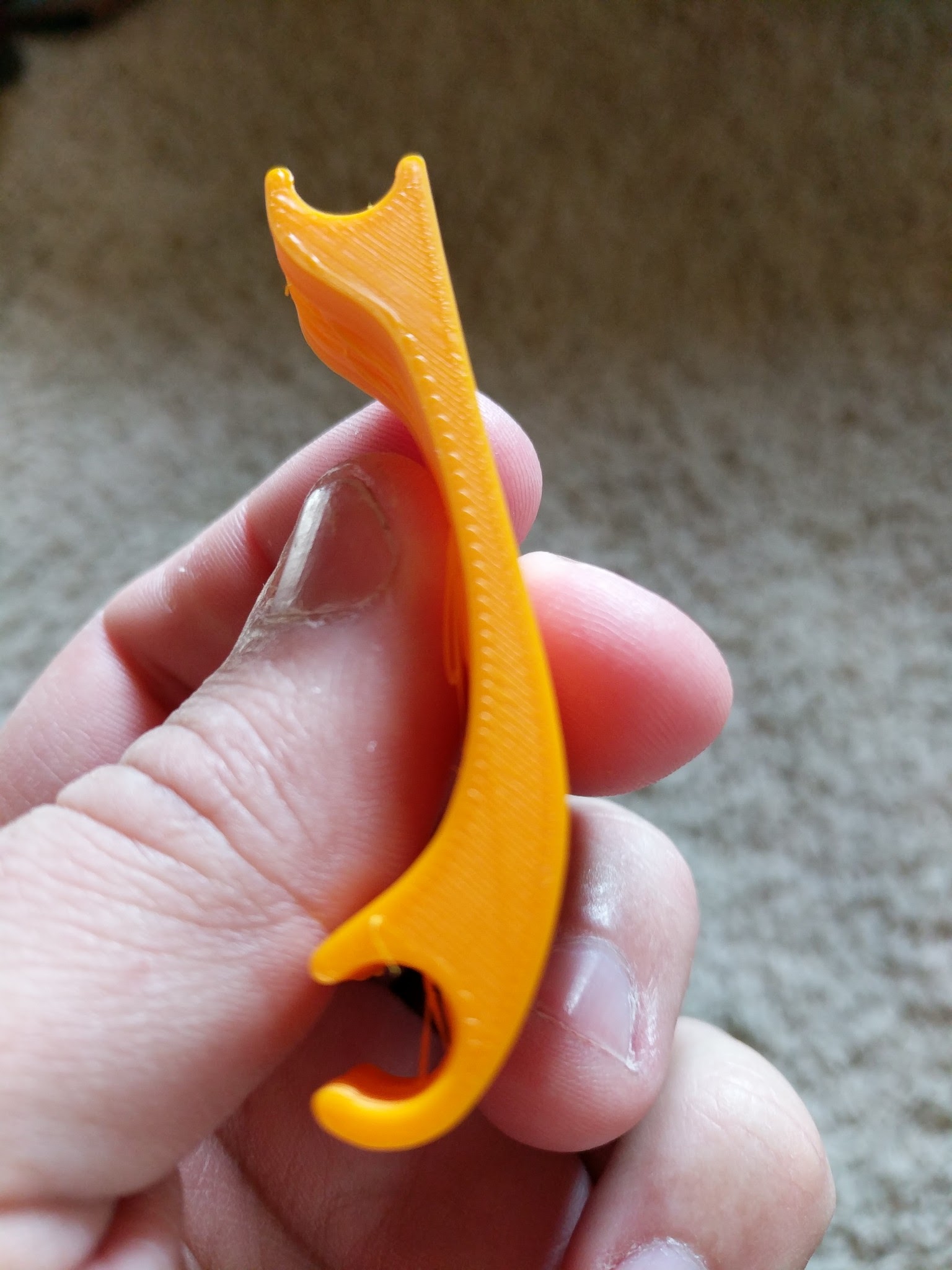

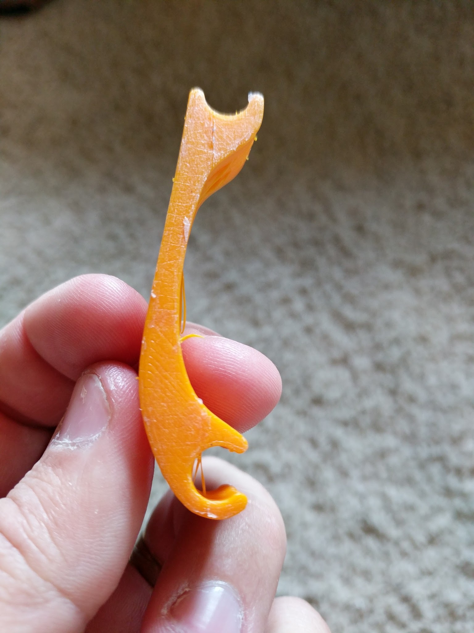

Progress so far. My infill is really poor. I think it needs slowed down a lot. The surfaces aren’t very nice either.
What do you guys do for top and bottom? 2mm?

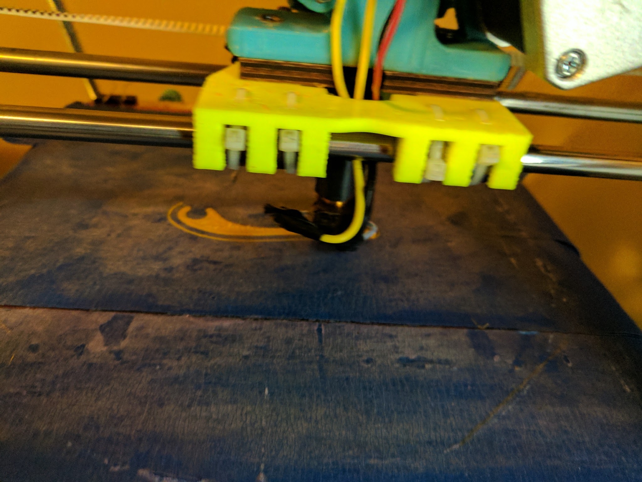

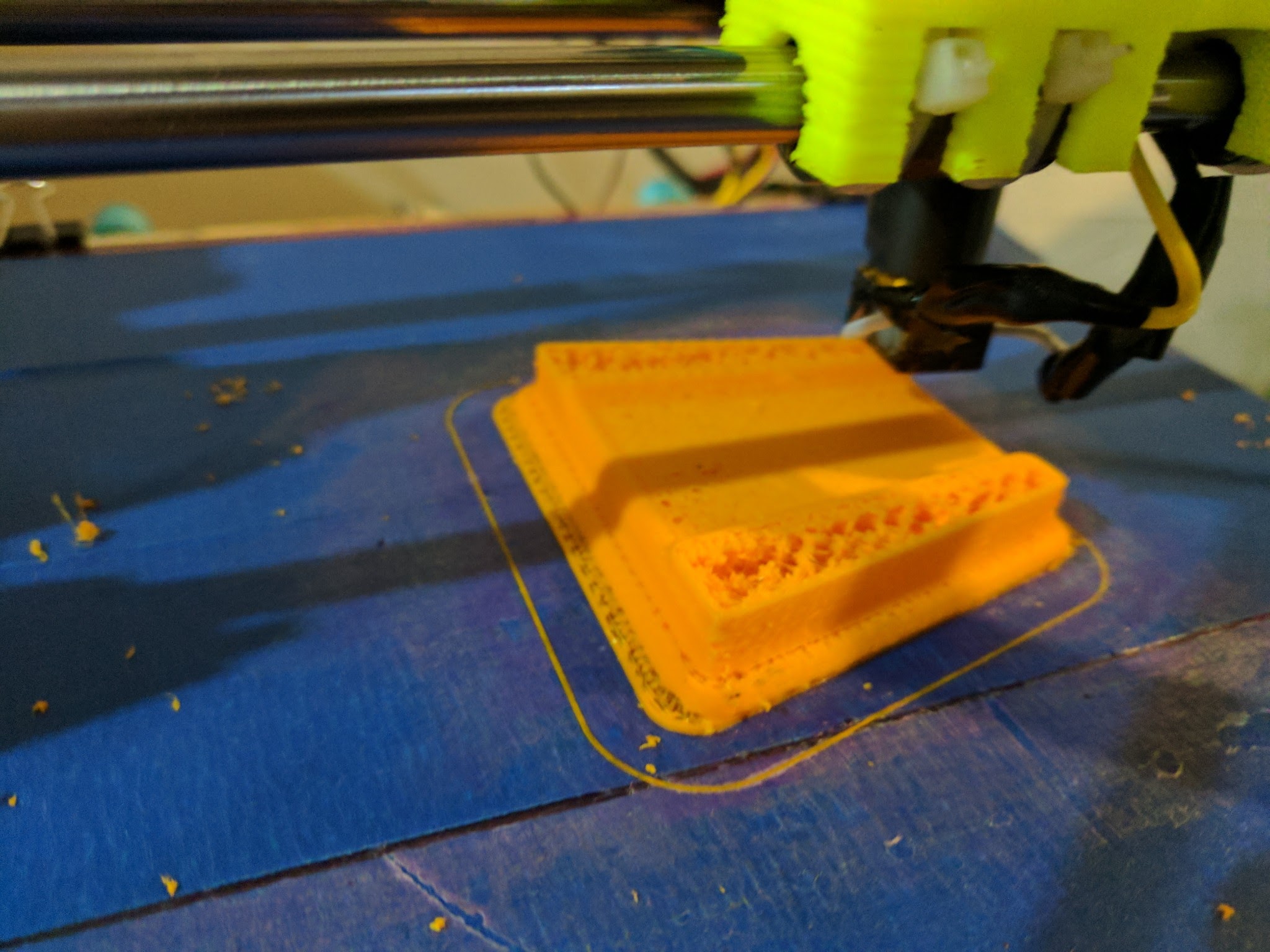

OK everyone, made a lot of progress thanks to you guys!
Doing some test prints now. Here is one going.

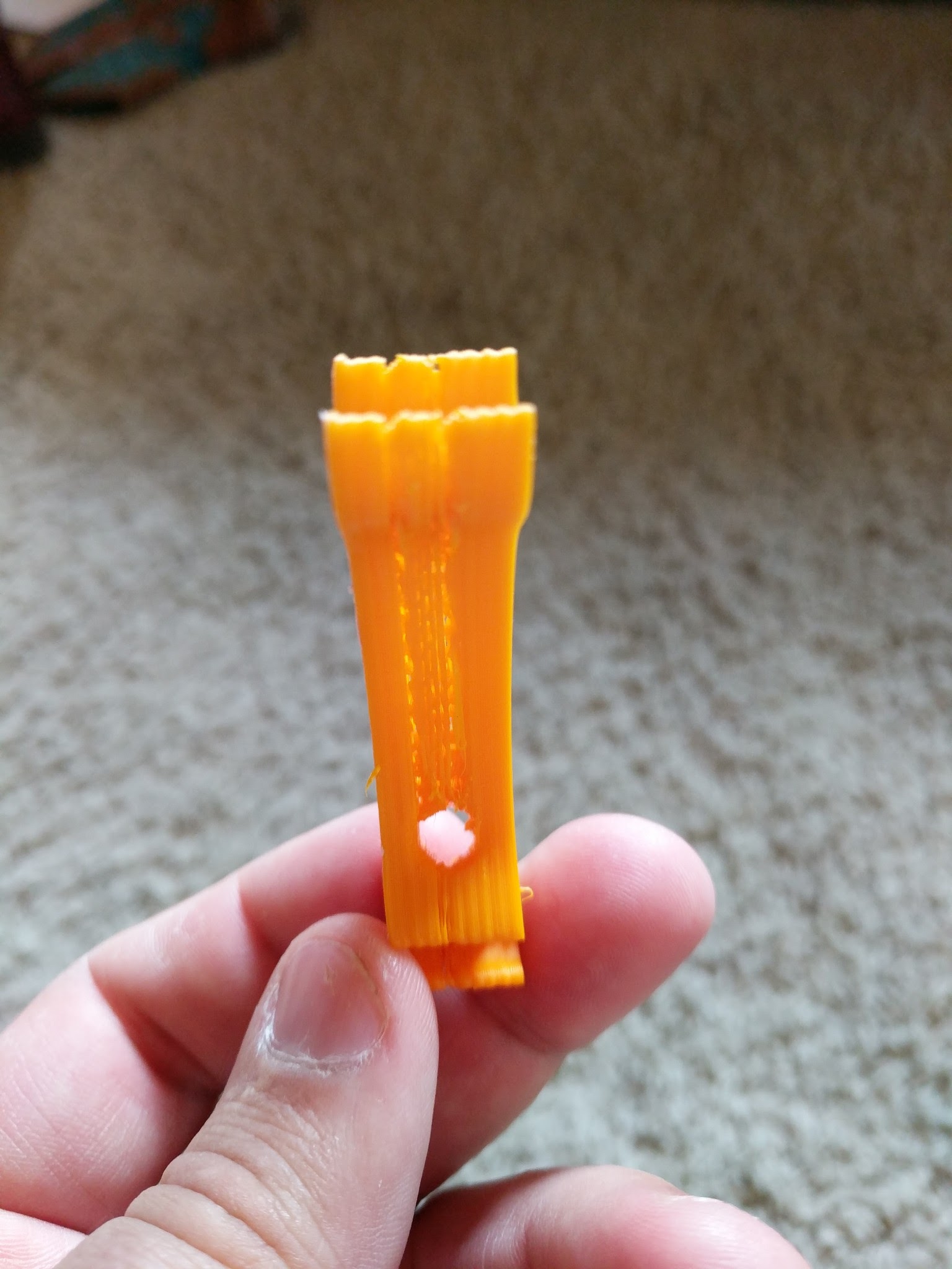

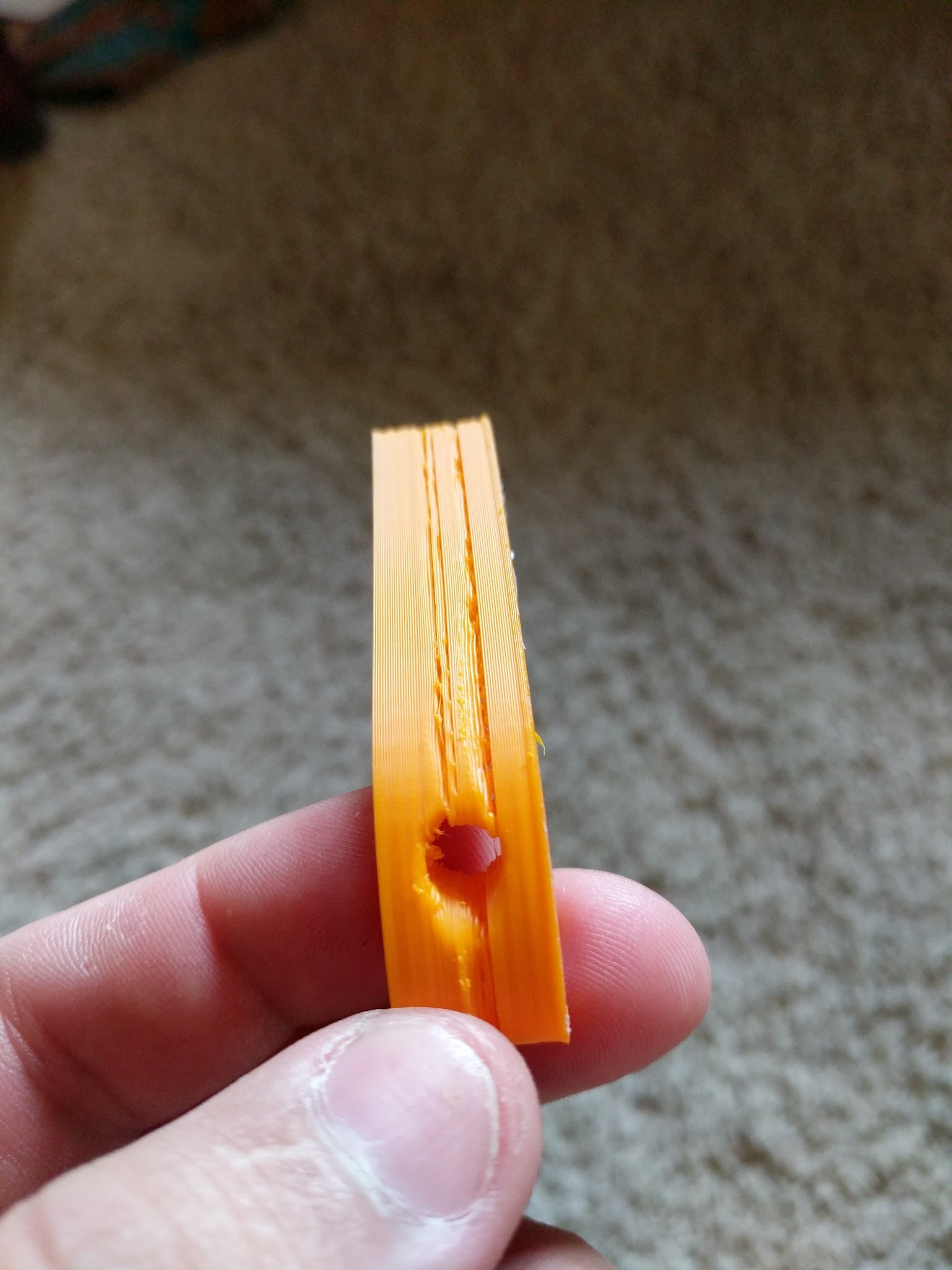

Some separation happening
Jason_Tira
(Jason Tira)
February 19, 2017, 11:30pm
17
Anybody know why it would separate at the hole and only the hole?
_Spice
(黒い楓(Spice))
February 19, 2017, 11:51pm
18
Poor layer adheasion. Maybe the temp was a little too low?
Jason_Tira
(Jason Tira)
February 19, 2017, 11:57pm
19
It was at 240, but it’s only on the starting and stopping of the holes
