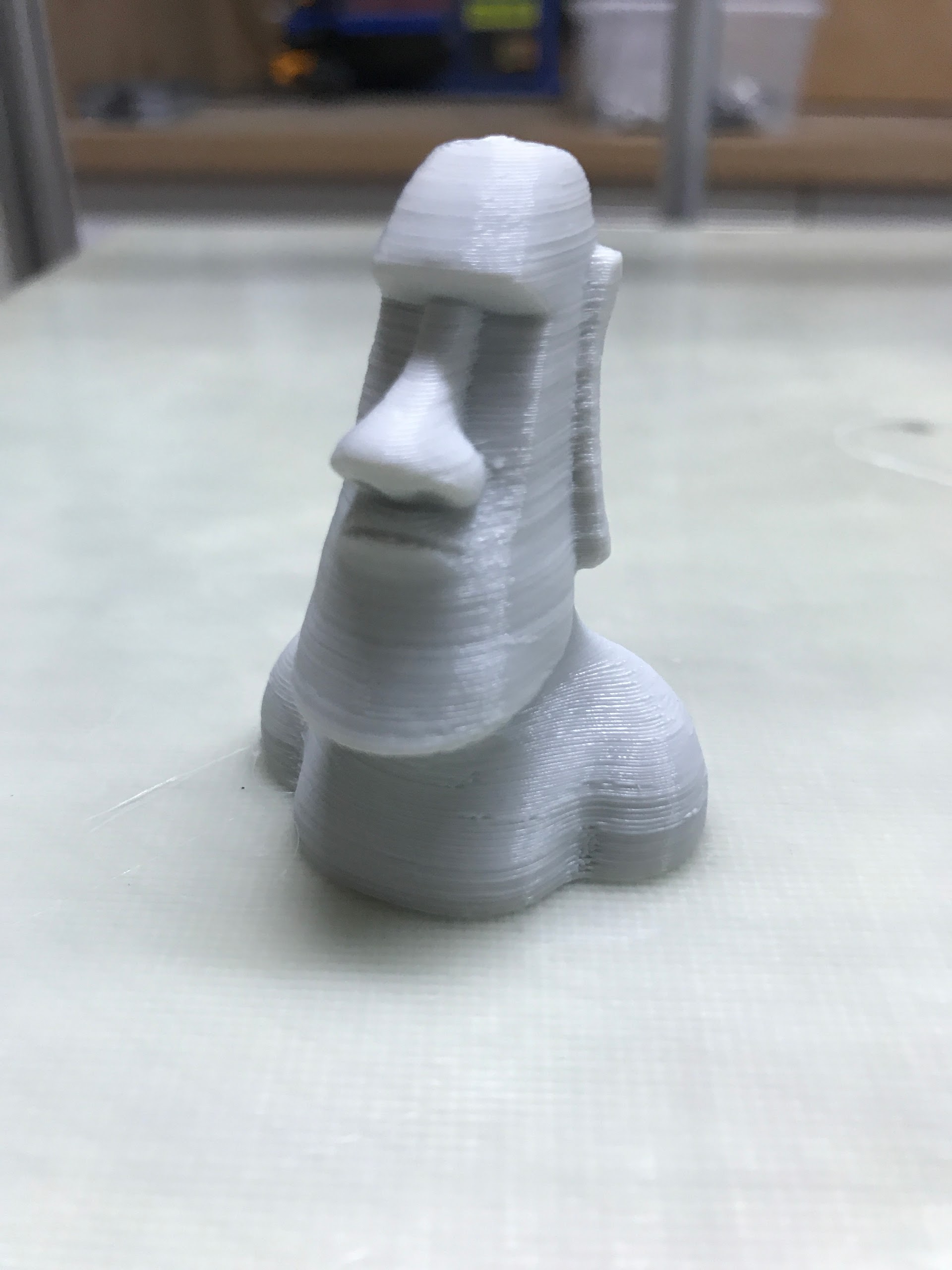

The bad part though is that I’m continueing to see problems with filament jamming, blobs comming out of the nozzle on slow speeds and small parts with PLA and even on filament that isn’t as easily meltable as PLA is the problem is visible, Take a look at this light grey Moai that I printed in Colorfabb nGen. You can clearly see the irregular layer lines and given the fact that they run all around and seeing everything much worse with PLA I’m relatively sure that this is the same temperature problem that I kind of always had.

this could probably be an issue for the image pisted above but the pla/retraction problems are far more extreme and shouldn’t suffer from smaller deviation.
How much does the reported temperatur deviate during a print like in the photo above? It shouldn’t be more than maybe 1-2 degrees after initial heat up.
