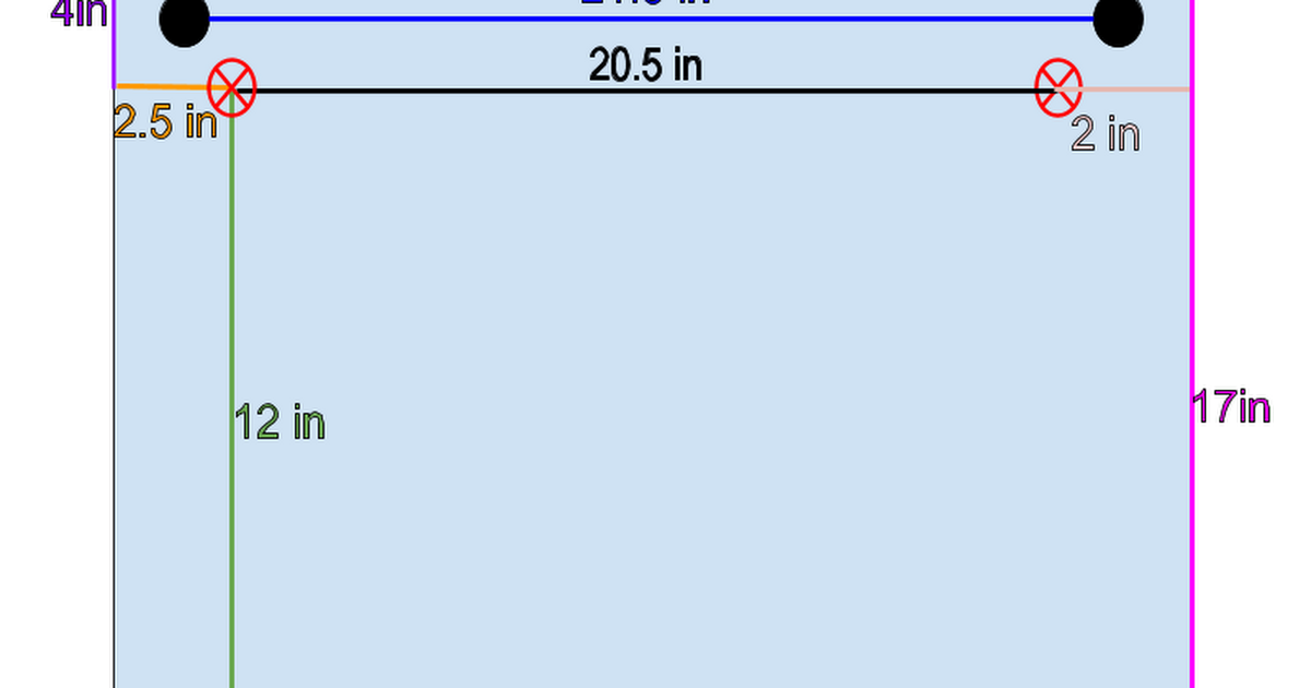

@Nigel_Conroy just a quick question what is the actual size of the cutting bed I want to get either a honey comb or blade table ordered and want to make sure it’s not to small or to big
@3D_Laser
Probably a bit more then you want but here you go…
Red cross-hairs are extremes of laser head
Black circles are the threaded rods the bed moves up and down on
A new surface that was 21 in x 14 in would fit in nicely and cover the working area of the laser.
Something with adjustable leveling feet is a good idea as the surface of the table isn’t flat as it’s light aluminum
@Nigel_Conroy thanks I am ordering a blade bed from Ali express
@Nigel_Conroy I though about doing 21.5 by 17 so it is renting on the frame not the aluminum bed
@3D_Laser you’ll need to explain a bit more by what you mean?
21.5 would be very tight to insert in mine as it wouldn’t really fit in between the threaded rods
