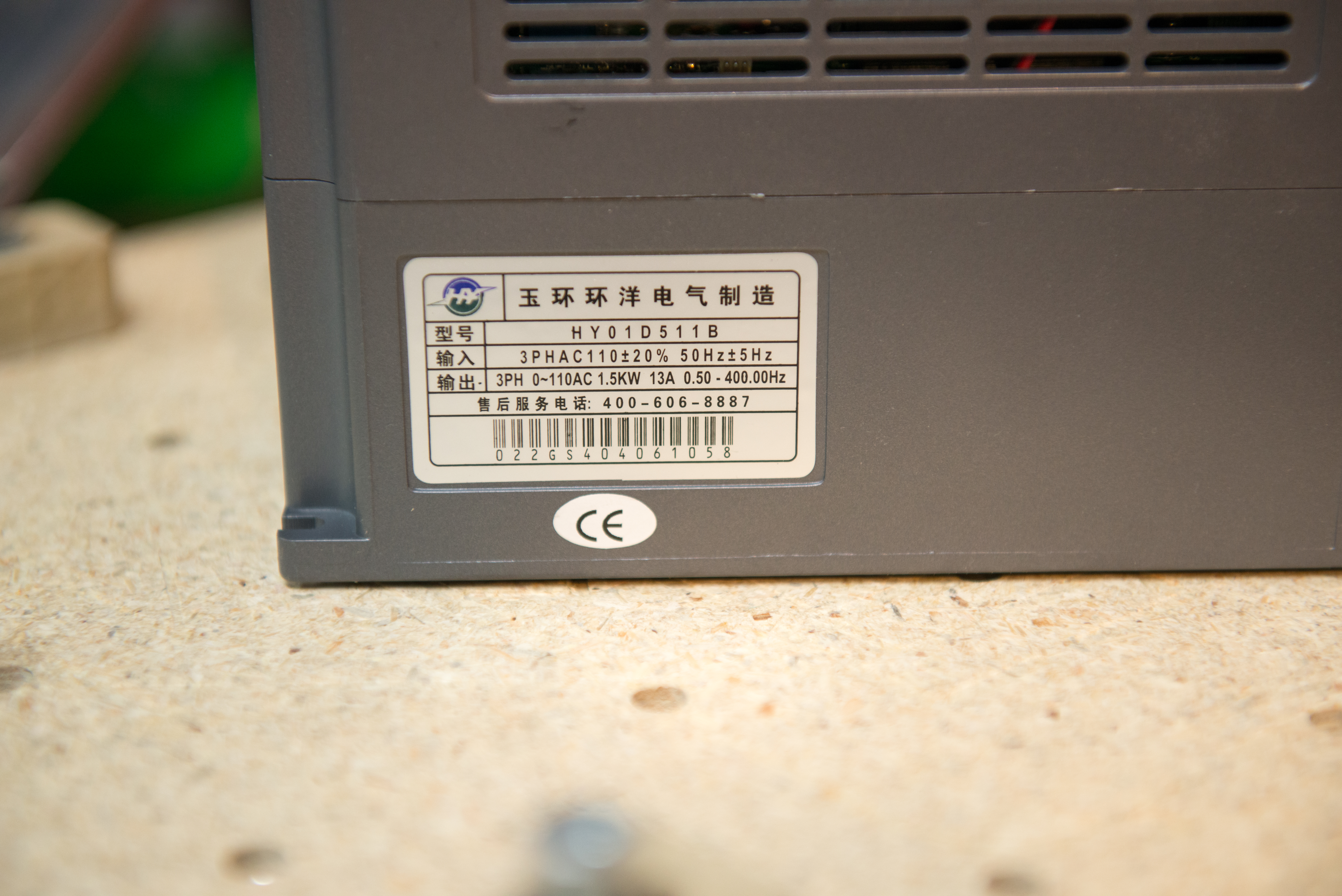

So many months ago, I asked around to find anyone using a 110V VFD with a watercooled spindle and if it was working well for them. There weren’t many replies, so I broke down the other month and ordered a 1.5kW 110V VFD. It showed up a couple days ago and is the exact same type we sell at work(only 220v) so programming it was a breeze. Also brought home an 800w watercooled spindle.
Let me just say this set-up rips through anything I throw at it, obviously as long as you use the right bit and feedrate and a sturdy machine. Not bad for $300?

Here’s the VFD I purchased from
http://www.ebay.com/itm/281513493625?_trksid=p2059210.m2749.l2649&ssPageName=STRK%3AMEBIDX%3AIT
