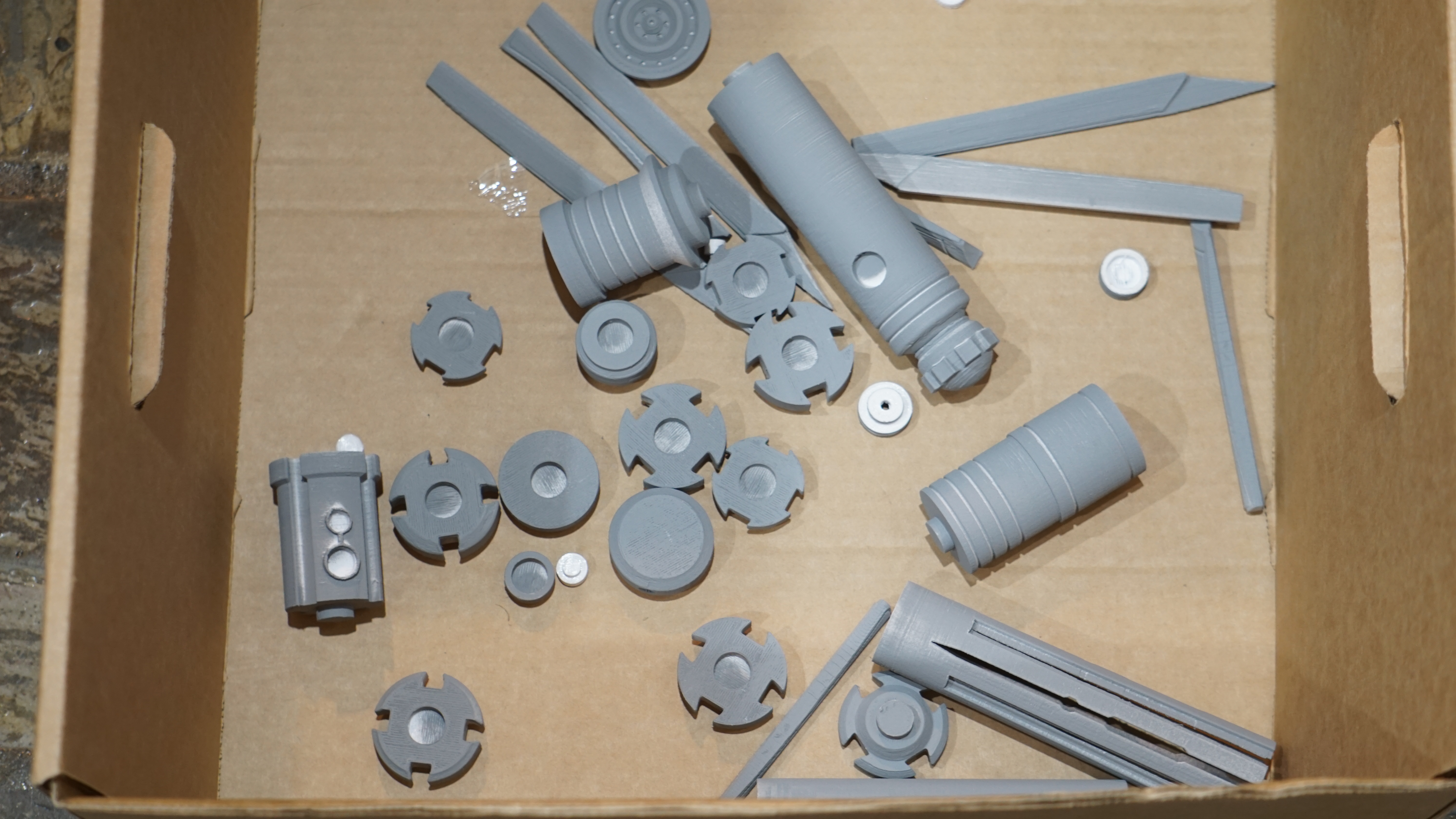

so many parts...filler primer is a good way to get rid of those print
so many parts…filler primer is a good way to get rid of those print lines. #3dprinting #starwars #lightsaber

What other names could have “filler primer”? Cant find it on my slicer, im using craftware for mac
Filler primer is a type of paint. Sorry for the confusion. Once you have printed you can sand the part spray with filler primer and it will fill any small voids so you get a smooth surface for your top coat.
A ok, its just that i have seen many people printing with almost none print lines, but i cant get rid of them
You will always get the print lines because of the way the printer works. You can minimise them with correct setup and setting but you can’t get rid of them completely. The vids you have seen probably have lighting that hides them pretty well or a little unfocused
