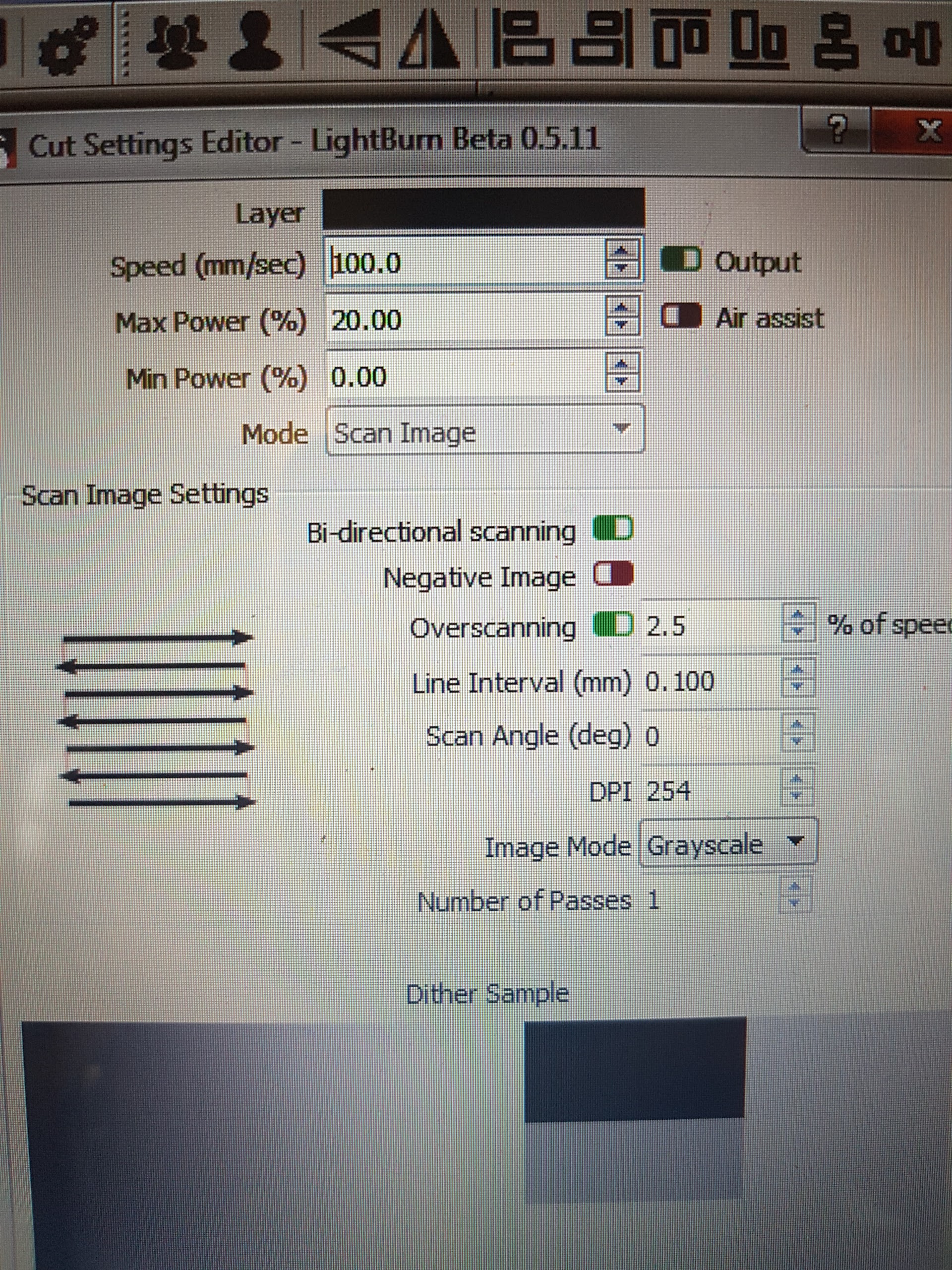

So. My laser is working and I attempted to etch an image onto a
So. My laser is working and I attempted to etch an image onto a medals case as this is the direction I am hoping to go with my buisness. The cases are made from leatherette fabric… see pictures and lightburn settings used.
How can I make this better then?

My first thought is more speed and less power. On my little bit of testing (still don’t have proper ventilation in place) 10% and 100 speed is enough to get through masking tape and etch acrylic.
Thanks David. I will try your suggested settings.

I always try low power, fast engrave first. I then bump up the power a little, then slow the engrave speed a little, back and forth until I get the results I am looking for.
