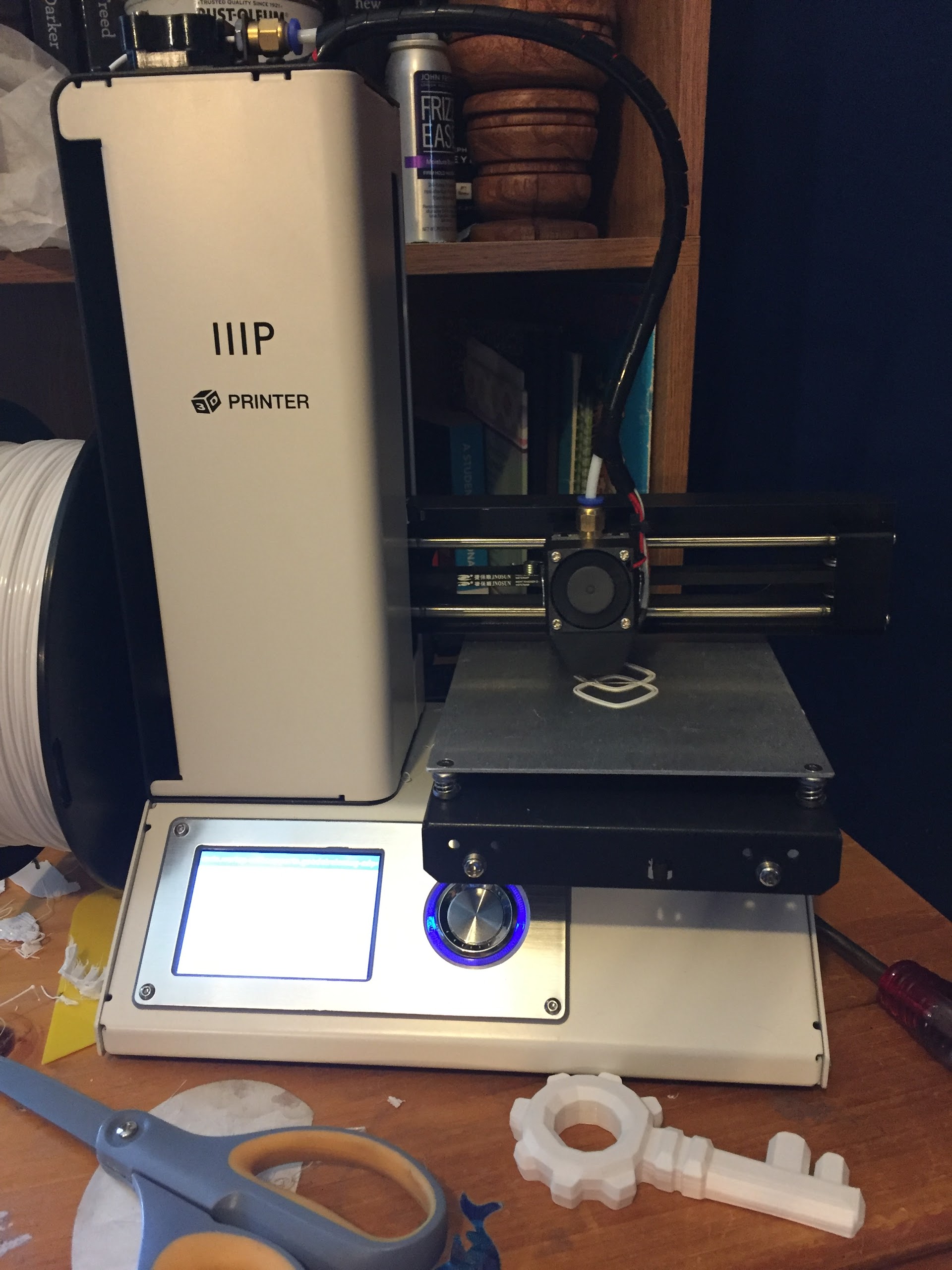

So my MP Select mini has been having a slight issue when printing where
So my MP Select mini has been having a slight issue when printing where it will start but extrude before it is in place. I proceed to reset the print, however when it starts again it will go to the back right corner and attempt to keep going. I don’t know why it does this and would appreciate if anybody could tell me why it happens and/or how to fix it. Thanks.
Perhaps it just noticed you were wasting your time printing nonsense and wanted to quit.
@Glass_Half perhaps so. lmao
Attempting to move past the back right corner sounds like it thinks your origin is somewhere in the middle of the platform. Hard to tell from your description, but if “reset the print” means power off the machine, and your print doesn’t have a start code that includes homing, that would do it.
@Whosa_whatsis thank you!
