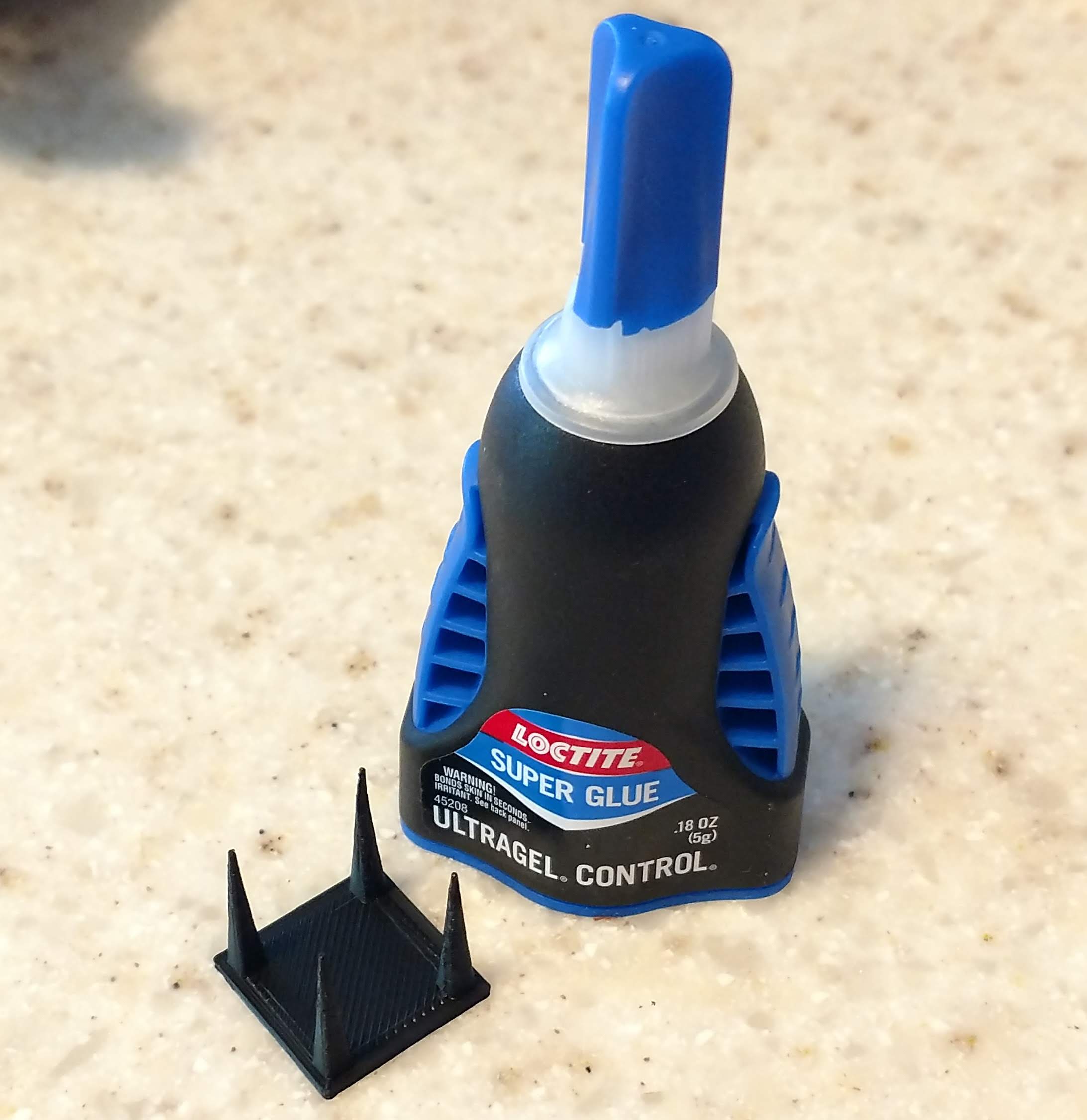

So my new Ender 3 is better than anticipated… Talk about being “on point”. Lol. This was printed at 60mm/s though it did slow down as the points got smaller in diameter to meet the minimum time limit. The size of this is 3/4" in all directions. Also, this was with the stock .4mm nozzel. I’m curious as to what it would do with the .2mm I have in a box.
Dont drop that on the floor - looks like a great caltrop!
@Doug_Rector it does kinda look like one. Lol.
that there is a perfect thing on which to perch a painted object for drying
