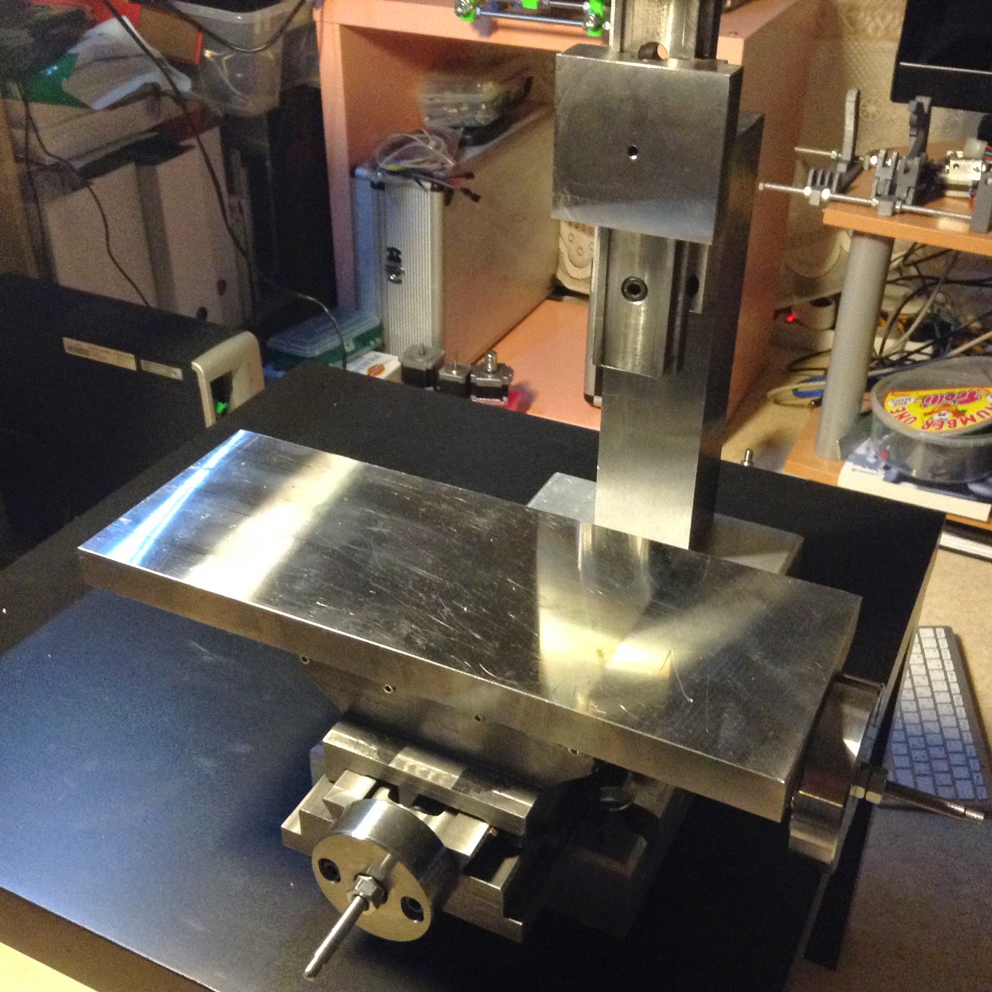

So my story begins here. The main thing is to start, but the more I do, the more I realize how much remains to be done. Cross table I upgraded was like here http://www.ebay.com/itm/2-Way-Cross-Slide-Vise-3-Mounts-on-Drill-Press-Table-/251815481590?pt=LH_DefaultDomain_0&hash=item3aa15f50f6
It was very cheap table, about € 50. Table dimensions 320x120. Weight is about 30kg already.

@Michael_Jacobsen Yes, from scratch, but not quite divorced from reality - sometimes you have to design of those materials that are. This is happiness when there are plenty to choose from.

@Vladislav_Kislovski Cool! Using steel?
@Michael_Jacobsen Everywhere steel, except the base. It is a soft aluminum, I thought it would help dampen vibration but at the same time the sheet is thick enough and hard
Guess you already have access to a mill then, to make those parts…
