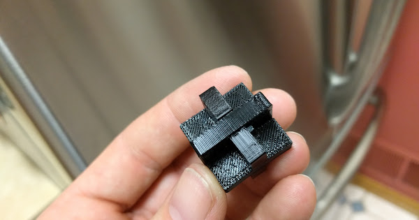

But the printer combined with the Bondtech Mini direct drive extruder is everything I hoped it would be. I started right off with Flexible filament. I have never been able to print it before since my HercuLien and Eustathios Spider V2 designs have such long Bowden tubes.
The calibration cube (first print in the linked album) turned out great. I tweaked a few settings and printed a cube puzzle to create some retraction because there are 3 pieces. Then I printed a Dinosaur for one of my boys, a phone case for my wife’s phone, and finally a retraction test tonight. The retraction test required I drop my temps to 215C on the hot end and run a 1.6mm retract. I think with a little more tuning I can get a perfect retraction test piece printed.
