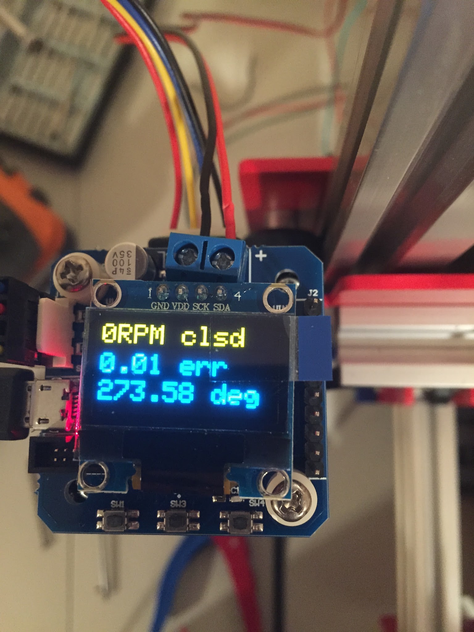

And here’s an improved version of that mechaduino. I have these. http://misfittech.net/
@raykholo I am glad I asked I did not know about the AS5047D. Very cool part and nice control system. The sensor is an on axis magnet and an AS5047 on the back side of the board.
@raykholo You posted; “I don’t know what exactly the internal sensor is. It’s an encoder, might be an optical one.” I was just passing on the answer
We were talking about 2 different things.
The mechaduino/ NZS uses the magnetic encoder, yes.
I was referring to the actual closed loop stepper systems, not these “workaround” upgrade units. The real systems might use an optical encoder I think, but it might be mechanical, something else, etc.
Closing the loop is one thing with various levels of accuracy. It’s just a feedback loop and can be implemented many ways. The servos I have sitting in front of me have both a plastic optical disc and three hall sensors and the controller is a DSP board. On a small micron level machine we have they used Renishaw linear encoders for absolute position.
