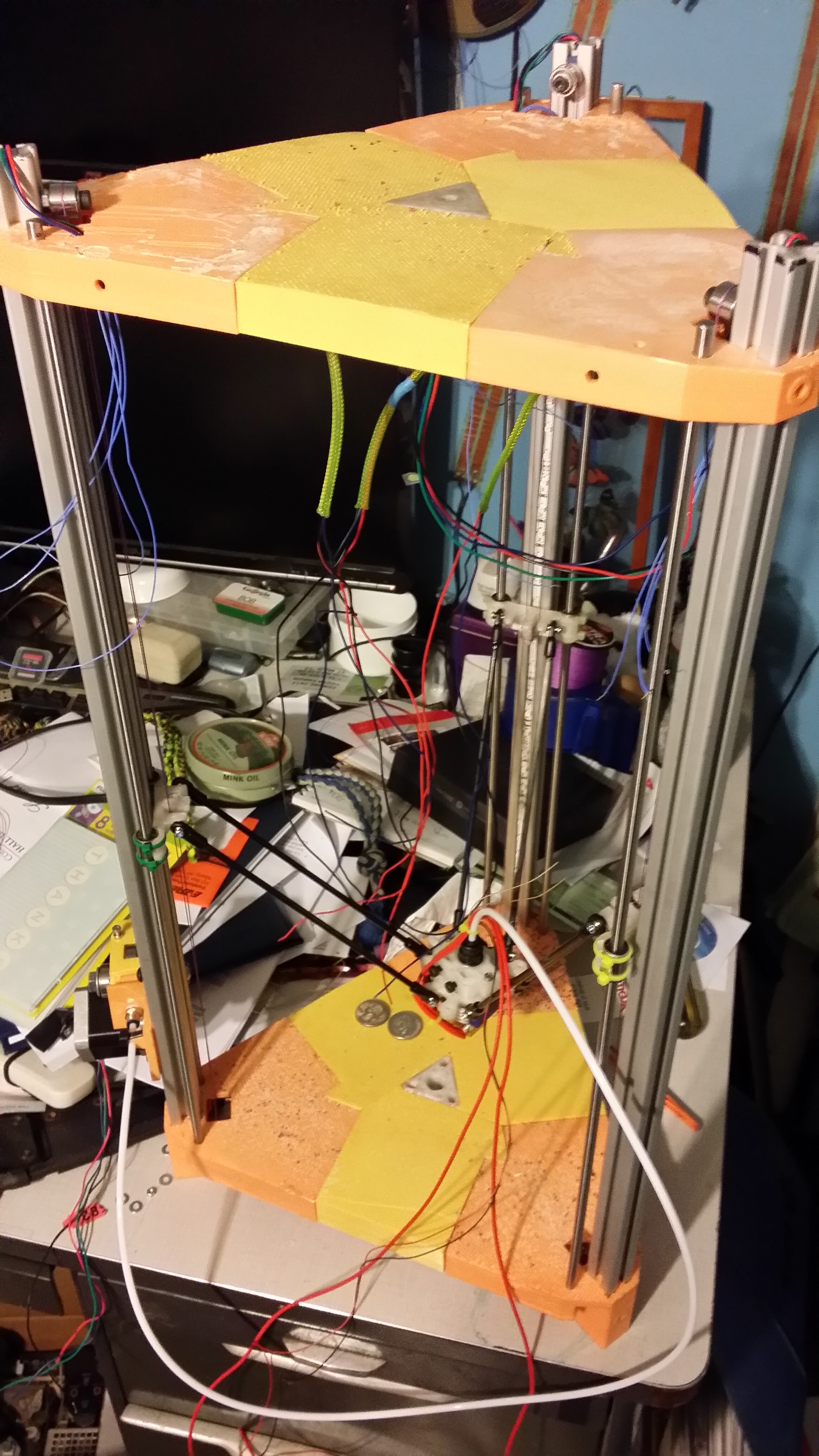

So not quite as far as I wanted to get with it today(too many
So not quite as far as I wanted to get with it today(too many errands). But tomorrow is a new day. It’s all together mechanically I just need to wire up my leds and end stops. Then hopefully I will be posting my first test prints.
Lil info on the richrap @Richard_Horne 3dr I built
Print area apox 10" dia with a height of about 12"
Using a e3d hot end Bowden style @Sanjay_Mortimer soon to be the kraken
Electronics are rumba with a 24v silicone heated bed.
I’m still in the air on a LCD
Can’t wait to get to messing with the firmware!
More to come!
