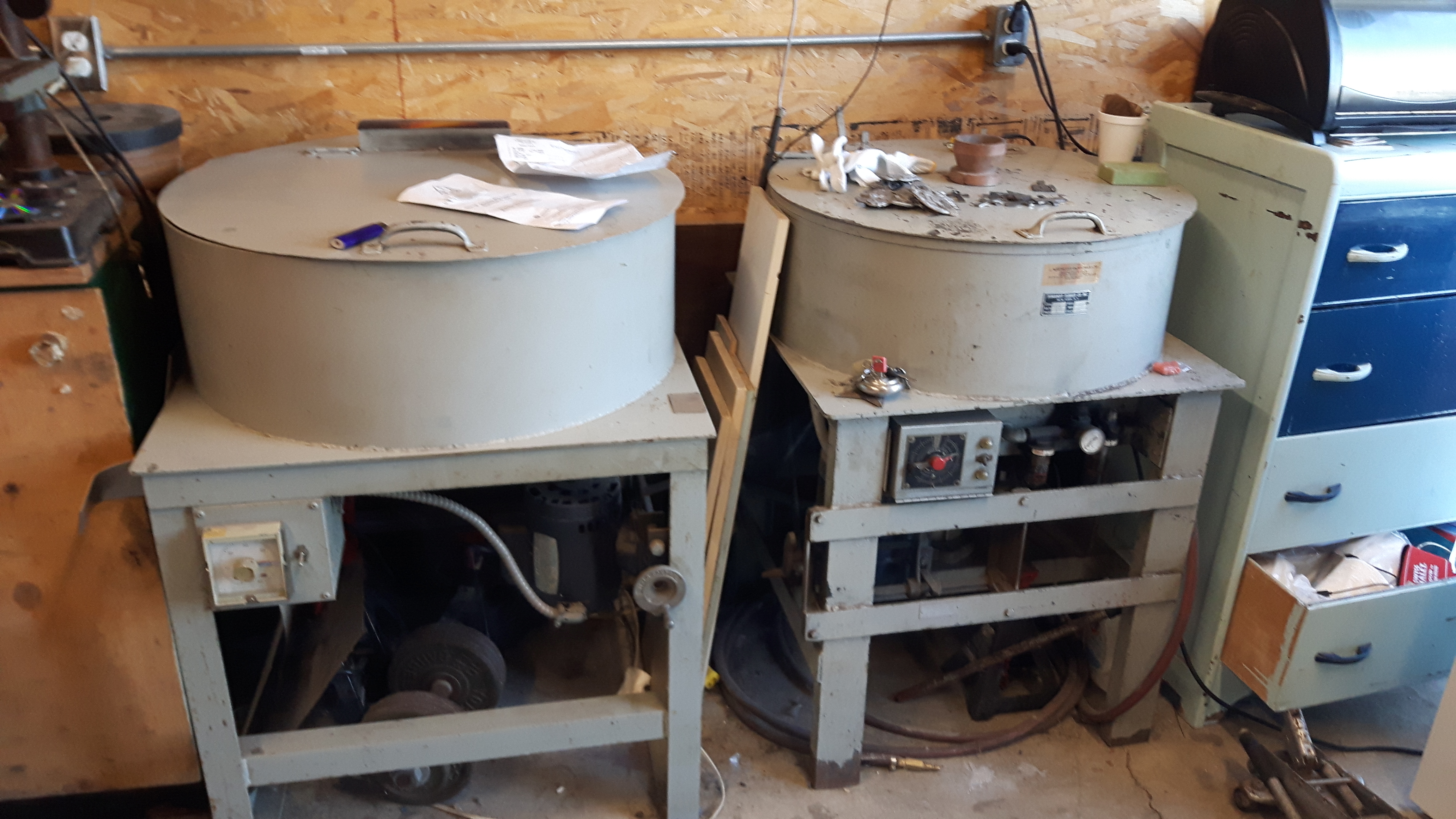

I use a form2 printer from formlabs with castible resin. for my investment caster the flask is 7X4inch and for my spin caster 3x12 inch (low temp metals in this one). layer boundary are not a problem in resin printers (0.025 mm)

The problem with the jewelry equipment I’m using is size. I have to trade going bigger for accuracy. I’m going to still 3d print with the form2 but instead of using investment or rubber with high detail I will use petrobond sand also I may try just cutting a foam positive but I’m worried that may contaminate my sand. I’ll post the results.
