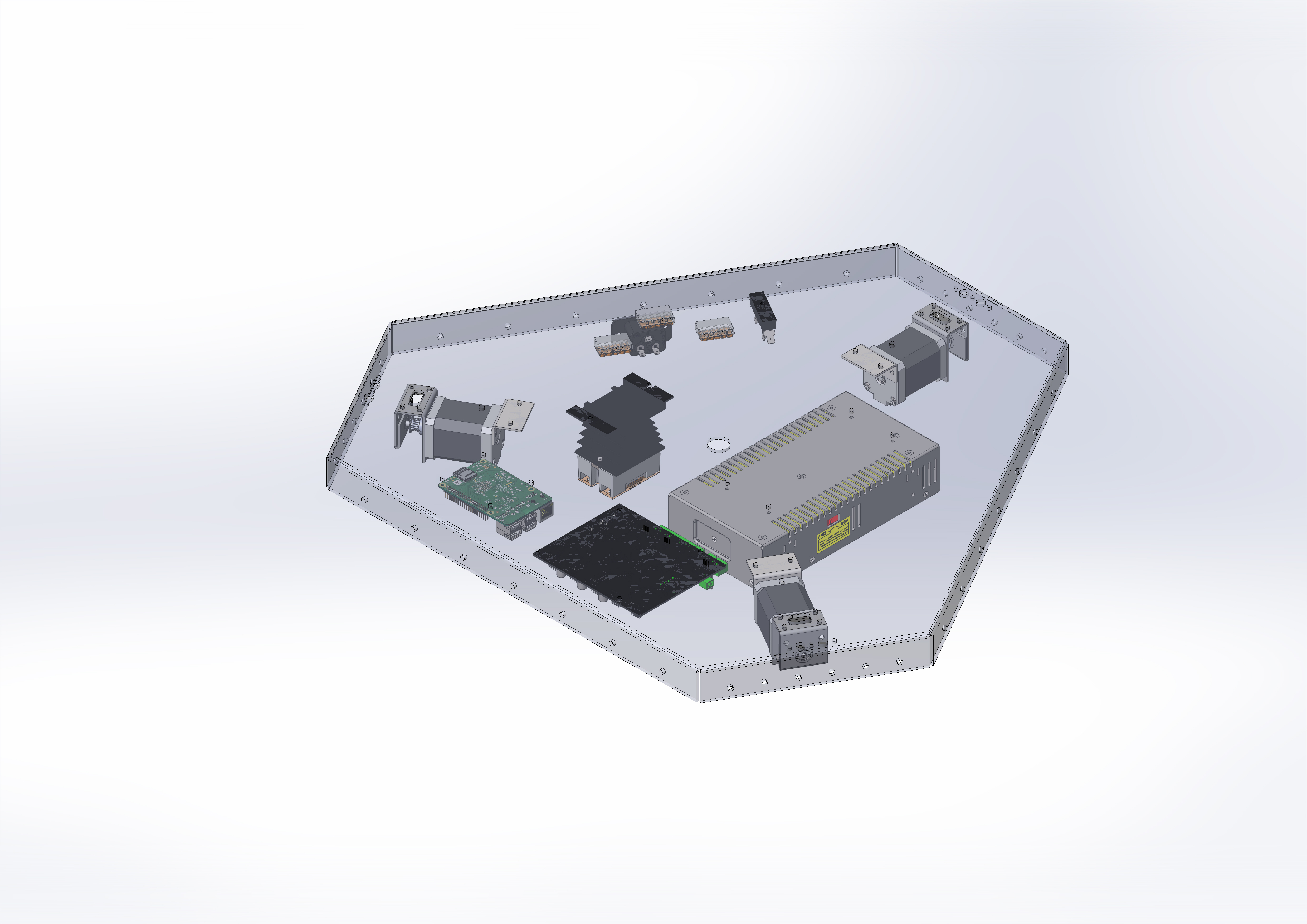

So, please before I send this to the fabricator, any obvious misplacing of parts or parts missing in my lover end that I need to account for?
24V power
25 Amp SSR 240V
Smoothie-board 5X
Raspberry Pi 3
Power-socket
Fuse holder for L
Wago clamp/distribuerer
Nema 17 long
Not in the picture
Ø420 mm alu toolplate printbed
Ø400 600W 240V silicon heater
Thermal fuse for the heater
Maybe a step-down converter for the 5V to the electronic, or just an 5V charger??
Seperated 5V power for Pi and relay module to switch 24V PSU on and off.
Also IEC socket with fuse and switch would be nice.
Which hole do you going to route endstop, thermistor and heater anyway?
Terje_Moe
(Terje Moe)
November 10, 2016, 5:26pm
3
IEC socket with fuse and switch I have mixed experience with, so I think I this time will go for a plain 16 amp socket and no switch and fuse, that’s why I have separate fuseholder.
My endstop wires will go up through the inside of the aluminium extrusion, and thermistor and heater wires will go through the hole in the middle.

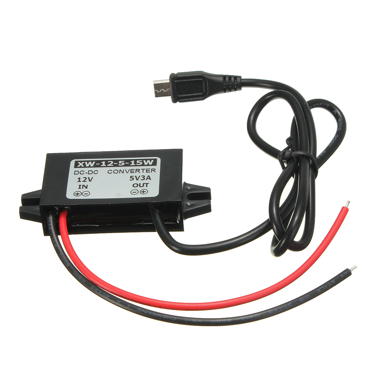

Any experience with this one to power the Raspberry PI 3 and one for the Smoothieboard 5x?
Never use that one but with 15W should be enough if quality is good.
I still use mobilephone charger on mine.
