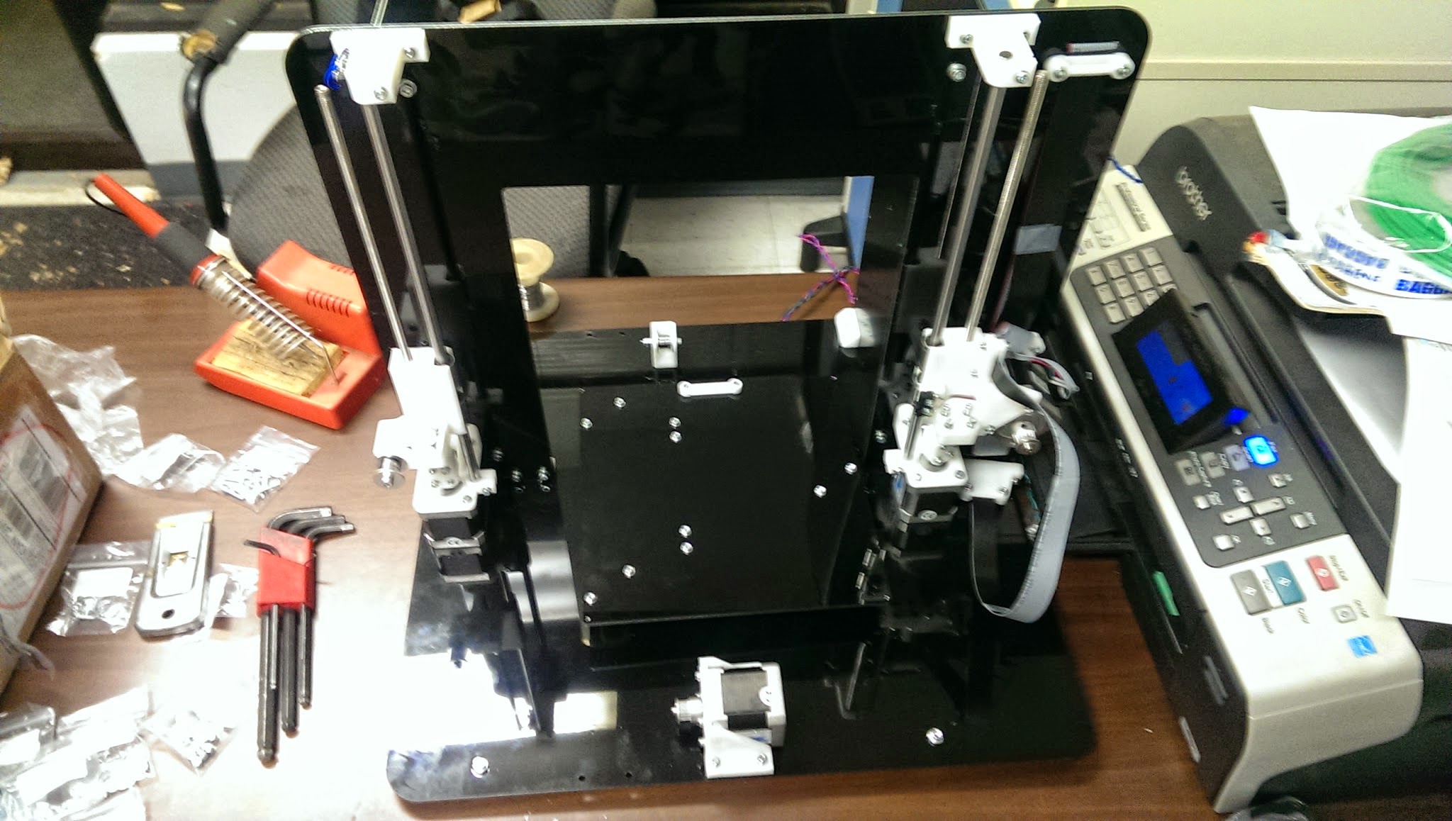

so roughly 5 hours in and this is what I have to show for it. Sorry for the poor picture. It was taken at 2am this morning!

Look at that 2D printer, glaring at its 3D counterpart jealously…

I come from a machining background, so I was concerned a bit, but then I realize that it is basically a 3D positioning machine that lays filament, so it doesn’t need to be as rigid as a mill.

They came in the kit from @nop_head already cut and drilled. I haven’t tried to source it myself so I can’t answer the sourcing part.

This is from a kit. You could source it yourself from a bom provided on the Mendel90 wiki from the reprap site. This kit from @nop_head is £499 plus shipping.

Finished all the mechanical assembly EARLY this morning. PSU and wiring tonight maybe!
