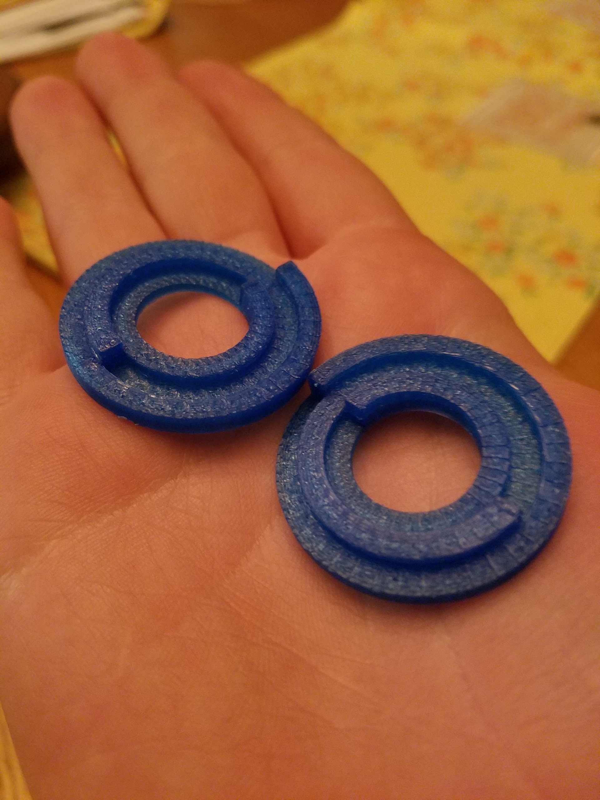

So someone had mentioned the idea of easier swappable hotends. I spent a little bit of time thinking about a completely 3d printable hotend mount and this is what I came up with. This is just the mechanism that would hold the hotend to the extruder. The biggest problem with this design though is keeping the tolerances tight enough so there is no play. Therefore I am considering this design a failure. Magnets are definitely IMO the best solution for this problem. But I’m curious, does anyone else have a better idea?

Look for quadlock, there are some designs on thingiverse available. Take it as an inspiration for geometry, it is patented.

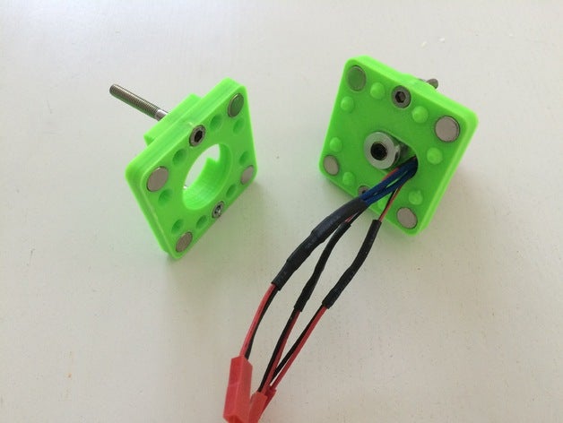

What if you were to embed a small strong magnet into the stop-ends of each of the three tracks?
