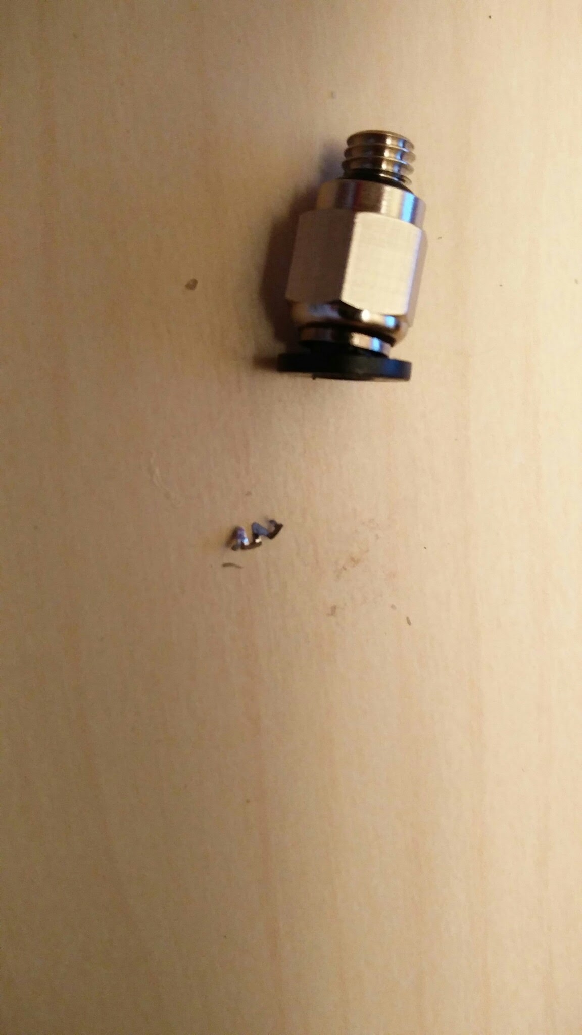

@Fred_U thanks for that, it does move up but isn’t locking the tube at all. I can slide it right out. I have just noticed a small piece of metal clip has come out of the clip. So i’m guessing its broken in some way, now I just need to find out where i can get a new one.
The fittings are not particularly difficult to find, if you can properly identify the one you have. Measure the outside diameter of the bowden tube, it’s going to be either 3 mm or 4 mm most likely. The inside diameter will be 2 mm. Remove the fitting with a wrench or a hammer and chisel and measure the diameter of the threaded portion. My ptc fittings are M5, but M4 is also available.

Finding the right connector might be hard. While it is easier to get the inner diameter right, the outer diameter at the threads is hard to find a match for. At least that was my problem. Do not be surprised if you have to enlarge your hole or do something to make it fit snuggly where it is supposed to screw in. The push fit connectors are a bit delicate for my tastes. Get a 10 count if you find them cheap. Also, if you broke that connection in the firat place, you had too much resistance and too much stepper current. The current should be low enough to cluck and skip as opposed to breaking your push fit connector. Try some cold pulls and nozzle clearing for the resistance issue.
