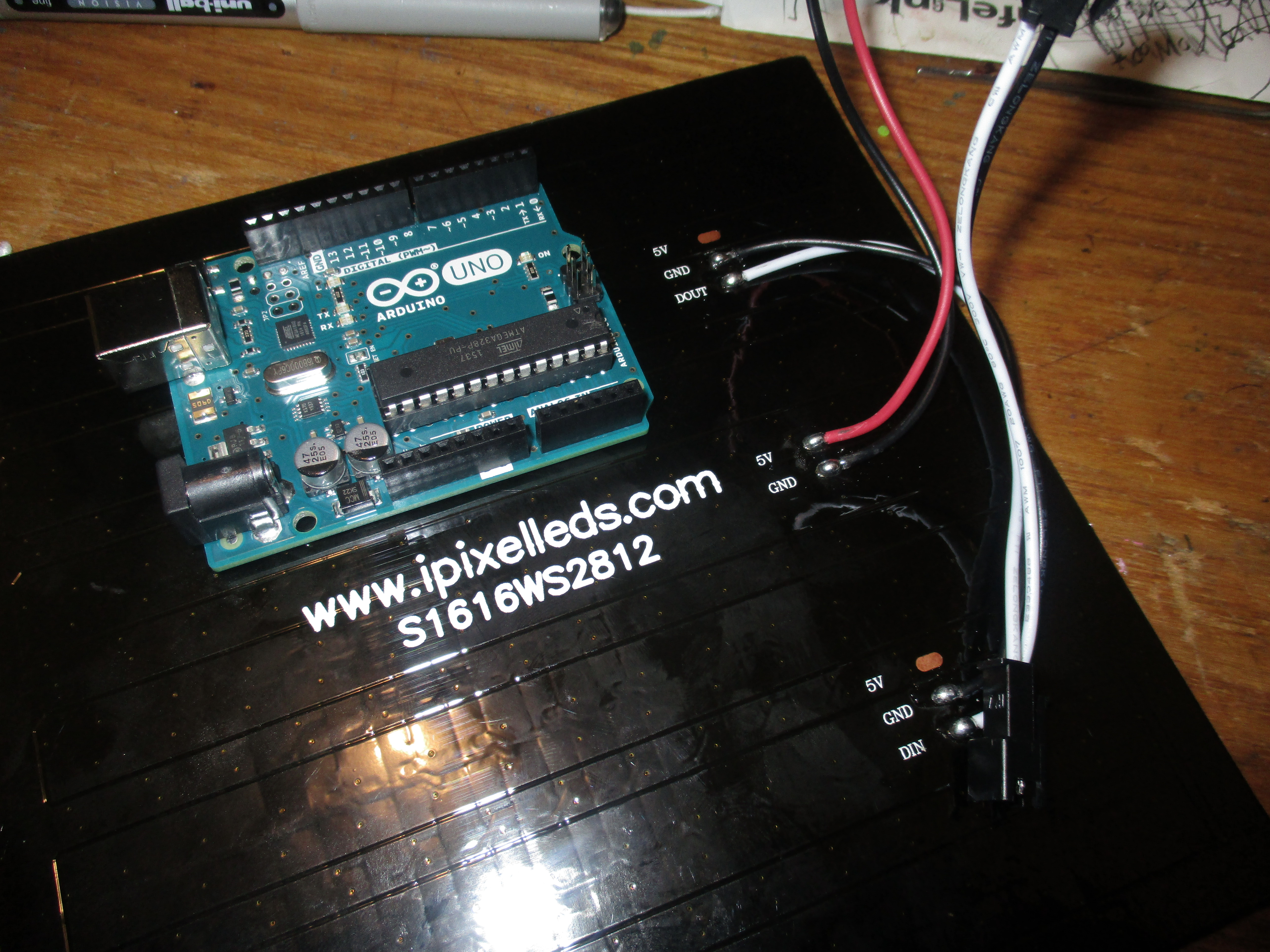

So the Neopixel rgb led matrix came in today with the arduino uno r3
So the Neopixel rgb led matrix came in today with the arduino uno r3 where do i start where do i hook this up to the arduino to make images scroll text messages?

@Jeremy_Spencer Btw the two wires i need to put in the adruino wont fit in? do i need to buy some kinda of connection TO MAKE THEM FIT ILL MAKE A VIDEO WHEN I GET BACK
@hector_jimenez hey mate, I think you should post as much details as possible if you want any help from the public here. Don’t take this the wrong way, but the last few posts you have made on this board sound very “troll” like. Also is any of this FASTLED related in any way?
