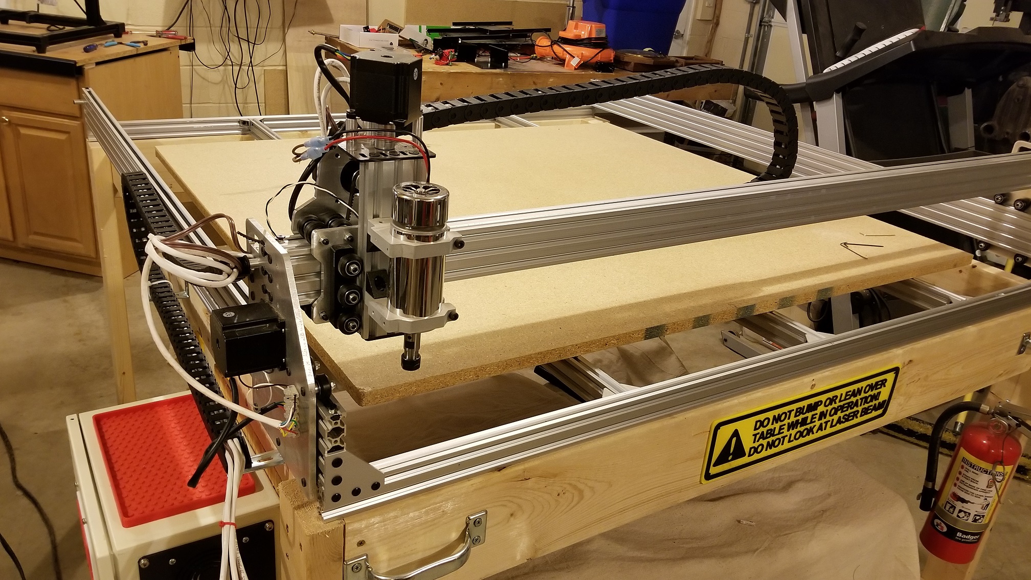

So the physical build is complete and I wanted to share a couple of pictures of it finished. The table is on wheels (like most things in my garage) and can be dropped down and leveled as required.
I am running into another issue:
When I home the machine (in GRBL Panel), the Z gantry moves up and down (about an inch in both directions), then the the machine moves along the X axis to the right (towards the limit switch), but the Y axis moves to the front (not to the rear, towards the limit switch).
When I invert the homing command (switching from $3=0 to $3=1), the Z gantry cycles all the way down and the lead screw starts to grind against its limits, while the machine continues to move to the left (along the X) and forward (on the Y axis, like before). I usually slap the E-stop at this point to not damage the Z motor or lead screw.
I am sure I am missing something and would love some advice.

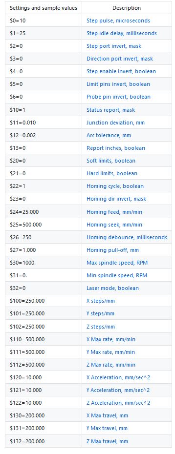

$3 is not the homing invert command. It is $23. It is arranged as a binary number, 00000ZYX. If the Z bit is zero, it homes in one direction, if it is one, it homes in the other direction. You want Z going up during a homing cycle, your Z axis switch should get activated near the top of it’s travel. If it doesn’t hit the switch, it will crash against the end stop.

$3 is the direction bits for machine motion, they must be set so X+ is right, X- is left, Y+ is back, Y- is forward, Z+ is up, Z- is down. You don’t use these bits to set direction for homing, you use $23.

If you press the Home button, and the Y Axis moves to the front, when you want it to home positive, (towards the back) reversing the axis travel (Dir Port Invert Mask $3) is definitely NOT the way to fix it. Reversing the Homing Direction Invert Mask bit ($23) is. It works exactly like $3, in terms of one bit per axis.

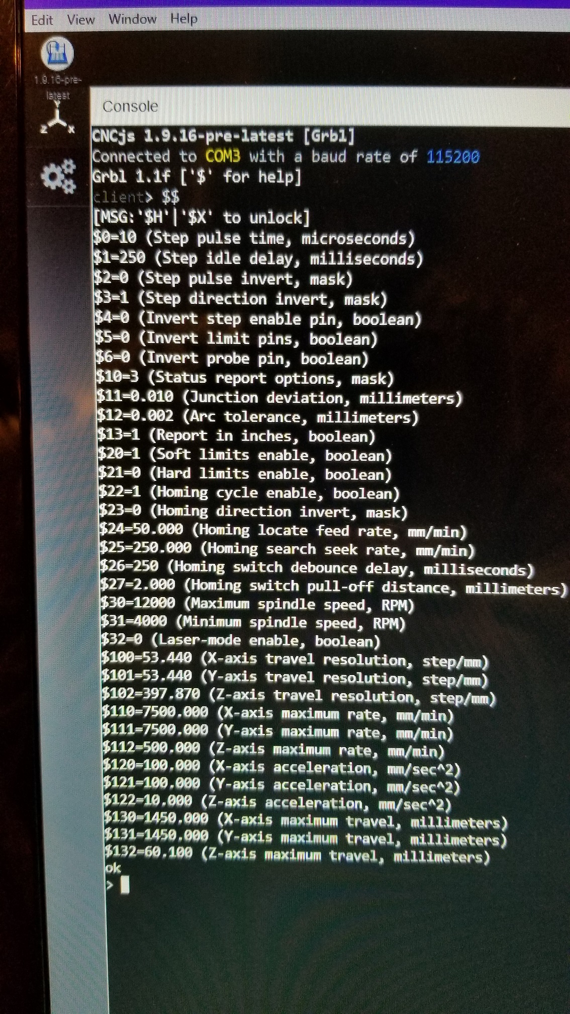

Unless I am missing something(s) in the responses so far, it appears some how I have a wrong settings/values in the GRBL code.
I will fire up the CNC tonight and get a screen grab of the present settings and share them here.

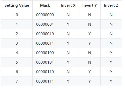

So your current setting is $3=1
Looking at the chart, also posted by @Jack_Daugherty above
invert X Yes
Invert Y No
Invert Z No.
If X works right and Z works correctly, following the chart, you need a $3 that is yes, yes, no. Which is $3=3.
