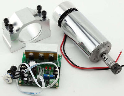

So I listened a little and got a cheap cnc spindle from Ebay. Not sure if it will be powerful enough or not but I don’t plan on giving it heavy chip loads anyway. It was cheaper than buying a cnc router and judging by all the videos I saw online sounds way quieter than one too. This isn’t the exact one I bought but they are all roughly the same looking.
It’s just 400W btw
@Will_Dent yeah that is one of the low power air cooled spindles. I have the black one like that. Purportedly 500W (though measuring it I never saw it use more than 100W). They work, and they’re quiet. But they don’t quite spin fast enough for running small diameter tools. The ER 11 collet is nice though. It turns out the fractional collet set is more useful than the metric one. I was hoping the metric collets would fit some fractional shanks sizes. But they really don’t crush down all that much. So I have both sets. I need to get an ER 11 shank that I can put in my mill. So I can use the tooling on that machine too.

@Will_Dent but you are going to miss out on the experience of hearing a router screaming away for an indeterminate length of time. Which can build character. One thing you do need to watch out for is the power supplies of these air cooled routers messing with stepper controls. I’ve seen folks having that problem with them. It didn’t happen to me. The fix seems to be putting filter capacitors across the motor leads. Though some that have the problem claim running a better shielded USB cable helped them out too. It really depends on your machine if you get hit by it, or not. It seems to affect GRBL machines. I run parallel port, which may be why I didn’t have it happen? I watched a video where one guy had it real bad. I mean his machine was done when he flipped the spindle on. But he’s the one that figured out the filter caps, and that cleared it right up for him. To me the better shielded cable is more of a band-aid fix. As the noise is still being emitted.
Alright thats another good note I’m sure I can find a suitable Cap in my assorted parts and yes my neighborhood will miss out on the joy of a screeming router.
