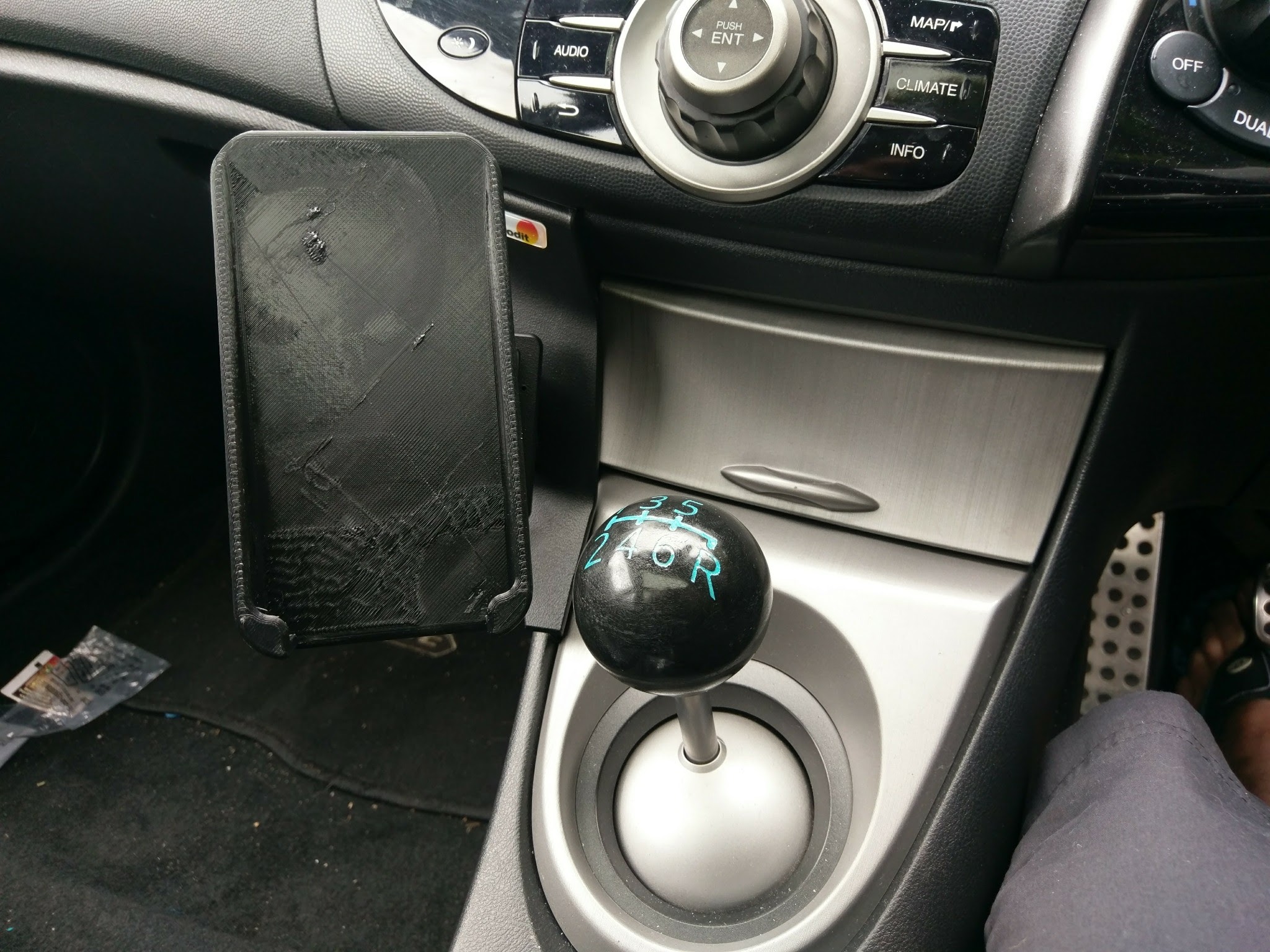

So the upper one isn’t sanded. Seems to work very well. sand wet and everything ist good to go. Just a little more to get a nice and smooth surface.

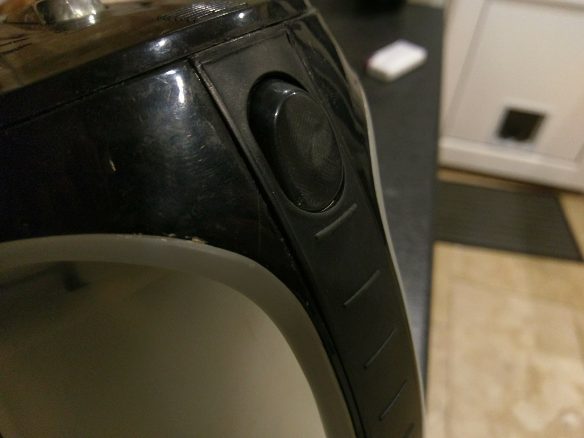

If you go up the grades you can get a mirror finish. The button to release the lid on my kettle broke so I printed a new one.
I used the auto glym head light restoration kit to do it.

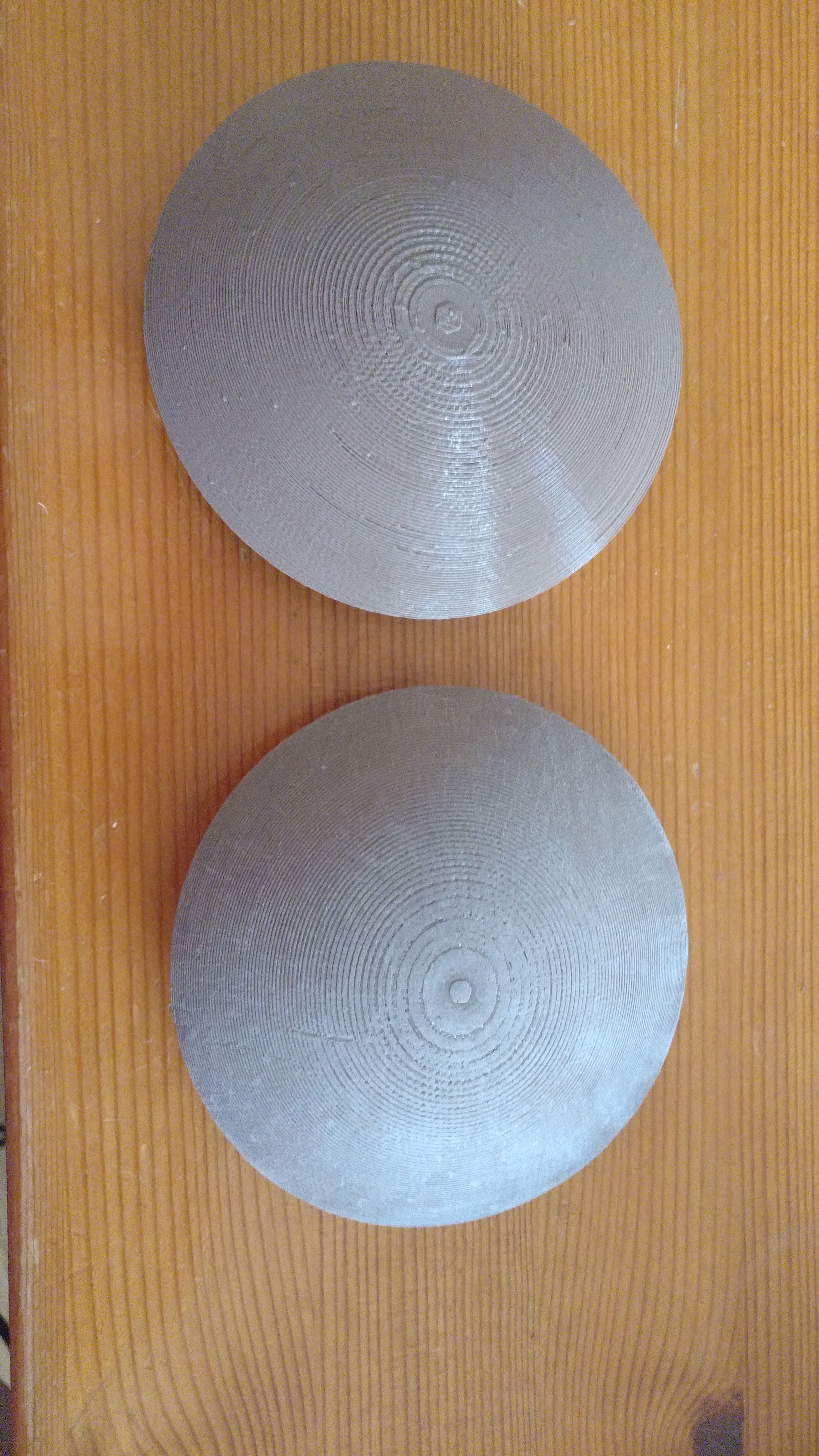

What layer height are you using? .3/.2/.1mm?
Thats .2 mm. Although I would Like to print with .1mm to reduce the needed time for sanding. But the caveat is as always the increase of printing time.
I printed these last week (I know my retraction is off) the one closer was .3 mm and the further one was.2. I did have them side by side but then the picture looked rated-R. missing/deleted image from Google+
I think the .2 one has better details though. When I would try to sand the .3 one it would probably become a low-poly saucer.
Spray primer helps a lot to fill the cracks and minimize sanding. Sand, spray, sand, repeat until smith.
