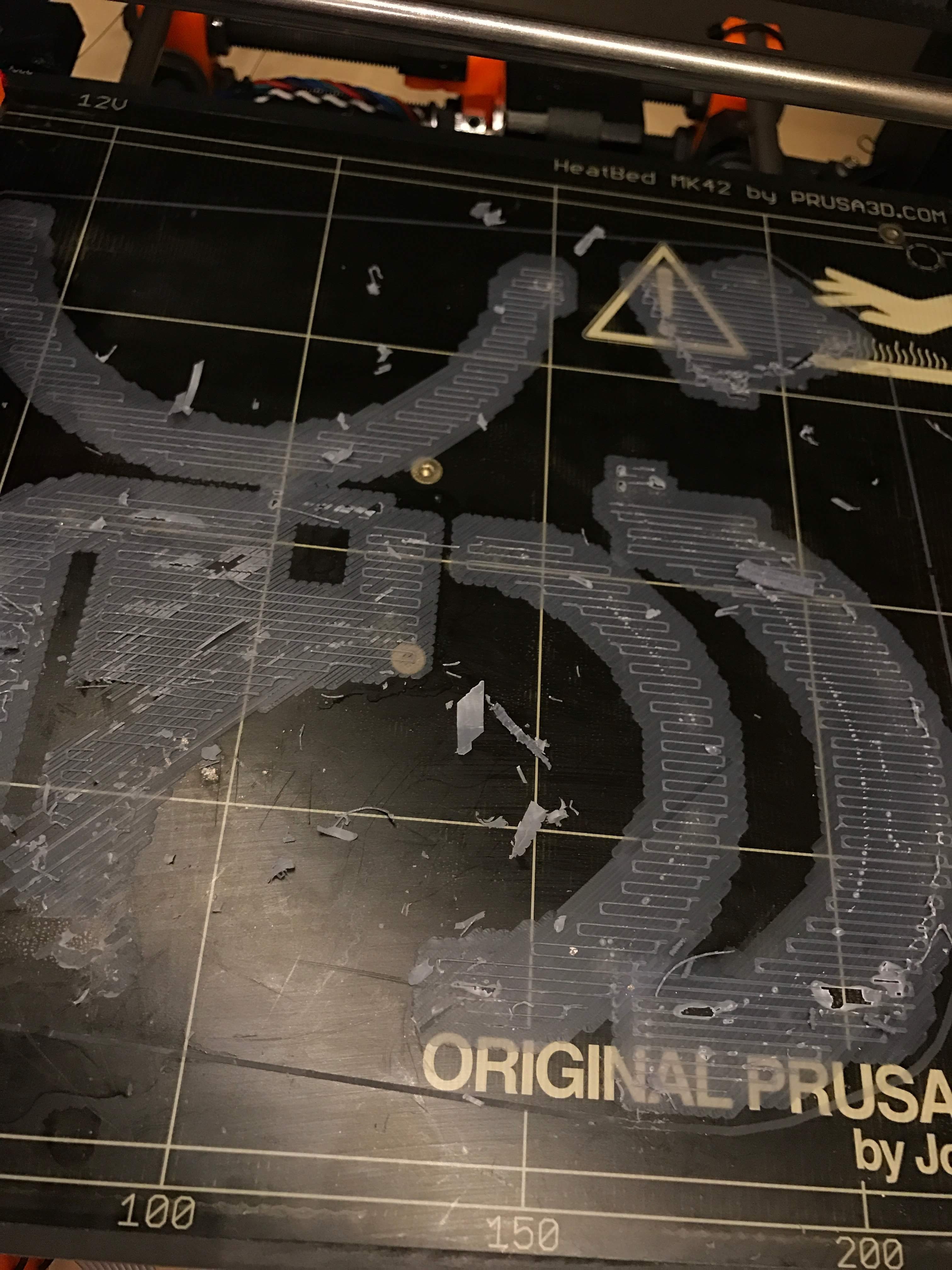

So…There’s gotta be a better, safer, way to get the ABS off my PEI sheet. I’ve tried alcohol, and a little bit of acetone…I’m I going to need to pull the printbed and do something drastic?
I’ve never had ABS adhere quite so well to anything, and I really don’t want to destroy the PEI sheet in getting it off.
In case of something will go wrong: Replacing the PEI sheet: http://manual.prusa3d.com/Guide/Replacing+the+PEI+sheet/133 (I did it twice after flexible and ASA material experiments).
Maybe razor blade and try to pick up the edge to peel the rest of it off.
omg what a pain in the ass to replace the pei sheet. And it might just happen again next time you print abs.
Acetone will dissolve the abs. I use a metal flat razor blade holder to get under edges then work a long thin dull “print knife” under the part. Sometimes, I do scrape some of the pei off, damaging the bed.
Yeah, I’m thinking an order of Limonene and a replacement PEI sheet are in my future. I’ll mess with Acetone, but the reality is: You can’t really soak in it, evaporates too fast.
Your first layer might be a little bit too low. I never had problems with abs sticking too much to pei.
My 2nd tip: Use thin glue layer as on the glass for some materials too adhesive on PEI. It a savior for Flexfill and other flexible materials which stick to PEI too much. (And should help for ASA, so maybe also for ABS.)
Or simply raise your extruder a tiny bit, the first layer dont need to be extremly close to the bed, if you have that kind of adhesion
I had this yesterday. Used repeated & liberal amounts of acetone after it’d cooled down and was able to get it all off. I had to use a paint scraper and a hammer (like a chisel) to get the print off the bed. Mine stuck like that because I used too much ABS juice to adhere the print. Too much warping and lifting if I don’t use it though… PEI & ABS is a fickle combo
