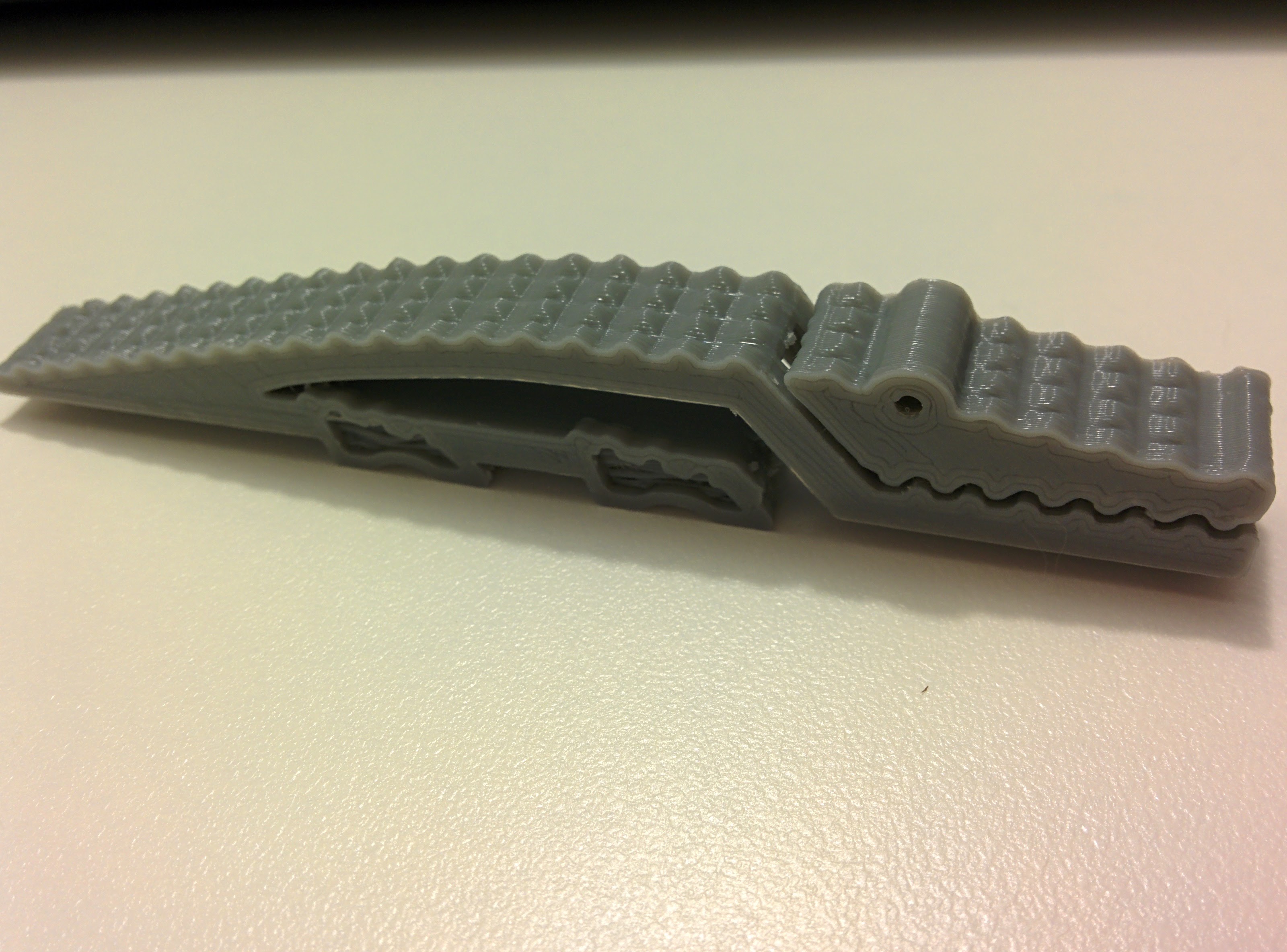

Fantastic prints, though looks like you might be overextruding a bit. Dial it down to improve surface quality.
@Stephanie_A Someone else here mentioned that a few days ago, I’ve since tested the extrusion rate multiple times and its always spot on.
If I mark 100mm on the filament and go G1E100F90 it extrudes exactly 100mm every time. I tried different lengths and it always extrudes the correct amount.
I did get an average of my filament diameter (1.764) and updated Cura, that did seem to improve things.
As for the over extrusion, my next step was going to be adjusting the flow rate in Cura from 100% to maybe 95%? Would that help?
When you calibrate your extruder, do it at the same temperature and speed you intend to print at. A small thing that makes a significant difference.
What specific indicators are you using to say overextrusion?
I haven’t actually calibrated it yet, but the extrusion tests where done at printing temps.
@Josh_Ajima other people told me it might be over extension based on the surface quality of my parts, especially small parts.
The surfaces look great to me as-is.
@Tim_Visible The bottom and side surfaces are fantastic, and the top surface is great on parts with larger top surfaces, but on smaller top surfaces it looks like the nozzle dragged through the material.
It looks pretty good to me. It might be overextruding, but not a terrible lot.
Ah. I was just going by the three photos here.
I’d say extrusion looks fine. Beautiful prints. What PLA are you using?
