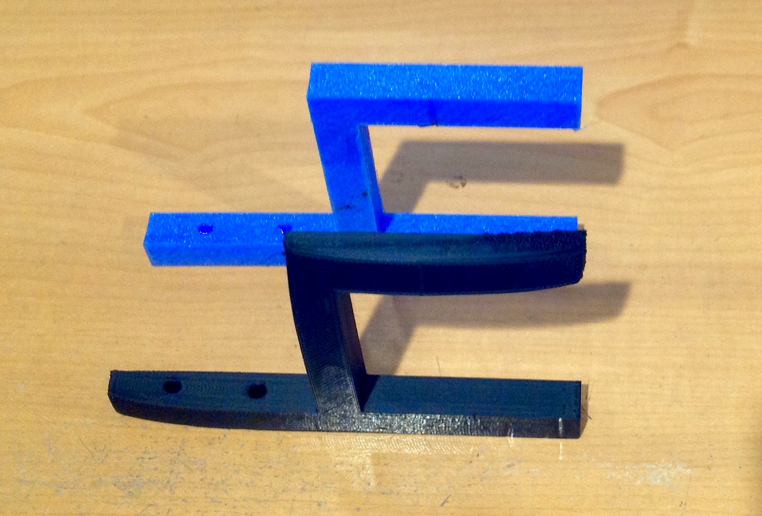

So this is an example of a part that is very difficult to print
So this is an example of a part that is very difficult to print in ABS but @Made_Solid PET+ works really well on. Its a bracket for mounting a network switch under a shelf, the long piece is 100 x 10 x 10 mm the ‘short’ leg is 60 x 10 x 10 mm and the spacing is 46mm. Four brackets mounted under the shelf and the switch can slide in and out easily.
The issue doing it with ABS is warping. A lot of warping. The good news for me was that the Simplify3D app is able to print PET+ reliably on my Replicator 1 Dual.
