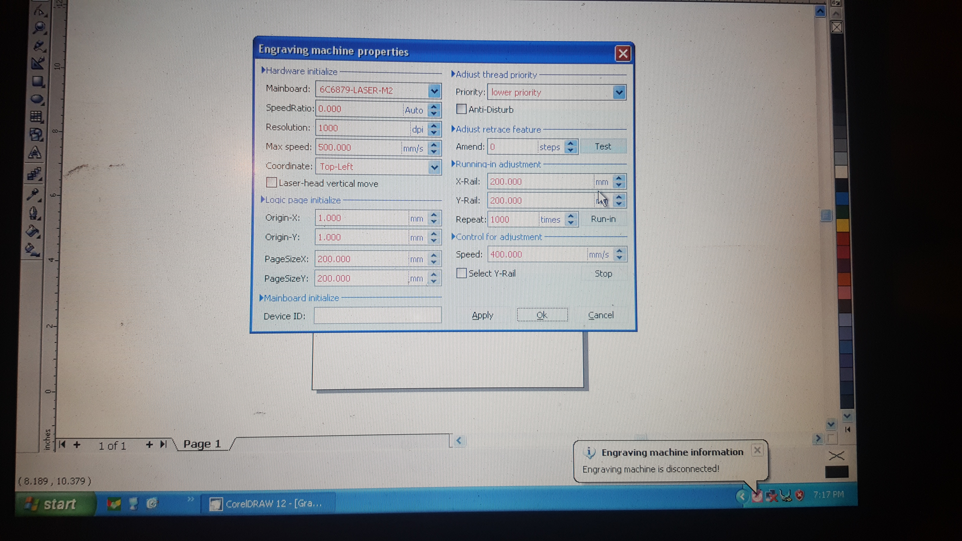

I have installed the provided software multiple times now, CorelDraw 12 and Corel Laser, nothing I do seems to get the laptop to detect the laser. Keeping getting attached balloon pop up.
I have USB dongle attached, updated settings to show M2 which is the model on the mainboard, done quite a bit of online searching and tried the eBay seller for support (not much in english lol)
Anyone got any ideas? Short of Doing some Smoothie conversion or something like that (i’m a bit techy but would need a bit of guidance with some things) so if anyone has any ideas on getting software to work that would be great, or if its best to just fork out more money and do some upgrades, any links would be greatly appreciated!!
Thanks in advance

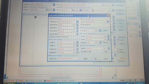

Have you input the serial number that’s on the m2nano board?
I have not. Where does one add this?
Ok cool, will check that out. assuming the serial is the sticker on the right?
https://plus.google.com/photos/116731355213359724450/albums/6342932940943556145/6342932942162737522
Yep
Sweet going to do a fresh install of just CorelDraw and CorelLaser hoping it works now! Thanks @Alex_Krause
So fresh install and added serial and still same balloon. Should I install this other software?? Sorry for all the questions just totally lost with this. Thanks

You’ll need to do the same machine & device info in LaserDrw (machine settings) that you put in Corel. The dialog box will look exactly the same but it stores the info somewhere else. The page size can be modified (without the factory bed the size is something like 220x320) but it’ll work fine with the default settings until you do bigger stuff.

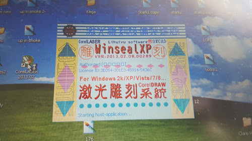

So you set the machine & board info, exited LaserDRW and restarted it? When it fired up should have flashed a screen with “Winseal” and Chinese characters and a changing message that checks the machine and ends by saying something to the effect that the USB key was found and authorized.
Then LaserDRW workspace shows up. Next I’d draw a box and next to it I’d type a line of text. Then do an engrave. You have to hit the “starting” button on the right side of the dialog box to make it go.
Yeah thats whats happened. double checked the msg on winsealxp splash and it said authorized.

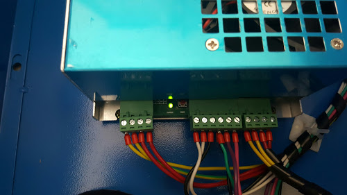

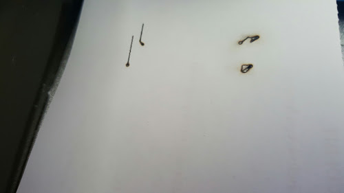

Fans start, test fire works (though i just noticed if i hold it down the laser seems to wonder a bit, as in head moves on its own)… pic of wiring if that helps… will add a video if i can
best i can do is show the burn on some paper…

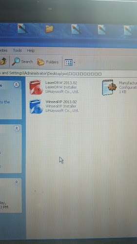

There is a driver file somewhere on the CD… a few others have recently had this issue of it not detecting the laser also… I have a feeling that fixes it
