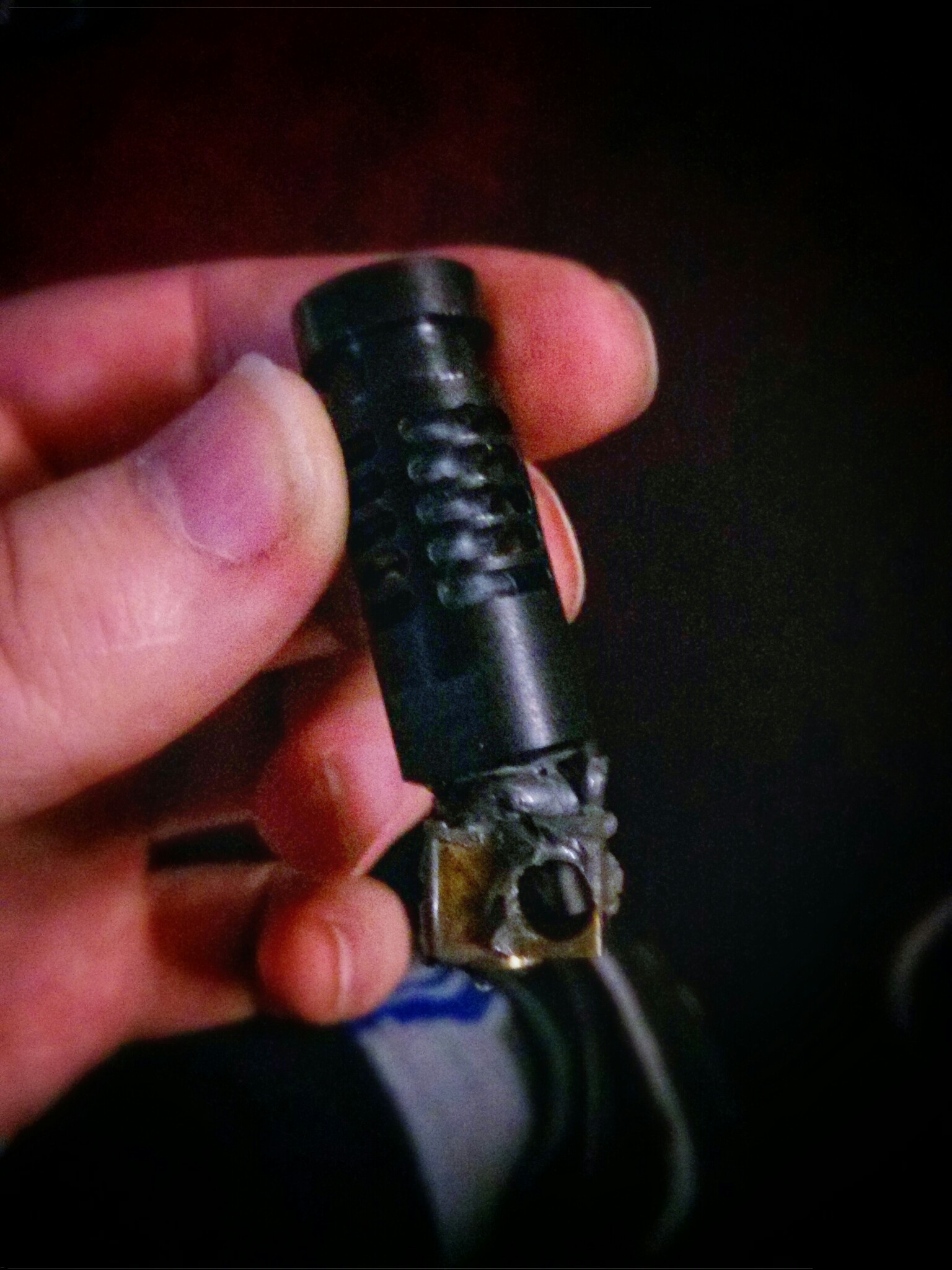

Thermistor came loose, can only blame myself for not quadruple making sure it was properly secured.

Bugger - so, what happened here? I woud have thought the printer would have shut down once the thermistor dropped below 175 degrees (cold extrusion or whatever it’s called).
If it’s close enough to be hot, but not close enough to sense accurately, you’d get the thing heating up like that.

@Jasper_Janssen nailed it. The thermistor slipped loose but was still quite close the hot end.
The PEEK on the inside was all melted as well.
