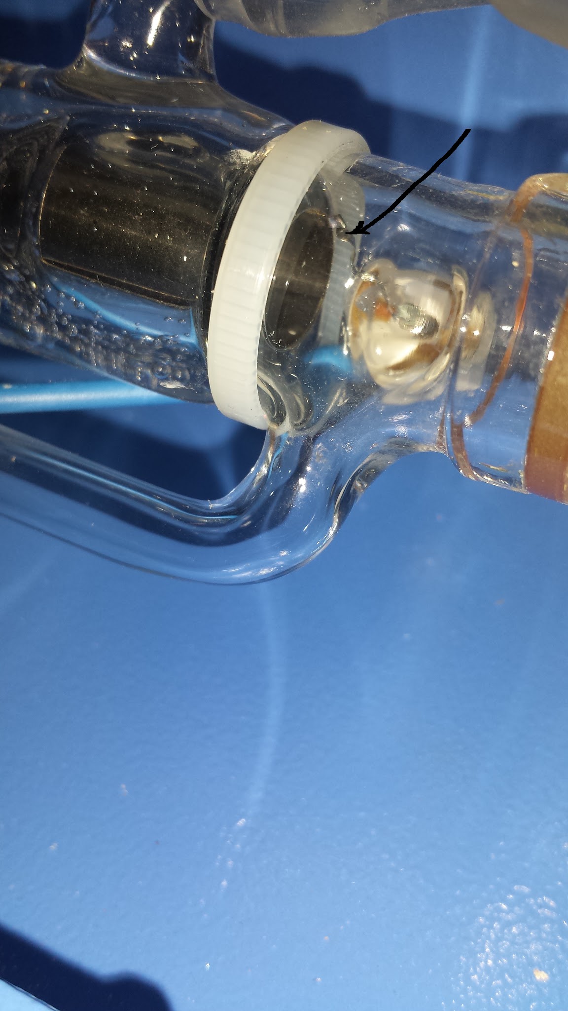

So this is what i found at the end of the tube exit would
So this is what i found at the end of the tube exit would this cause my problems thanks to all for the help
I am unsure what that is, but it does look to be a crack or partial crack. However, as it is on the side of the tube shell, I’d imagine that it isn’t in the beam path. I’d be more inclined to check the orange thing on the right of the image for cracks/dirt/chips (it looks to be a lens). I am going to check my tube to get a better look at what that end looks like. Also, I notice what looks to be air bubbles below the silver thing on the left of the image?
Yeah, it’s definitely a lens at that end. Hard to get a look at it without totally removing mirror 1, but might be possible to hit it with a blast of air (from your compressor/airpump to maybe dislodge any debris that is on it which could be causing the split).
Yes it has air bubbles due to the machine being turned off i used a mirror in front of the tube to check for debree nothing there can’t find any other reason for it not cutting through 3 MM ply i had the machine almost to full power and it would not cut through it, and the beam is split right from the tube what else could it be and a new tube is $160.00
@Dennis_Fuente I’m about as in the dark as you regarding what could be causing it other than some debris. But you mention there is none, so it must be something internal in the tube causing it. I wonder whether you’ve had it for short enough period to get a replacement tube from the seller for free?
Is that a crack or is that debris inside the tube?
you are all wrong it is a thin metal strip going from the terminal to the metal collar.this is normal,and is needed for the tube to work

Hi guys my thanks to all for your response, Phillip what i think is a crack is in front of the metal ring, As to the mirrors they are brand new light objects i used latex gloves to install them they are bright and shinny, last night before i gave up on it for the day i heard an electrical snap somewhere i will have to give that a look today just so many thing’s going on at the same time with this thing trying to sort it out it’s a pain
@Yuusuf_Sallahuddin_Y …it only let’s a percentage of the actually power the tube creates escape.
Niice photoo,if you zoom in you can clearlg see it is not a crack ,it is thin metal ,an electrical connector from yhe terminal to the metal collour,send this photo to a tube seller and ask them about it

I did just that i sent it to the manufacure and i am waiting their reply but for today i took the laser tube out of the machine completly for a close up inspection this is what i found the connections from the PSU to the tube are a joke i removed and cleaned them throughly the next step gave me the reason the manufacture is using silicone to glue the wires on nothing will stick to the tube termanials i don’t know what the material is but it will not accept soldier, silver soldier i can’t get it to hot as it may fracture the glass so i used a soldiering iron no luck so i soldiered best possible.
Next step was to align the tube and mirrors spent the day doing this moved the tube forward aft moved the mirrors up down shimmed everything best i feel i could get it and the beam is still split, i did see in the rear of the tube once i had it out the back ring connector was off center and titlted to one side i still think it’s the tube that is the problem.
