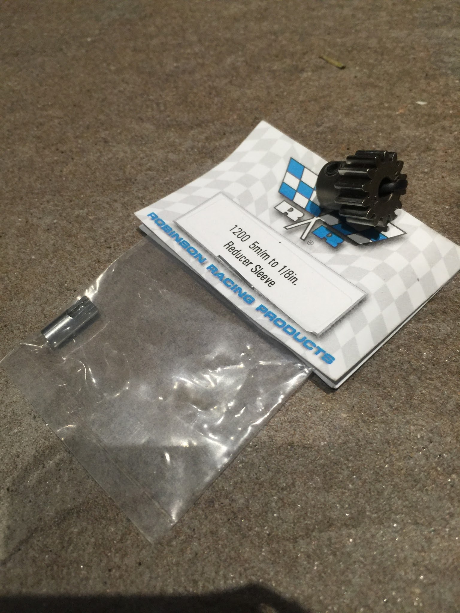

Even though it was wet (and the car kicked up impressive rooster tails through puddles) the new smooth back end and the aero kicking in (whee) let me be confident enough to open it up a little more than I have before and I finally explored the area above 50% throttle. To show you how much grip the tires and aero give, on one high speed run I opened up the throttle to about 75% - 80% percent on the neu-castle 1410 3800kv 4 pole motor - and discovered the next physical torque limit on plastic cars, I shredded the teeth on the spur gear (see attached photo) even though it was running on wet pavement in the rain. With a stripped pinion gear, the motor sounded quite fun free running (attached video).
So now there are two paths to going faster. Either determine just how much torque one can put on the teeth of the 100% infill plastic pinion, and fiddle with the torque limit curves on the motor controller to dial it back to an acceptable non-gear shredding level or… Option two is to use this nifty little combo my buddy Seb at Seb’s RC Shop cooked up for me when I asked him about it in the third attached photo, and then find out just how much torque the plastic spur gear can take… :slight_smile:
Addendum: So that metal 14 tooth gear is essentially the same as the stock plastic one. BTW just did the math, this works out to a 160 (159.7 but gimme the .3 because I used 12v for the nominal battery voltage) Kph real world theoretical top speed (53mm diameter tires, 3800kV motor on 3s pack, 40:14 gear ratio). I’ve only probably had it up to 50-60 Kph now. It is fast enough to chase real world cars down residential streets. :slight_smile: Wonder if it can get anywhere near that theoretical top speed without a fancy aero underbody like Traxxas used for their high speed car…
