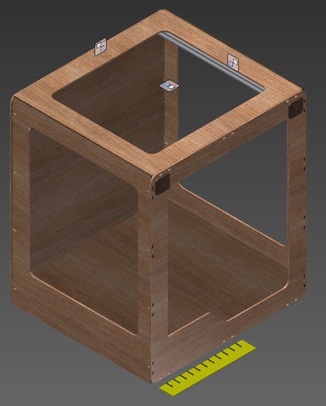

So today i started designing my first home built bot. I’m making it in classic MakerBot styling, but with CoreXY tool path control and a bigger build plate. I’m just starting on the mechanical side. I have not decided on my electronics yet, but I have a whole ramps 1.4 setup already at the house. Check it out! (Ruler in the picture is 12 inches). I’m planning to make it open source!
What are you designing this in? Will it be open source?
Im making this in Autodesk Inventor because thats what im trained in. Im also using autocad to get ideas out of my head really quickly. I do plan on releasing this printer open source. I will probably upload it to Thingiverse simply because thats where most people are. If they will let me, I will try to put it on MMF as well, but it isnt 3D printable so im not sure if that will work.
I mean as long as the files are available, it should be fine. May I suggest isn’t GitHub to host and keep up with changes?
Ill look into it. Ive never hosted anything on GitHub before. Also, this is my first printer to design. Ive been printing for several years. Im going to try to put some of the best features in it. Im also going to try to use standard, easy to get parts as much as possible (minus the aluminum extrusions and laser cut parts). For instance, the bed will be removable glass, and I am going to try to design it to take a standard, uncut piece that you can find at most hardware stores.
Cool. What wood thickness are you using? Is the wood structural?
Im using 5MM because i can get it at home depot. as of right now, it is structural, but i have been toying with the idea of having a full aluminum frame under the wood. If i do go with a mightyboard based design, will BotQueue be able to run a sailfish bot? Last time i checked it wouldn’t.
Octoprint has a gpx plugin for running a mightyboard. What’s your plan for the z stage on hbp that size?
Im probably looking at something to this effect http://www.aliexpress.com/item/Round-Silicone-Heater-Bed-300mm-3M-Adhesive/1819978086.html but im not %100 sure. I have to go to the hardware store soon and figure out what size glass im going to use, then I can see how big of a heater I need. As far as the z stage, im not sure. It will be pretty massive. I dont want to have ball screws on all 4 bed corners, but i think a typical Makerbot/Ultimaker style wont be strong enough.

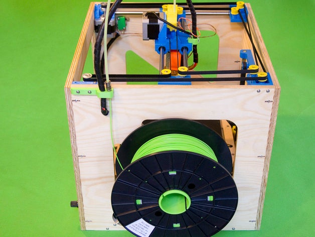

Thats pretty cool @Jan_de_Jager . Was there something specific you wanted me to see there?
@Wes_Makes_Stuff Yes, sorry. Its a good guise for the corexy mechanics, and this design can be sized quite well. I have mine built half way.
Nice! Ill definitely take a look at it for reference. Since Ive been printing for several years, the designing and building is the fun part, so don’t necessarily want to just scale up someone Else’s design. But reference is always good. Ive got to do some more research on how the actual coreXY works.
@Wes_Makes_Stuff here is a good resource http://corexy.com/
what diameter linear rods do you plan to use?
I was planning on using all 20mmx20mm v-slot aluminum extrusion. No linear rods because of the sag in the middle.
