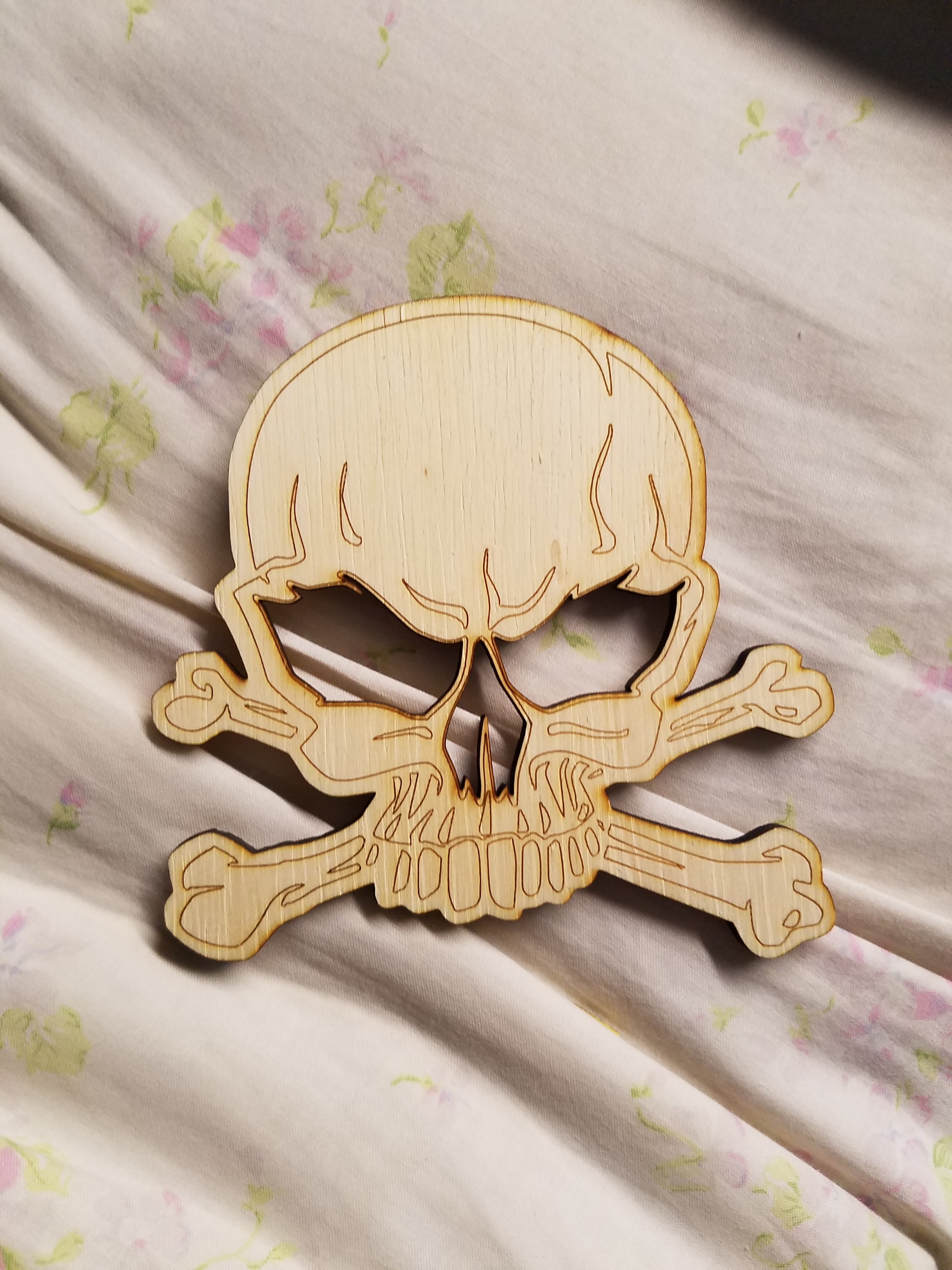

So when I download svg’s for laser cutting, a lot are setup with multi colored lines for cutting/engraving. Is there a way to use them as is in laserweb? Does it know the difference? Screen capture for a picture says a 1000 words.

Thank you @funinthefalls However, I was referring to downloadable content that is pre setup for some laser cutters based on color selection.
You can still seperate the file yourself, just select all the objects of one color, copy, and paste into a new file. Using the skull as an example, open it in Inkscape, select all the blue lines, choose copy, then paste them into a blank svg file and save it as blue.svg. Then repeat with the red and so on.
